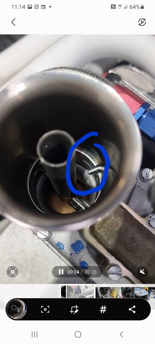

I have new Spanish weber 48 IDA fitted to my 351windsor. They were tuned by a weber approved tuner and covered 0 miles since, just some starts ups.
I've had some fuel leaks due to needle valves but my supplier supplied me a set of new ones and hopefully that's cured.
With IVA now booked we let car do a few engine up to temps and fans kicking in just to check for leaks in all areas.
On the last check we noticed lots of fuel on the inlet manifold leaking from 3 carburettors after the engine was shut down, dripping pouring from the accelerator pump jet which it never has before.
Cleaned up and restarted and they continued to pour on idle.
Fuel pressure was 3psi which I've now lowered to 2 psi.
I let the car cool a bit and retried at at 2 PSI fuel pressure and all seems to be ok.
I'm worried about a reoccurrence when on its IVA test and obviously the fire risk.
Can anyone advise me on what can cause this?

Incorrect float height.
You'll need special measuring tools to set float height correct on a 48IDA.
The 48 IDA is very sentive for incorrect float height as it affects fuel mixture also.

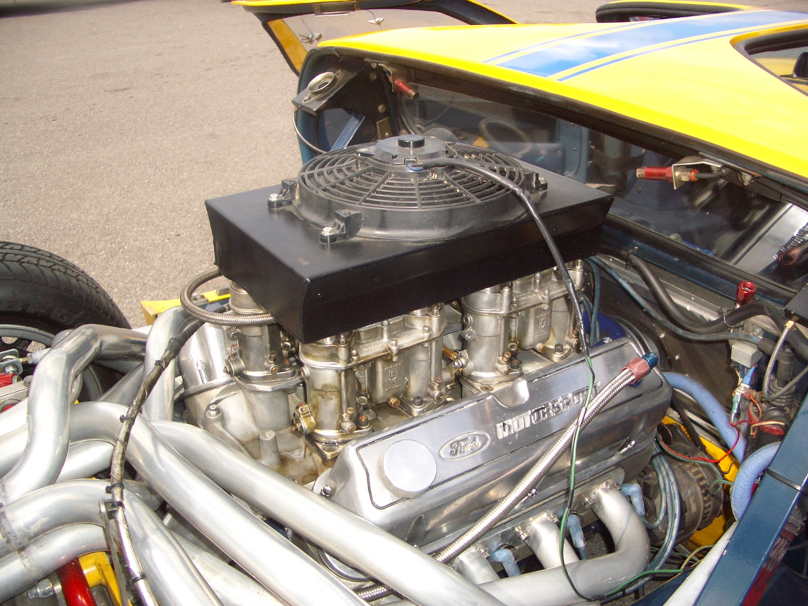

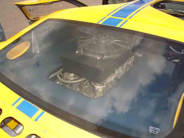

Following Ians comment, which I agree, is another of my crazy ideas for heat soak after a hot run on track. For a competition car running Webers, I have a drop on cover with a extractor fan, which pulls off all of the hot air from the top of the engine and cools the carbs entirely. Works great, and of course you can tell all of the other competitors its a ram air system foe enhanced performance, I nearly got lynched in the first time we said that , and scrutineers came and had a close look, then laugh , when they saw the real result.

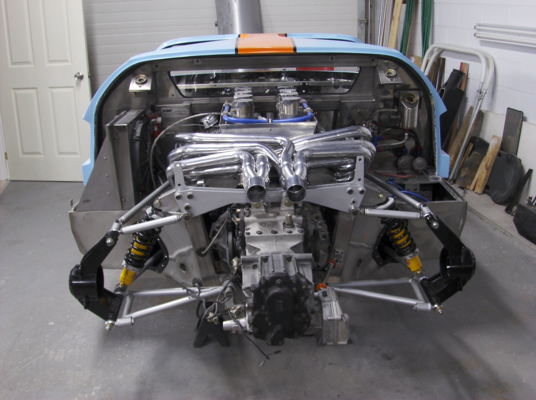

Hi Frank, I always thought that ingenious not crazy:) A heat shield around the carburetors as used on the original racecars is also recommended along with insulating spacers. A lot of heat radiates from the headers, beneficial whether stationary or driving. Looks cool too...
