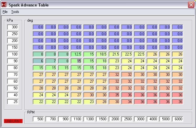

Here is a translated ignition advance table for a 5.0L HO extracted from a factory computer.

Jack Houpe
Randy, I think at issue is the effect of ethanol fuels and the impact their burn rate has on timing. That's the basis of my engine builder's recommendation to go to 36o. I've not had any engine ping or other danger signs since I made the adjustment.
Haltech has a ethanol percentage detector which will change values on the AFR table based on the amount of ethanol detected, not sure but it may do timing also. I know that ethanol has a higher octane rating so it would make sense to increase timing dependent on % of ethanol. With ethanol additive in most of our fuels we might as well take advantage of it. I wish there was a gauge that could measure percentage. I think the FLEX fuel cars use some system like this, again a gauge on the dash would be nice.
