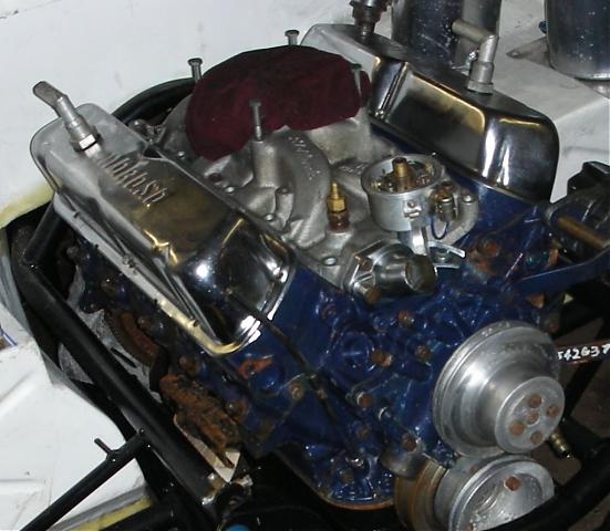

I had a look at a car for the HSCC GT series today, which was reportedly powered by a period 289 in classic historic trim and I was informed it had 1 & 7/8th inlet valves and solid lifters and was run with a 650 cfm DP Holley.

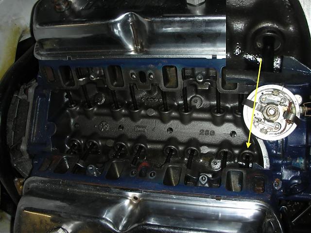

I was unable to locate an engine number and also to me, from the pics below, it seems to have hydraulic lifters fitted. It was reportedly good for 7K and made max power at 6500rpm, although they said they only ran it to 5500 and reported running oil pressure was 80psi on a HP pump. It had a Canton wet sump fitted.
So, can anyone have at a guess the likely power output of such a motor from the above details? and what sort of value would you put on such a unit, assuming it was in good order? + any other comments?

Those are definitely hydraulic lifters which makes me question the redline. They probably only ran it to 5500, becuase that was the point that the lifters couldn't keep up. Even with bigger valves and say ported heads, it is hard to estimate HP or TQ without the cam specs. Lastly, HP pumps are not typically good for sbf engines and 80 psi is usually enough to cause other problems including snapping the distributor drive shaft. The information furnished v. the visual details makes me nervous.
With the Heavier Circlip in the lifters they could be solids- three bolt damper and wider looking damper ring suggest HiPo 289. A quick look under the rocker covers for raised ridge around the valve spring seats of head casting would confirm HiPo 289, but as Jimmy Mac has shown in past this is not always the case. As Mark points out the larger oil pump is no true indicator, but it would be a rare 289 that has not been played with since 65/68:) They were fairly standard equipment for TVR Griffiths in the day and were happy to buzz up around 7k..

It looks to have had a bit of work done on the ports so better than as cast but unknown flow rates. It also must be a fairly hot cam if it max power is at 6500rpm. Edelbrock manifold and double pumper holley but unknown compression ratio. My 302 with same induction but Performer RPM heads and cam with max power at 5,000rpm gave 335bhp so I would guess at 300 -350hp. I saw a genuine 289 from an original GT40 at EDA which put out 420hp on quad webers on the dyno but which was a full race screamer.
