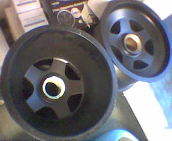

hi, i bought one of frans 917 mono and since the boltpattern of those discs are different to the original i would have 4 original campagnolo 917 wheels from 1970 for sale.the price would be 9000swissfrancs + shipping. the swissfranc and the usd is almost 1:1
the front is 11x15 and the rear is 15x15

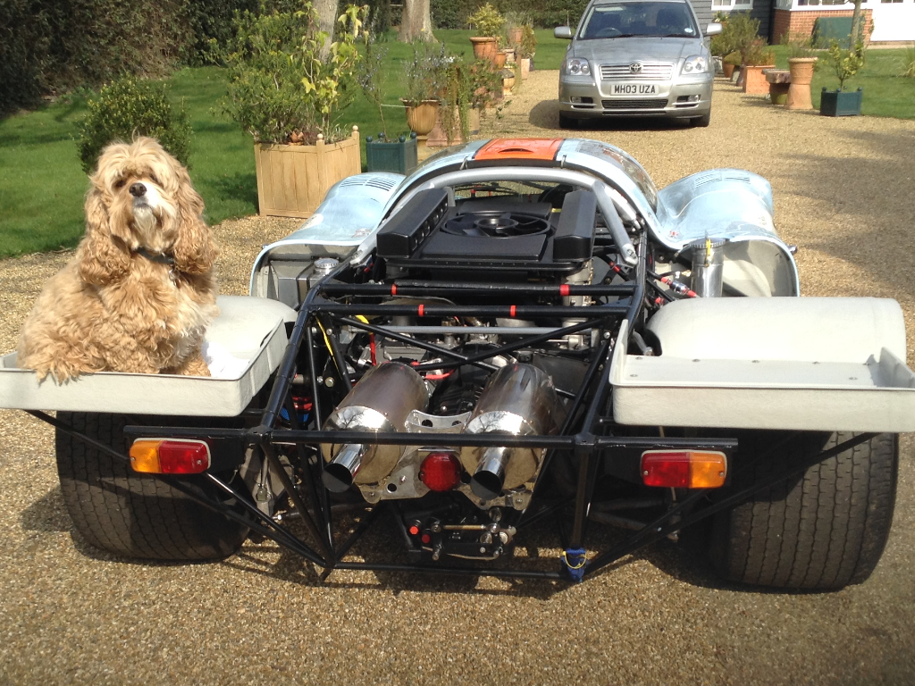

I have a long way to go, but this is superb info! Here’s mine with a V12 twin turbo...

For your 917s to handle right and anywhere near to the originals, you must keep the weight down to allow the Porsche engines to deliver the power, and fitting an after market type fan is not only top end heavy, but draining on the engines output. That gearbox of yours is very heavy and will give you an even great pendulum effect in handling. I ran the conventional vertical fan with a lightweight electric one above. Extremely effective, very light and in the right position. Whether you have a steel or alloy tubed chassis, you will still have flex, even in the upper chassis tubing, and don,t be too skimpish on your matting. Things will "pop" at speed I too, ran a single driver side tank but with an extension as per originals, so as to give me extra racing distance, but do be very careful in your mounting and covering of it, as the very concept of these cars is inherently dangerous, and you will be sitting in a beautiful, but lethal race car. Your bodywork comes from the moulds of original body parts I loaned to Fran back in 2005 !!!!
Chris Kouba
Graham,
If you're worries about the height and rear-offset of the CG, I would strongly recommend removing your canine companion before fitting the bodywork. I'm no Colin Chapman, but that's probably an easy way to add 30 or 40 pounds of "lightness".
You're welcome!!
Chris
Or you can just stick a V8 into it and not give a darn, muhahahahahahah =)
