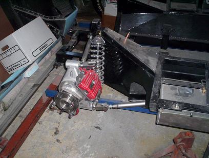

Does anyone know whether there's a parking brake rotor and caliper that will bolt onto the output shaft plate of the porsche 930 transaxle? This would allow for an inboard parking brake.

The car lacks parking brakes - it has corvette rear suspension. I looking for a way to install a parking brake!

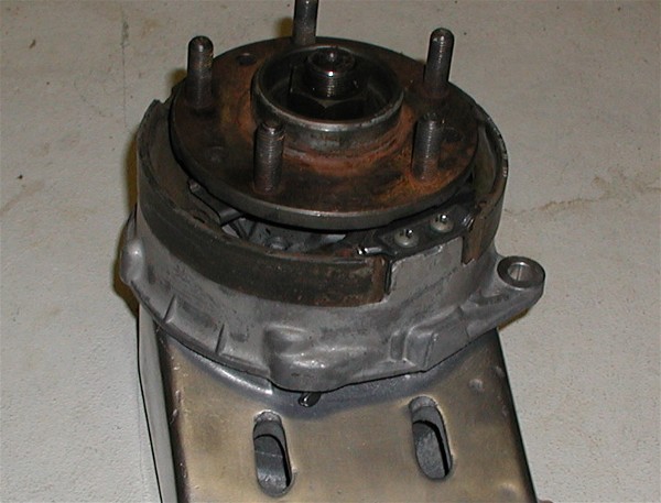

Chris Kouba
Just a random thought but doesn't the Corvette have an integrated drum brake in the rotor bell which serves as the e-brake? I am pretty certain the C3 and C4's have them. I'm not pretending to be a Vette expert but I thought that's how they resolved their issue. That should solve your problem too if that's the case...
Chris
Chris,
You are correct that there is already a built in option with the Corvette. It is simple and straight forward. There is a lever that the cable attaches to that expands the brake pad to hold the rotor. The small hump at the bottom of the drum section is where it hides.

Thanks for all your input - the problem with the hydralic lock is that as the fluid cools, the brakes loose pressure and your car will likely drift away - not a happy prospect for a GT40 which has no bumpers.
I've looked at the Wilwood caliper but can't figure out how to mount it - I would like a bolt on solution. As to the built it parking brakes on the C4 - I've examined the caliper assembly and can't find the mounting for the shoe brakes. The prior owner changed the rotors to slotted rotors and I assume that eliminated the parking brakes.

I tried to post pictures of my C4 hub which is attached to the Porsche 930 - Unfortunately, only very small pictures can be posted on the GT40 site.
I removed the rotor just to be sure and it does not have shoe parking brakes
