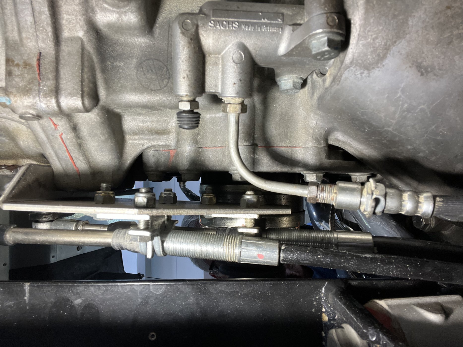

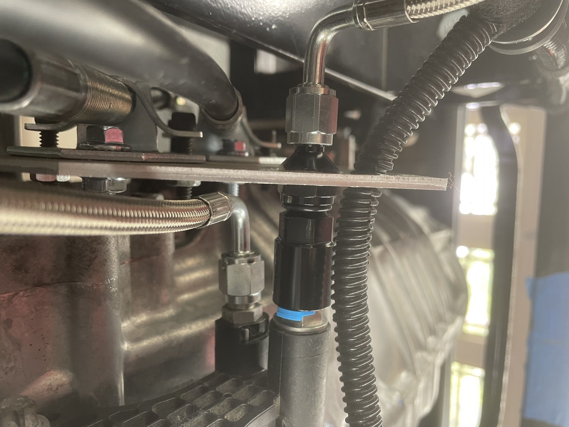

Joe I also have a Porsche 997 transaxle with a Wilwood clutch setup. I created a fitting into the original trans hydraulic port and connected the hydraulic hose. I bled from the fitting (black cap) next to the hose on the transaxle. I never had an issue and works great. Hope this helps
Thank you, appreciate pics.Looks like you have the 997.1, that only has a supply with bleeder.
