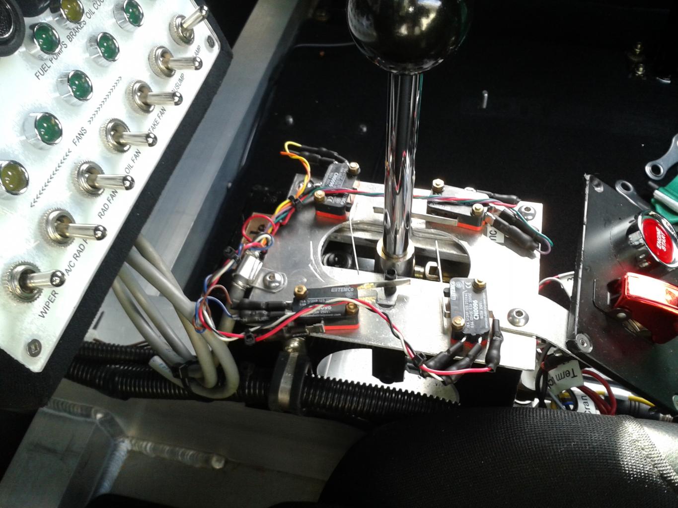

Joe, I made a mechanism with 2 spring loaded plates one each side of the shift lever that forces the lever to a central (3rd & 4th) position. So there is pressure each side when going for the other 4 forward gears. This gives a very positive feel of where you are. I then put gear indication on the dash. I use 4 micro switches to collect lever position and made a prototype circuit board using logic chips to convert the switch information into a gear number with appropriate data for the LED numeric display. It displays 1 thru 6 for forward gears, 8 for reverse, flashes 0 when in neutral and a solid 0 in the case of a mis read. This arrangement is still a prototype but has proved reliable and has transformed driving the car. I don't stir coffee anymore.
