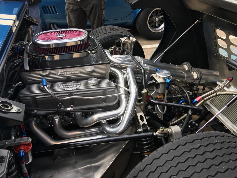

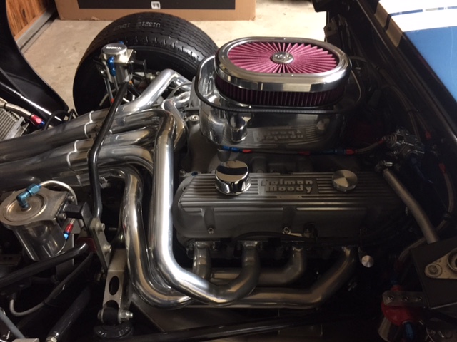

Mine is 351W/408 Stroker with Hydraulic Roller and it spins up fast........... Don't think you can go wrong with either combination.
Vid1 2 11 17 - YouTube
