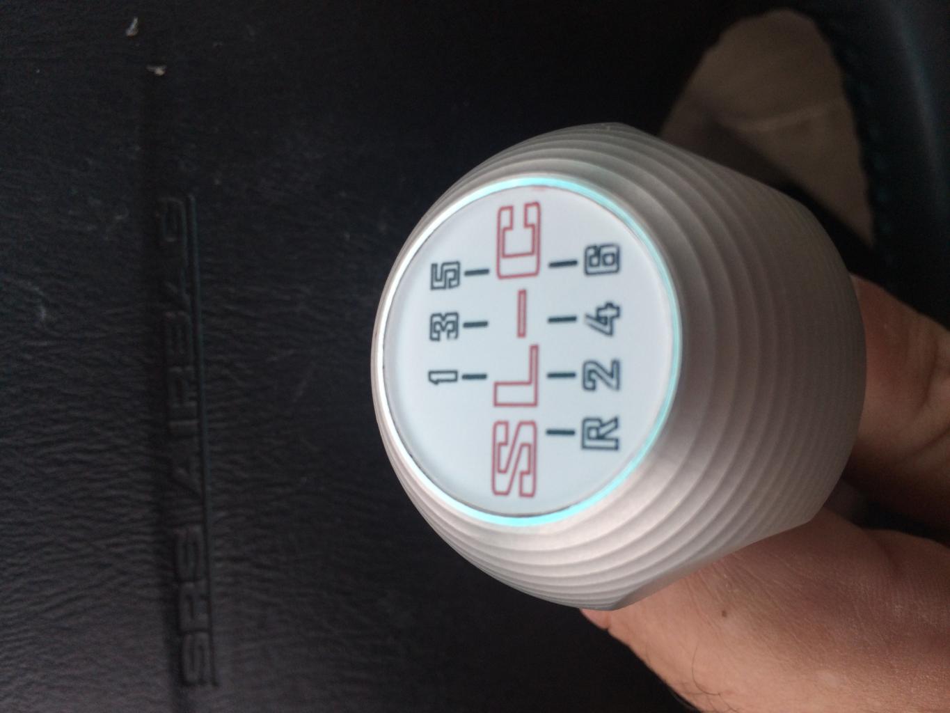

The knob is from one of the GTM clan but it was engraved with the wrong pattern. I cut a recess in the top and made a new tag for it. I can duplicate the tags, change colors, etc if anyone is interested.
Tools used: AutoCAD (for layout), CNC tag engraver ( for the tag ) and a lathe to cut the recess in the top of the knob.

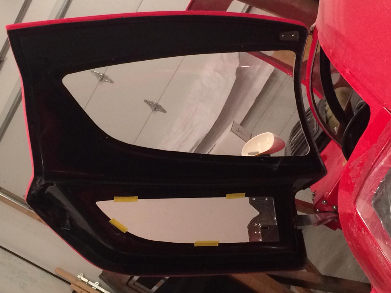

I've basically finished with the Miata outer door release assrmblies, inner door release and the tie rods. I created a slotted arm that bolts to the back side of the Miata outer door release. The slotted arm serves to lock the handle as well as allows the inner door handle to always function (without a locking mechanism).
