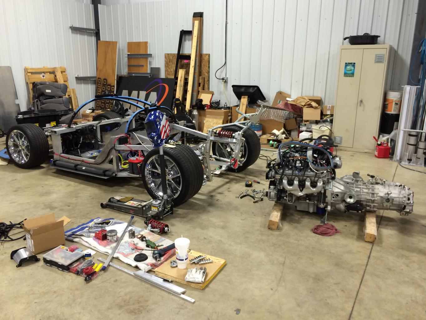

Removed the engine today to complete some planned adjustments and modifications.

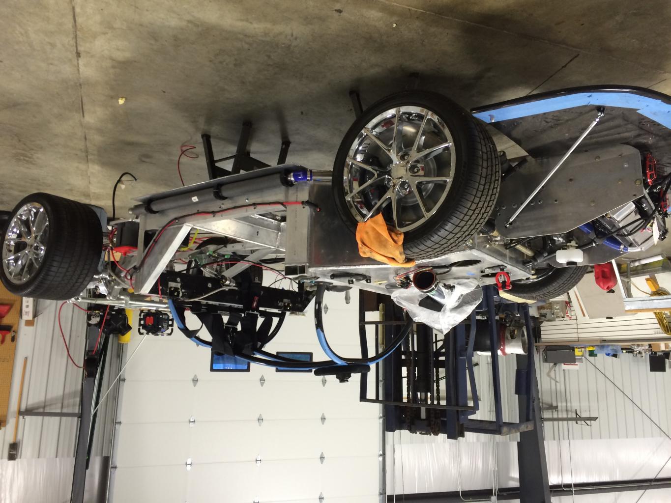

Another handy item when building an SL-C..
A fork-truck :) and a welder.. :idea:
Sorry for the upside down photo guys..

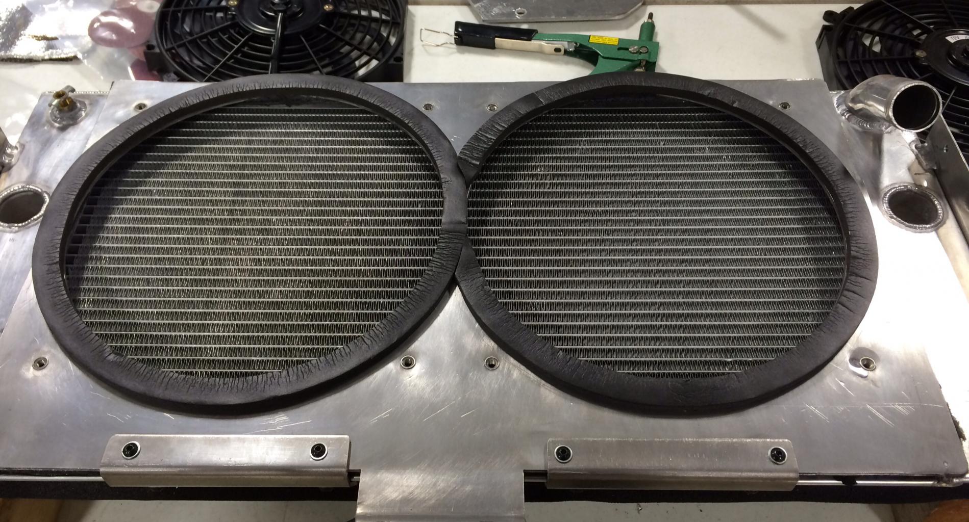

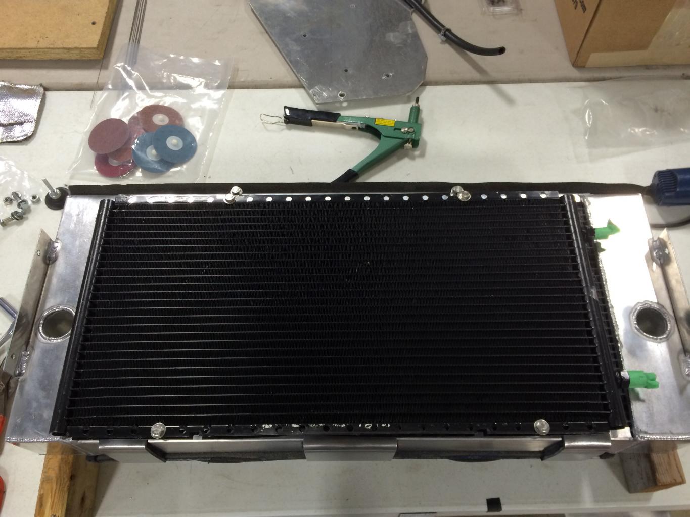

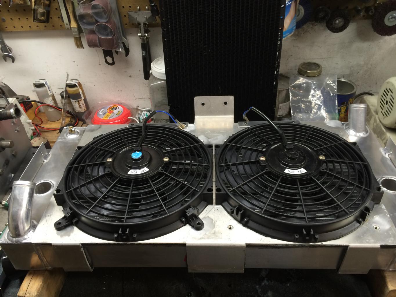

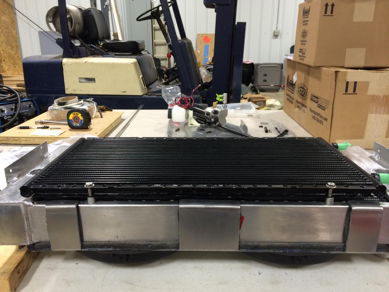

Today I modified the fan should that Jim created.
I massaged it to fit a bit better and added riv-nuts to secure the fans. I created spacers for the condenser and I'll mount that tomorrow.

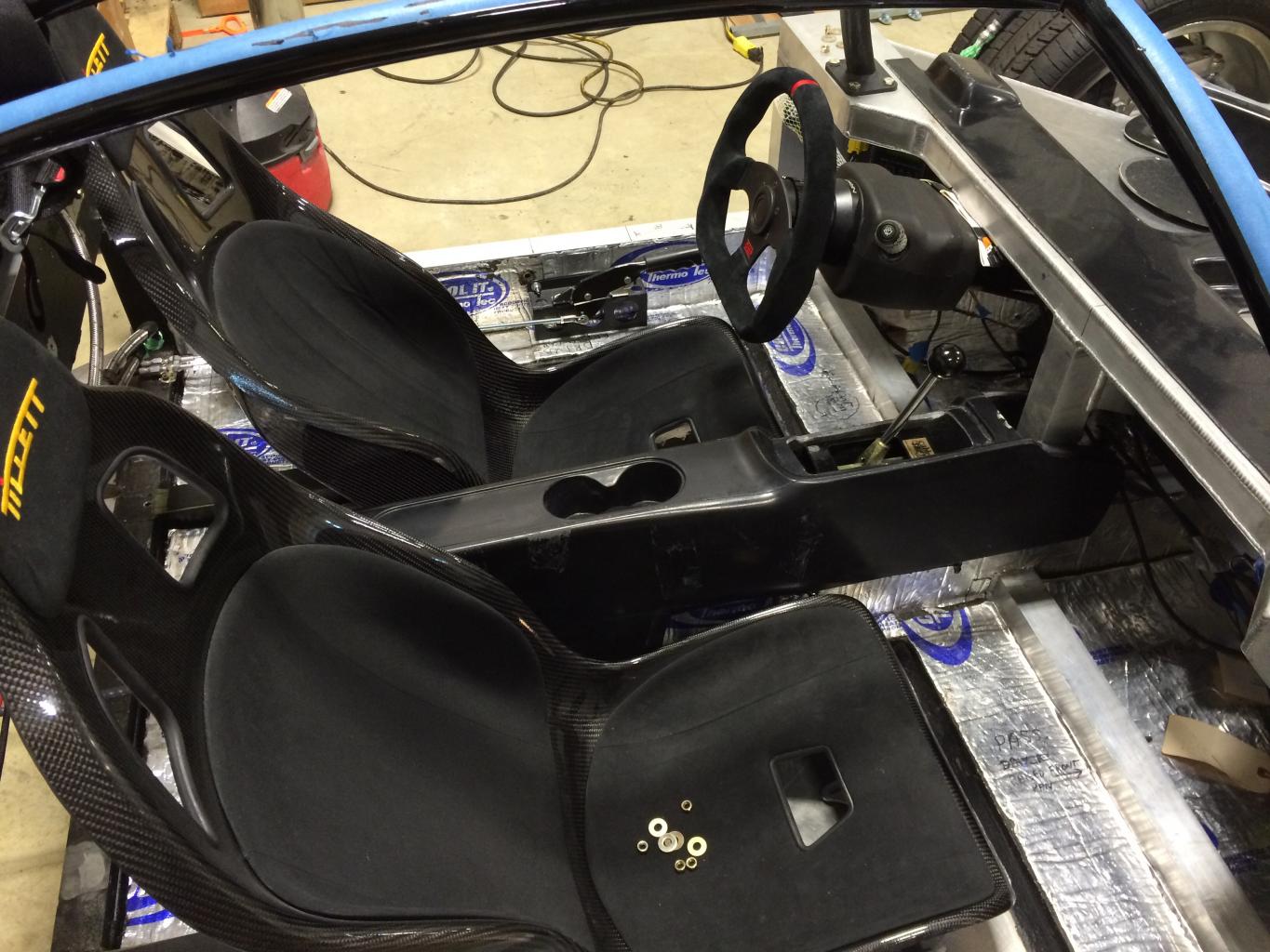

Mounted the shifter today and pre-fit the console. I changed the angle and height of the center console fiberglass piece to better support my arm. I welded threaded tabs on the chassis to mount the shifter.
