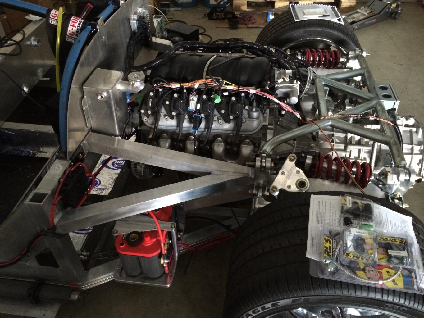

The transmission mount isn't that crazy. I might make a narrower plate that spans between the factory support holes in the transmission and remove the RCR steel brackets as well.

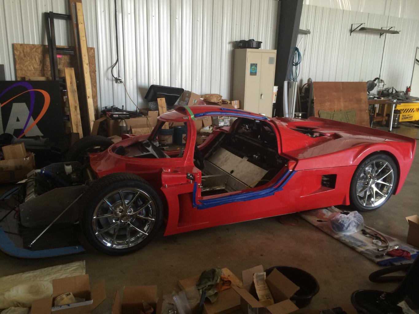

Shocks installed.

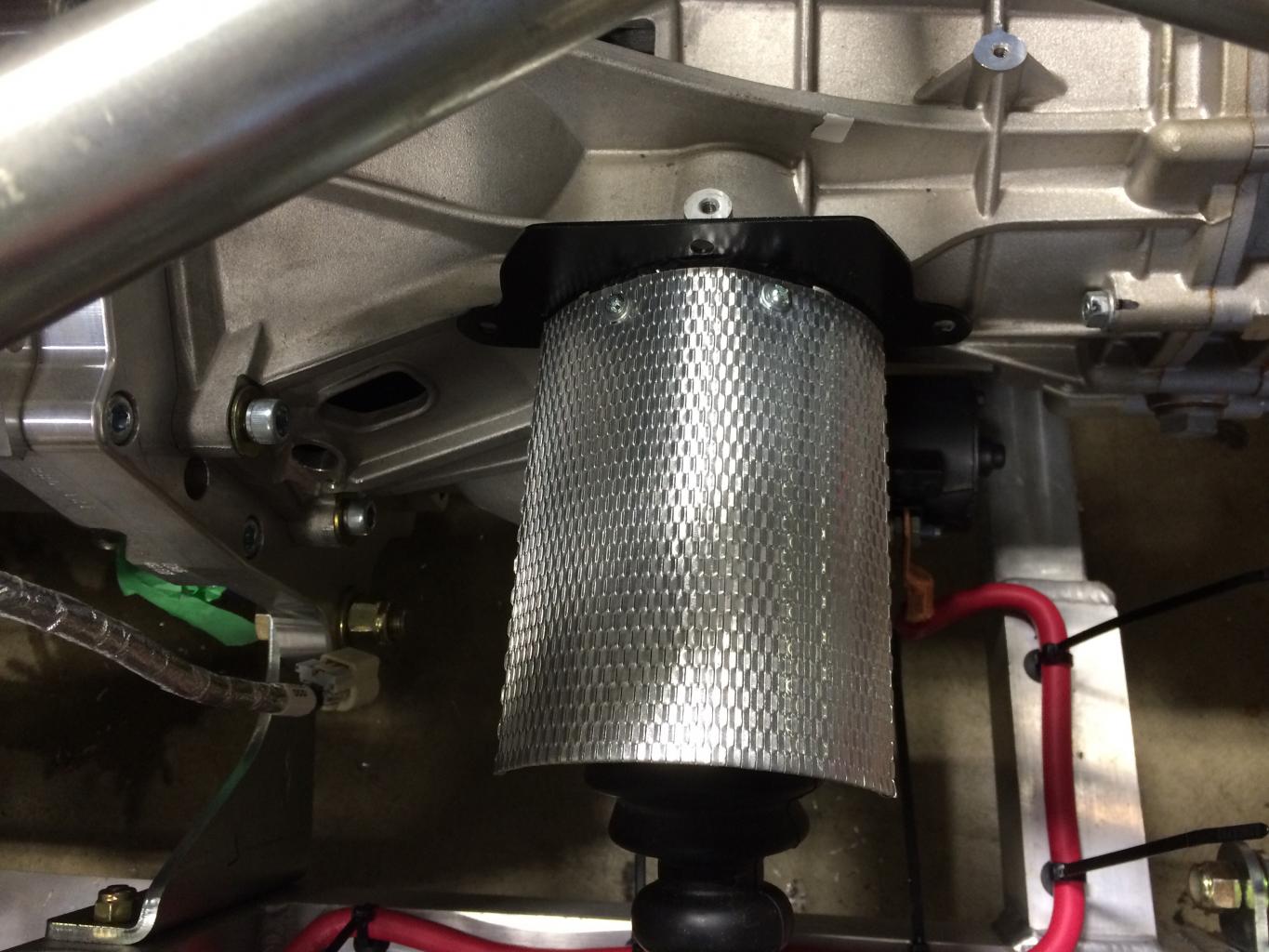

3) Fabricated CV boot heat shield that attach to the transmission case.

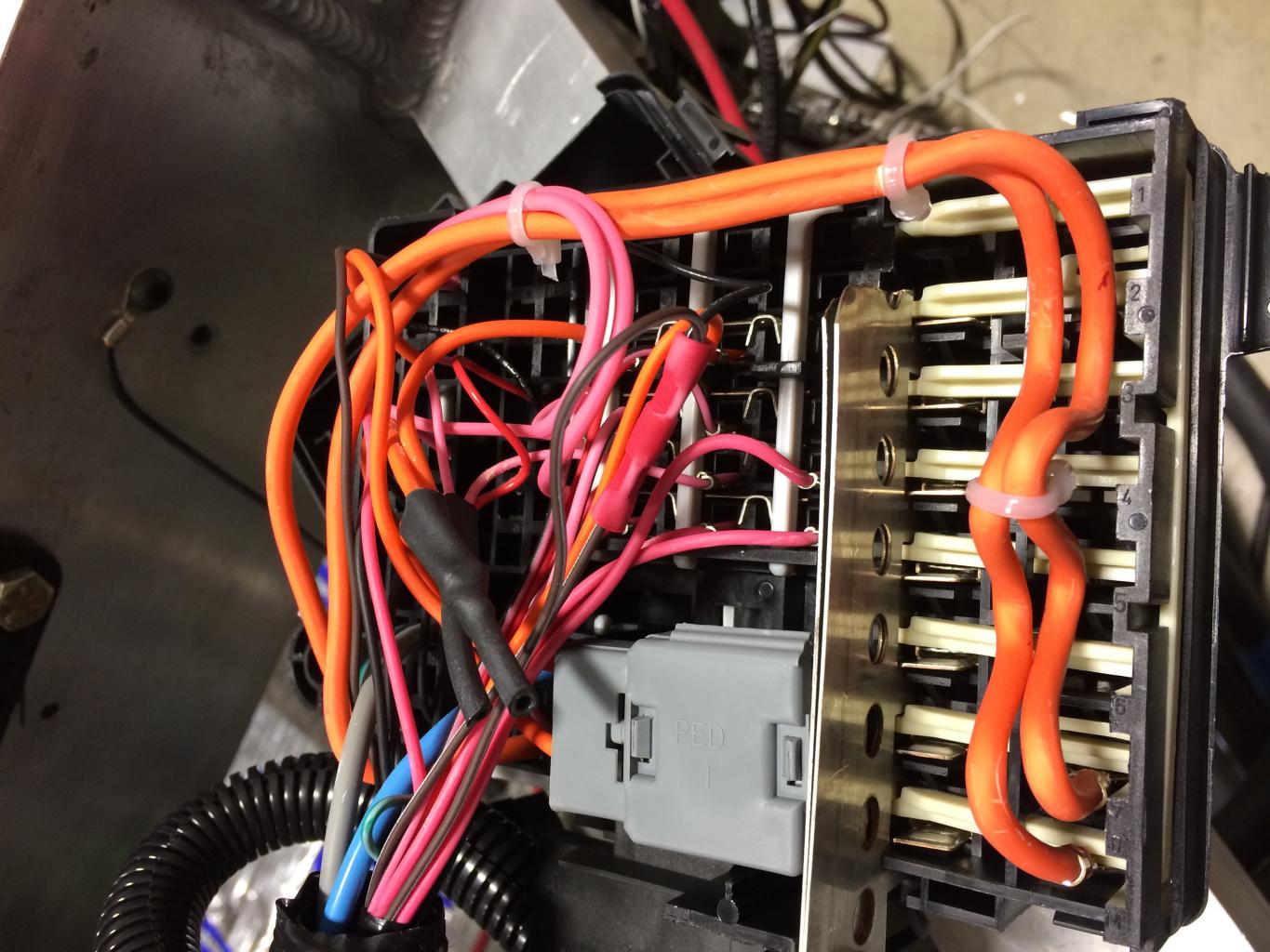

All of the parts arrived to finish the air intake and fuel system. I wired up the battery and starter last night as I'm routing the ISIS rear harness. I've also mounted the fuse panel and ISIS rear power cell.
Tonight I modified the GM fuse panel to route the large gauge orange coated wires inside the fuse panel. This cleans up the look of this unit. I simply cut back the buss bar inside the fuse panel, removed one of the fuse contacts and replaced the 30 amp fuses to other unused locations.

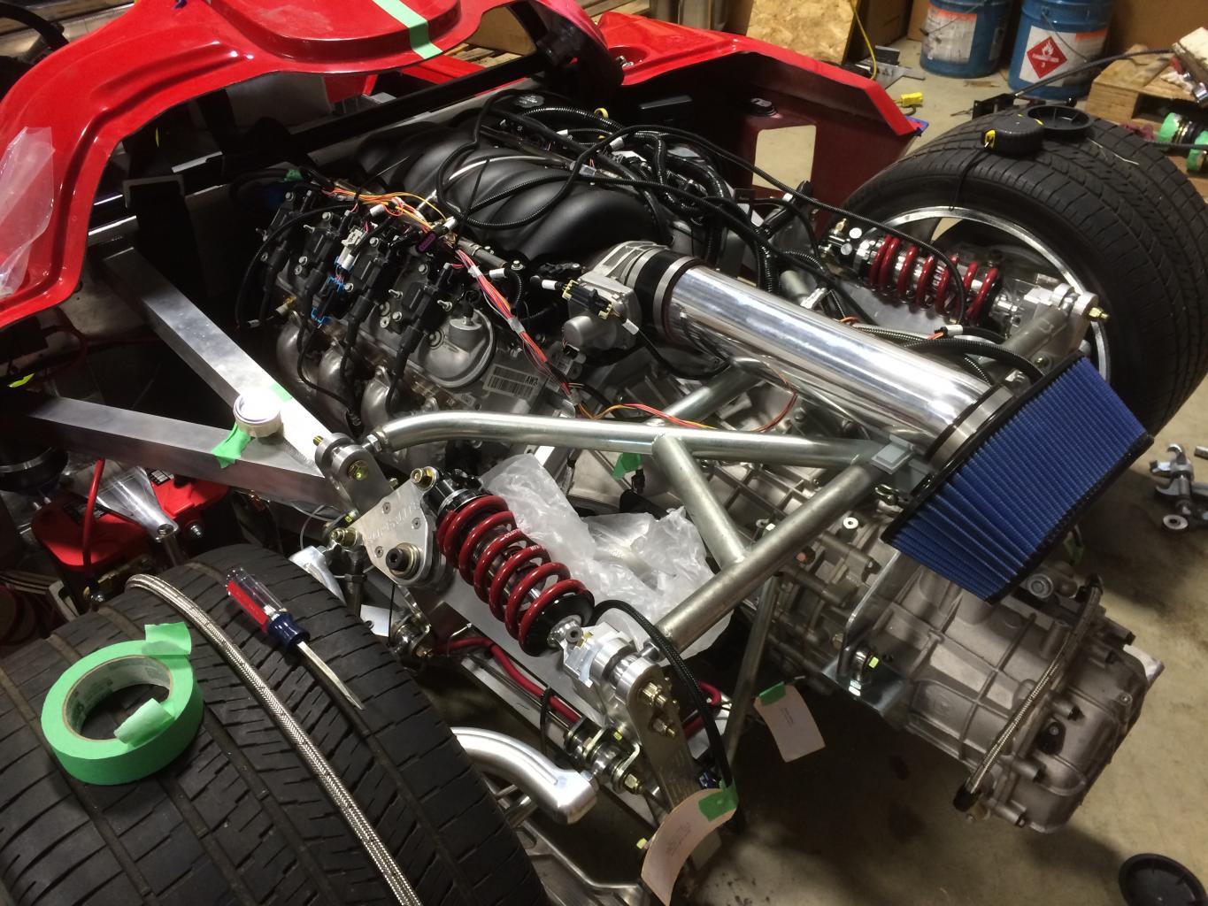

I've modified the air intake tube and fit the new air cleaner. I'm working to connect the PCV circuit as well.
