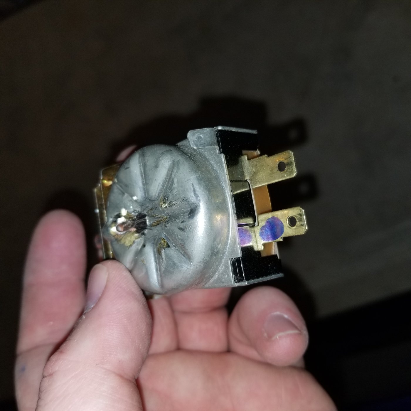

While installing my dash I checked to make sure my ac compressor was coming on, and it was'nt. I noticed the copper hard wire going to the compressor switch broke off. Figuring I am going to be ordering some parts on Monday, I wanted to see if I could fix it. I bored out the hole where the old tube went so the new tube could fit. I tried to solder the line back in without any luck. I am sure I am not the first to have this problem. Any info would be appreciated.

The AC switch that's failed on your car is a thermostat. The probe that broke off simply plugs into the top of the black case (goes in an inch or two IIRC). Pull the old one out and run your replacement into the case - it literally just pokes into the black casing an inch or two and that's it.

Cam, thank you for that information. Would this braking off cause my compressor not to turn on?

It's an item that is easy to bend too much and break so I can see how you could have broken it. Fortunately it is an easy swap and you have the correct part above.
Trace the capillary tube( the tube you broke off) to where it goes into the hole in the aluminum under the dash. Straighten the new tube and place it back in the same hole. This tube goes down into the core of the evaporator. Then just wire it the same as the other switch, power in from the fan switch and power out to the trinary switch.

I received the switch today, and got the dash back together. Even got a short drive in before the rain. Thank you guys for the info.
