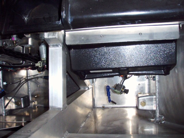

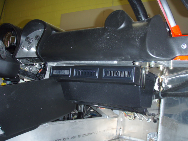

Ken - I may be totally wrong - Fran would have to chime in - but I don't think that's the unit currently being used. I think it's the Mini Slim Line under dash unit - http://www.vintageair.com/2012catalog/2012 VintageAir Catalog Final WEB (Page 48).pdf
The front vents are closed off and openings are cut into the top of the unit. The first photo shows the unit with the front vents in place and the second shows it with them closed off and new openings cut into the top of the unit - as observed at RCR on 3/20/12 :
Dave L

You're of course correct but I think Cam's car was delivered before RCR made the change to the Mini Slim Line unit. There have been quite a few changes made since Cam's car was delivered including a fiberglass duct system that mounts on top of the footwell/under the dash.
