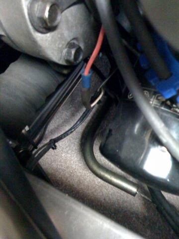

I am finally getting the car back together after a lengthy respite. I have a red wire coming from the AC compressor with a male end to it that I cannnot remember where it attached . You would think it would be obvious but I cannnot locate the other end. Any ideas? thanks; chuck
Chuck, I'd start by looking for a red wire with a female end.......
Just kidding, I'll go take a looksee at my CAV this evening and see if I can find that wire for you.
There's a wiring diagram in the back of the CAV owner's manual. I have a couple extras if you don't have one, just let me know and I'll pop one in the mail to you.
Hey Chuck,
That's funny, my Owner's Manual has a decent wiring diagram in the back. Of course, it doesn't include any engine wiring, just that which is attached to the body as supplied by CAV for the pre-100 cars (mine is mono #6).

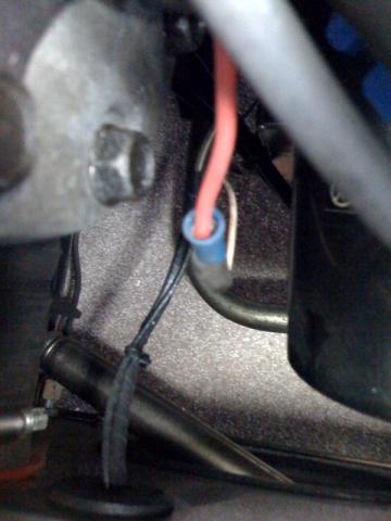

Here's a couple pics of that red wire coming from the AC compressor - it goes to a white wire which disappears into the LH side pod as you can sort of see in the pic. Hope that's helpful!
