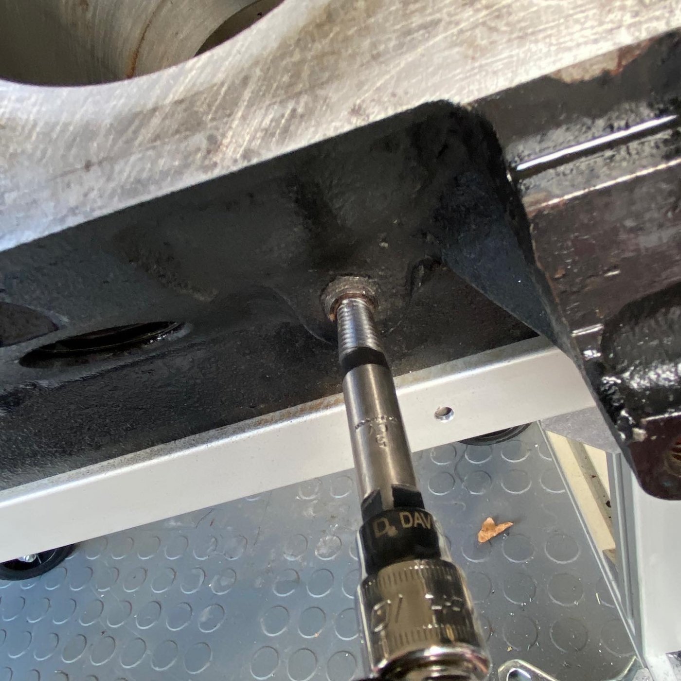

Jac Mac yes it’s quite a big company so not the old school ‘don’t leave it in too long’ fluid.
All threads already cleaned with a plug tap and core plugs and threaded gallery bungs out ready for a decent clean. However I wish I’d left these two well alone :(
