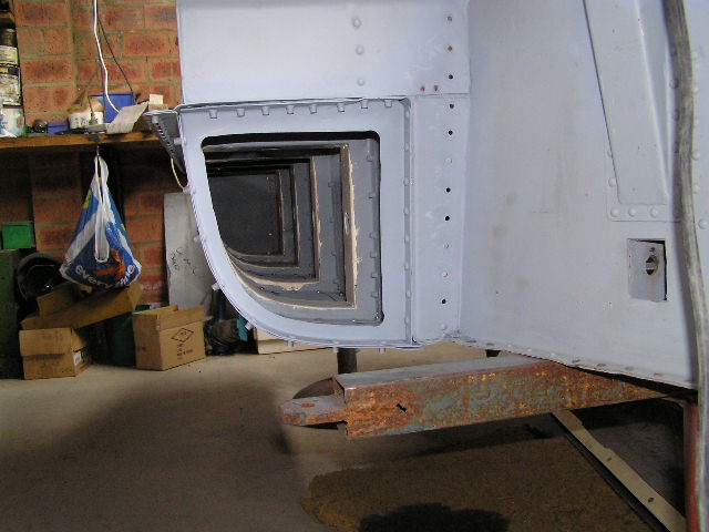

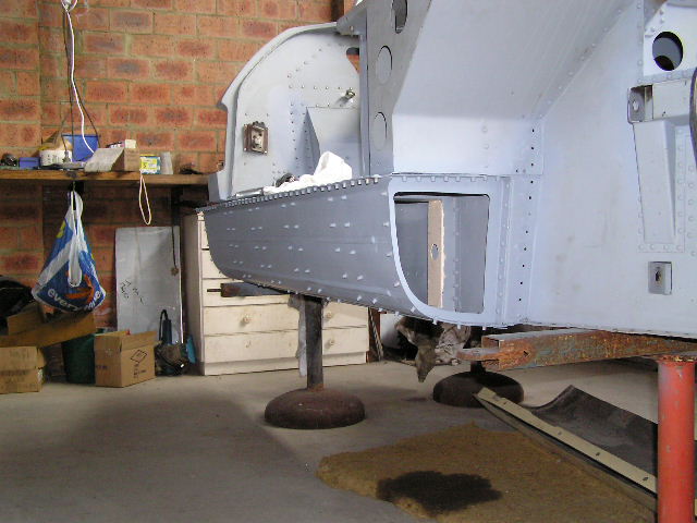

aluminum tank question
Trevor Booth
like this Jim
you can see the coating in beige

OK- they ALL vary, both in shape and dimension. The only way I can see to accomplish this is to template the inside shape of the sponson ribs and then make a mockup of the tank out of light plywood and trial-fit that. That is one of the next big jobs we have to tackle on 1149. There are some things to keep in mind (some of these courtesy Andy Booth in UK who kindly supplied me with photos of his tanks):
-make sure there is room to get hoses and clamps etc onto all the tank spigots or threaded fittings once the tanks are inside the sponsons.
-the tank pickups ought to be at the back of the tank, and down low, with baffles around them.
-likely you will be better off with a vertical sending unit rather than the swinging-arm type.
-fill tank with Explosafe before it's welded up shut.
For 1149s tanks, we plan to make them a bit small and then glue strips of neoprene along the tanks so that when they are tapped into place they will remain there. Keep in mind the tanks need to be baffled at three or four points in order to avoid free-surface effect sloshing that will possibly move the tank inside the sponson. There should be a way for air to circulate inside the sponson and for condensation to drain out (filling the tank with cold fuel on a warm day will cause condensation outside the tank and ultimately corrode the tank).
MAKE SURE the tank is grounded to the chassis!! I suggest a commercial ground strap with zinc-plated ends. I would not use copper cable- it will eat through the tank if the copper comes in contact with the tank.
