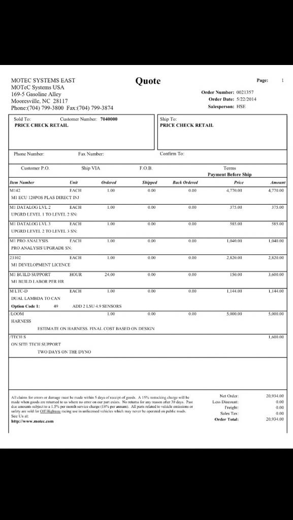

Last year Motec did not have an option for me for GDI. This year they sent me an estimate using an M142 Ecu and includes 2 days Dyno time - 20K.
