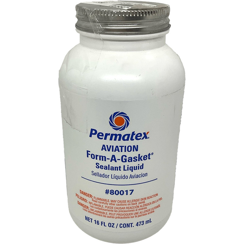

I use this stuff. It works very good on pipe threads and gasoline. I've had a 1 pt can of this for years and I'm still using it. Get the 4 oz size and it will last a long time. Tape was not allowed where I worked. Little pieces get into the small orifices and plug them up like master cylinders, jets, sensors, Proportioning valves, and especially ball and seat valves like Residual Pressure Valves and needles and seats.

Permatex Aviation Form-A-Gasket No. 3 is great stuff, but I would ABSOLUTLY NOT use it for automotive fuel lines. You may be thinking that if it's used in aviation for fuel lines (amongst other things), it must be good enough for your project car. Not so fast. Aviation fuel has zero ethanol in it but, depending on where you live and the time of year, your pump gas may have up to 10% ethanol. I think that 7 states mandate ethnol blending and unless the pump states no ethanol, you're not sure what the ethnol content is. The issue is that ethanol will soften Permatex Aviation-Form-A-Gasket. According to the data sheet:
"If the sealant has been dried for a long time or at high temperatures, cover the sealant with alcohol and allow to soften overnight."
Ethanol is an alcohol and is therefore not compatible with the sealant. E85 is obviously a non-starter, but I'm sure that someone will state that they've used it with automotive pump gas for years without an issue. Maybe their gas had low or no ethanol or maybe the threads were really tight or maybe they're lucky or maybe they have a pending leak. However, I've seen leaks occur on cars and a boat that were running pump gas. In MA where I live the ethanol content seems to be 5-12% as measured by an inline flex-fuel sensor. Current legislation is looking to allow up to E15 to be sold year round and my guess is that the number is only going to increase. There's also a small chance that if you don't store the car properly the fuel will phase separate and you wind up with a layer of pure ethnol which is basically what Permatex prescribes to remove sealant that has cured over a long time or at high temp.
From a performance point of view ethnol is great stuff, you just need to account for it. My SLC is flex-fuel capable up to E98. There are other products that are just as good and are resistant to ethanol. I found another sealant (forgot what it was), but later decided to replace all NPT connections with AN or ORB fittings.
Long and short, Permatex Aviation Form-A-Gasket No. is great stuff but I would not use if for automotive fuel lines.
