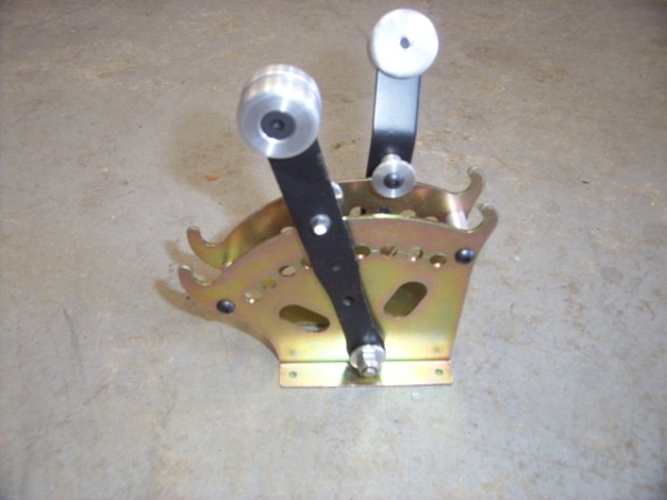

Dave York here is the pic for you
Ross /ubbthreads/images/graemlins/driving.gif
