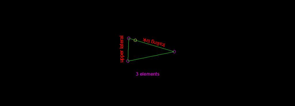

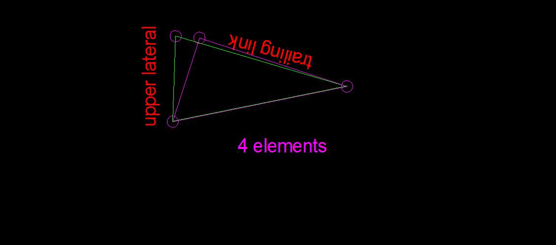

The offset is to make the suspension 3 elements not 4.
3 elements (pivots) it will move freely through its ark. 4 pivots will bind on bushes but still works on r/joints, but you may get some odd reactions in the arks.

I did a drawing in the first the yellow ring is the upper trailing link rear joint on the same plane as the rear outer lateral.
The green line is the shape of the control arm.
The 2 drawing is with the rear trailing link joint not on the same plane so you end up with another control arm in magenta.
Thats what I mean , you end up with 2 control arms if bushed it will likely bind.
Drawing 1 has 3 pivot points drawing 2 you know have 4 pivots on that suspension component.
Sorry about the size of pics ,when I jpg out of cad it makes them small for some reason.

This makes my head hurt. A lower arm is a 4 pivot system, so wouldn't that have the same issue? Lastly, if looking all of this from a horizontal plane, wouldn't the "3 pivot" still actually be a 4 pivot because the clevis generally aligned to an anti-squat trailing arms? I've got to study this.
Terry how can a lower arm (conventional) be 4 pivots.
2 lower inners and a ball joint.
Are you talking about the twin link arm set up?.
Actually maybe I need to do some study, I just played in susprog 3 with my set up moving the link on the clevis and other than KPI it didn't seem to have any real effect on all the figures, very minor if any.
So maybe having no offset on the clevis is fine ,easier to make.
Angled clevis would be better for lines of force though.
