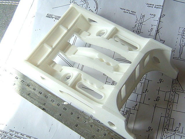

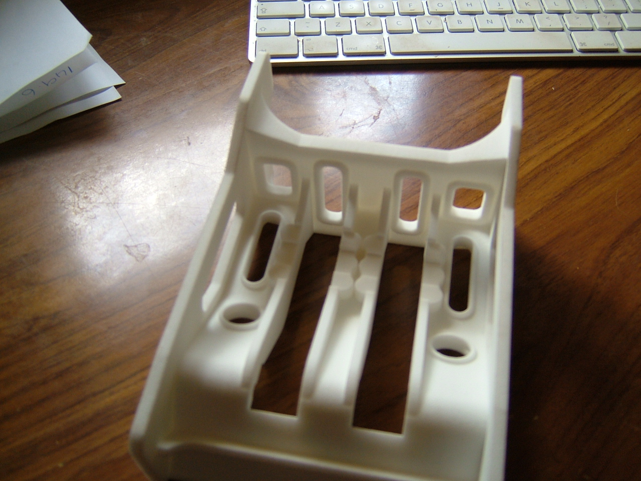

I have used Shapeways recently to print patterns for the motion castings on my latest live steam loco, a 5" gauge GWR.
The software file was produced in ViaCad on a Mac which is very simple to use.
Very good finish these days.
