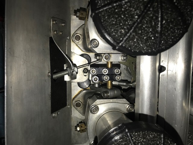

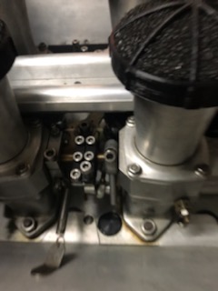

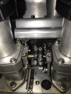

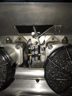

Anyone ever used Stack Injection ITB setup?
As you can see, the fuel supply system would be very difficult to fit with this setup on this block if the injectors were located inside. Much easier on wider blocks.
Tim.
I hope that’s the current system, I upgraded about 10 years ago so apologies if it’s the earlier smaller TB system and not the stack injection setup.
As I said, I can’t check atm.
Tim.
Chris
Thanks for that Tim, yeah I can see your point on that setup, it would be tight to internally mount those rails. Would be tricky to adjust the throttle system also if they were reversed.

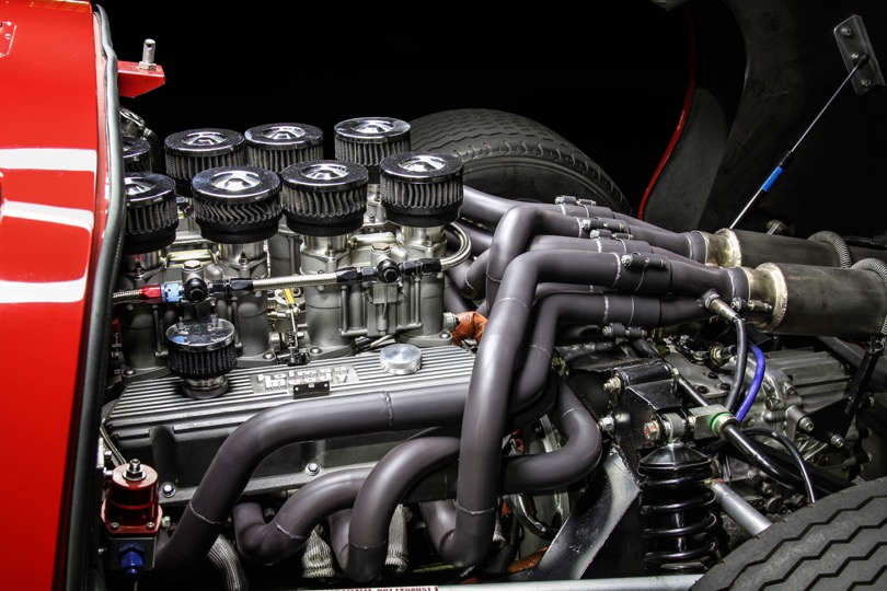

I have Borla's set-up that looks closer to Webers than other fuel injection options. I'm using the FAST XFI Sportsman EFI system with it.

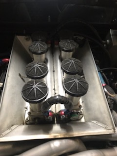

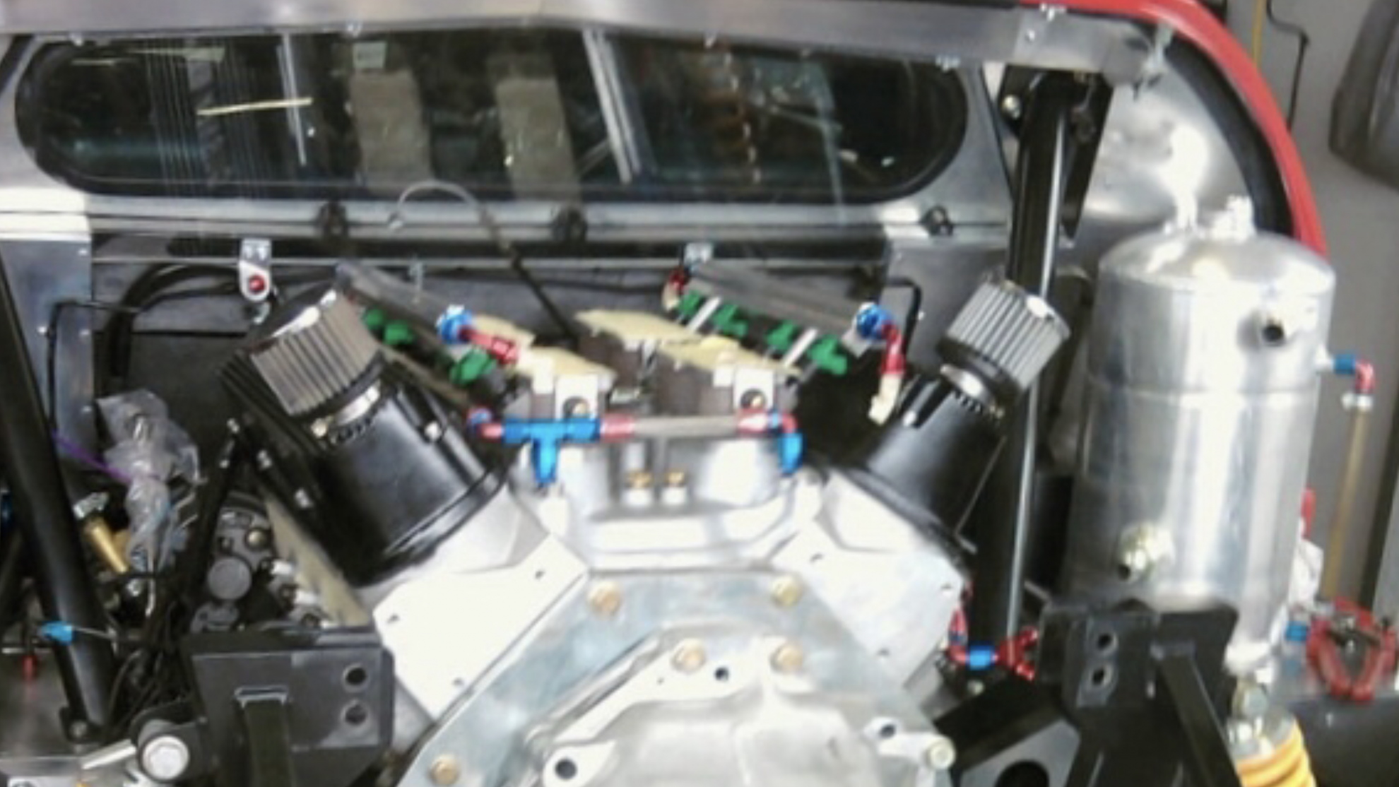

I bought the 8-stack injection for a 496 FE motor about 10 years ago, and really had a problem getting it tuned for drivablility (WOT, start-up and idle were fine, just could not get the final tune correct) it now sits in my office

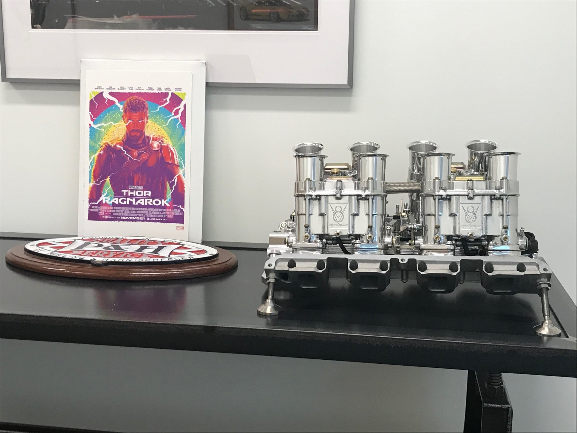

I am going Monday to Dennis's to pick up my GT40 which has the Borla (MTW) system.
The main difference between the two styles is the MTW system has the injectors below the throttle plates, not above like the 8-stack.
Everyone I have spoken to has had great luck with the Borla MTW style. My experience with the 8-stack....not 100%

I "was" running the Fast XFI 2.0 at the time. Dynatech (who manufactured the system at the time) had me take the car up to Philadelphia for their "expert" tuner to tune the car when the drivability issues could not be solved by me. The shop in Horsham, PA told me that the car would be ready in 7 weeks. 7 months later (new throttle bodies, new intake, and two sets of injectors) I went up and recovered my car and trailer. The car ran worse, and I left $4,500 poorer.
On a rather dramatic drive home (long story), my wife told me to put a carburetor on it. I did.
It could be the cam. On paper it looks okay, but it may have too much overlap.
I have owned Webers, and yes the 8-stack system started better, was consistent on idle, and no barometric issues.
I just had a problem on the map that I could move, but not rid.

I've run the newer version TWM/Borla Stack Injection system since day one. Although it ran pretty good with the included self-learning "EZ-EFI" after a few hundred miles of 'learning', that system is only designed to control fuel. I also had a separate computer programmable ignition box, but I wanted the ECU to do it all, have more scalability, data logging, and so on, so I traded in the EZ-EFI v1.0 for their FAST XFI Sportsman, which accomplished everything I was looking for. The XFI 2.0 is fine, but is overkill for a vintage-looking GT-40, unless you plan to go with a modern fully sequential with coil-over-plug setup, and have full fuel and spark timing capability from cyl to cyl, i.e. 8-1 cyl engines.
There are a few hidden pluses to the Borla system, which I like. The hidden under the manifold vacuum chamber, the under the throttle plate injectors, center mounted fuel rails that properly angle and feed the injectors under the throttle plate, and probably the least noticed but important design is the flex couplings that are unique to the Borla. As these manifolds get hot and you have dissimilar metals expanding at different rates, these couplings flex axially, which help to minimize the interaction between the throttle bodies and butterflies, so they are binding against each other. That can cause rapid throttle bore wear, which eventually results in air leaks when the throttle plates are closed (idle) and all kinds of syncing issues since you have some cyls getting more air than others even when the throttle plates are closed. Getting each throttle body flowing the same amount of air next to each other and bank to bank are one of those key elements to getting these systems to run well. The throttle response is incredible. Not sure what the cfm rating is on the 50mm throttle bodies, but it has to be in the 1000s!
