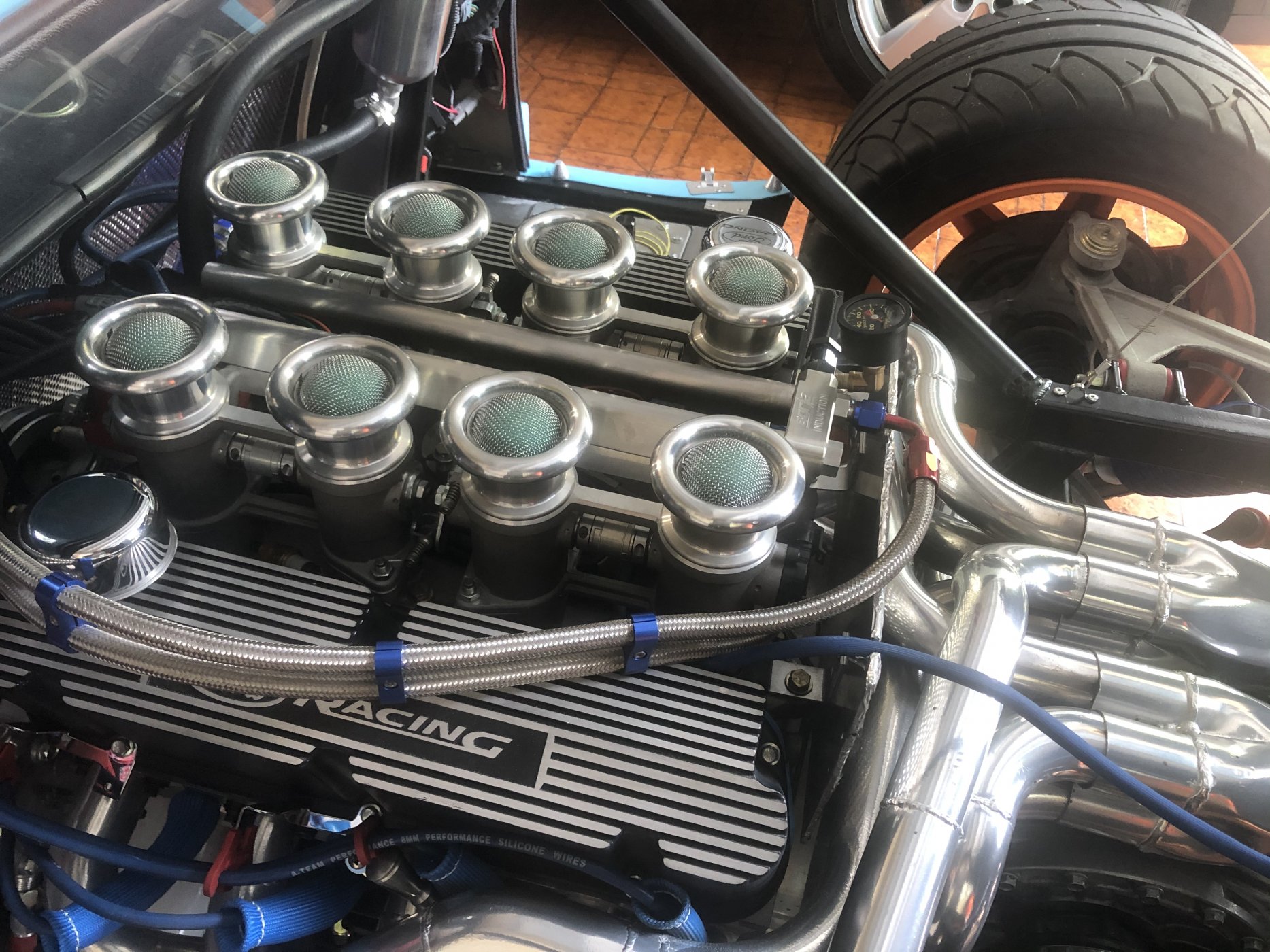

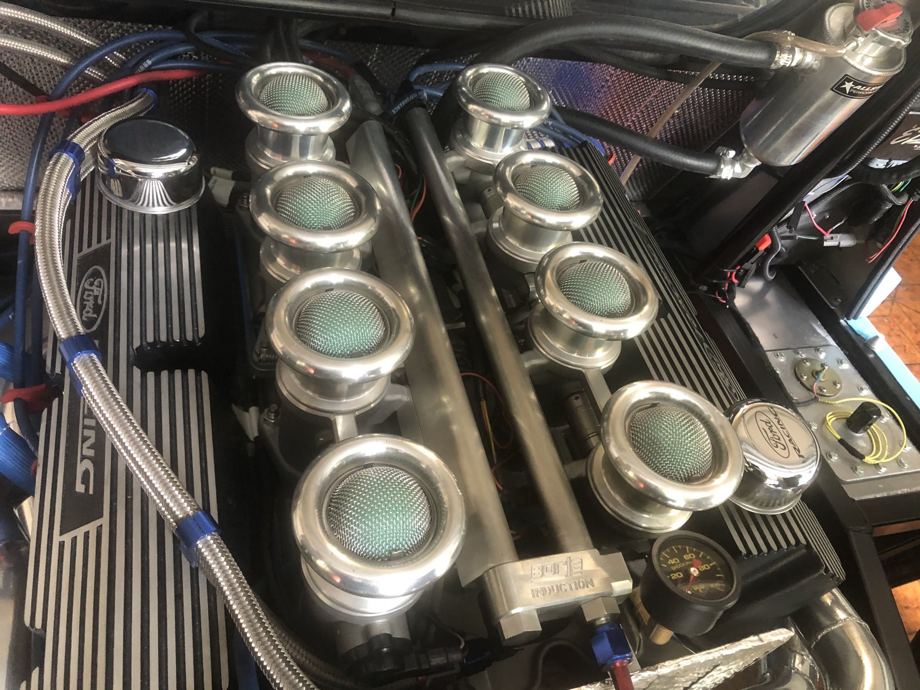

Made my own air filters for less than $40 dollars.
Eric B
Eric
^^^THAT'S S-T-U-N-N-I-N-G!!! ^^^
(I'm glad YOU have to keep it shinny and not me though!)

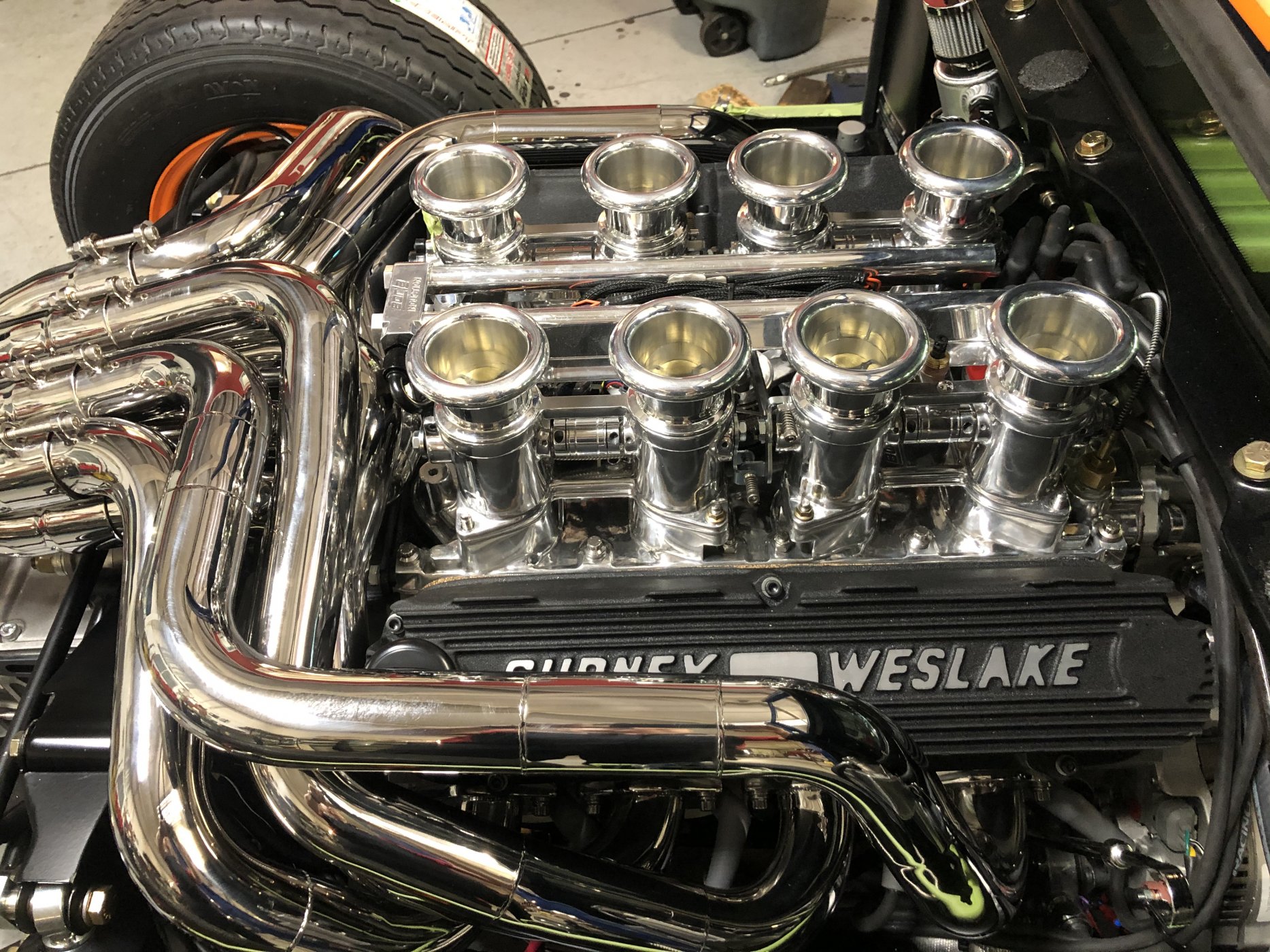

Larry, I don't know how it will be with polished stainless headers. I have Firefly SS side pipes on my Cobra, and they do "gold" after maybe three years after I first got them. For a winter project I pulled them off and polished the gold out. Then about 5 years they gold, and some "splotches" (technical term), but I pulled them again in the winter, polished them again and they look great. I do not know how much faster these will gold, I will have to see. But if they do I won't have time to spend in bars with fast women next winter. :p

Did you have them coated INTERNALLY with ZyCoat or Jet-Hot or the like?
That ought to stave off the "golding" to some degree, shouldn't it?

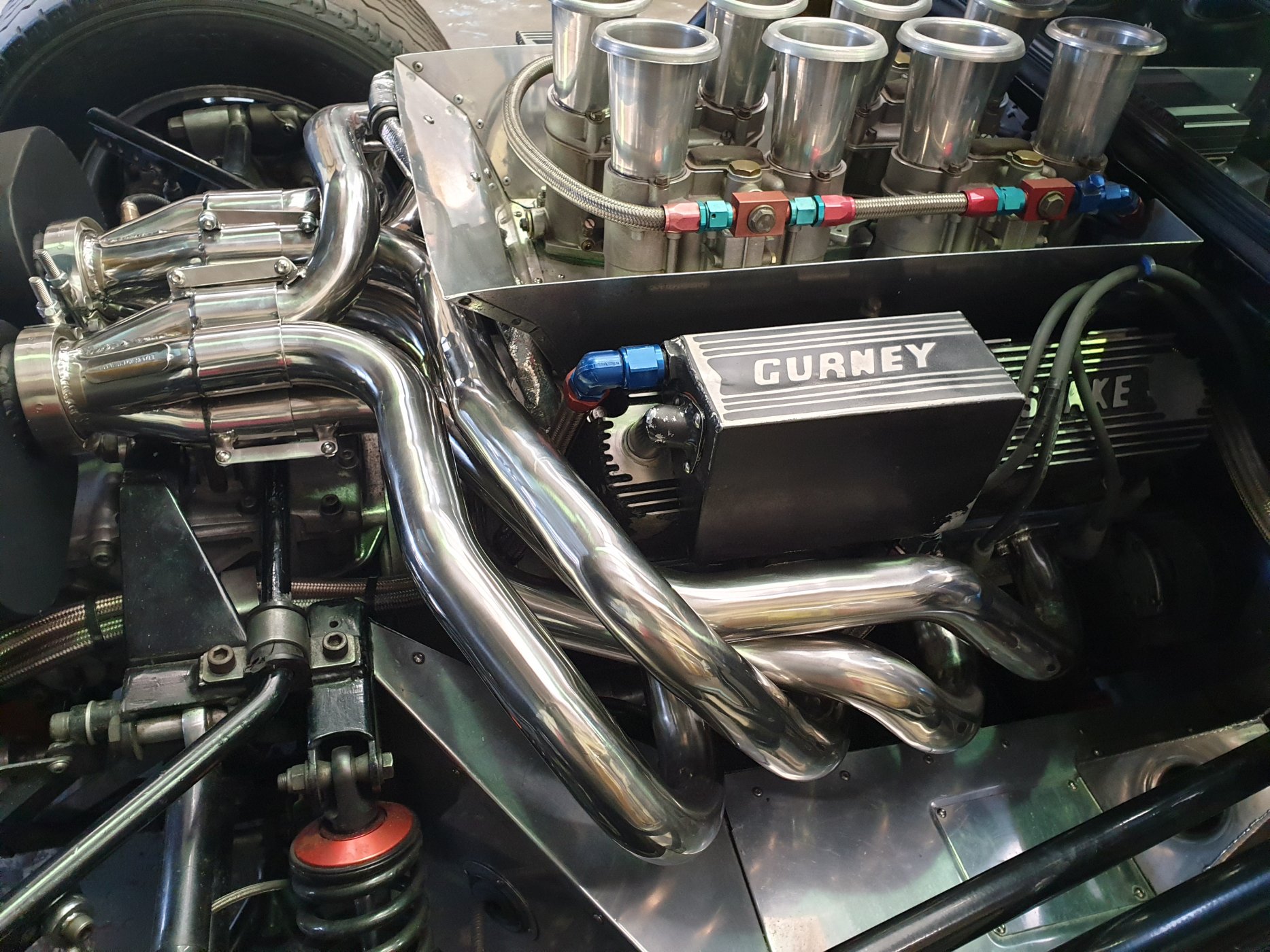

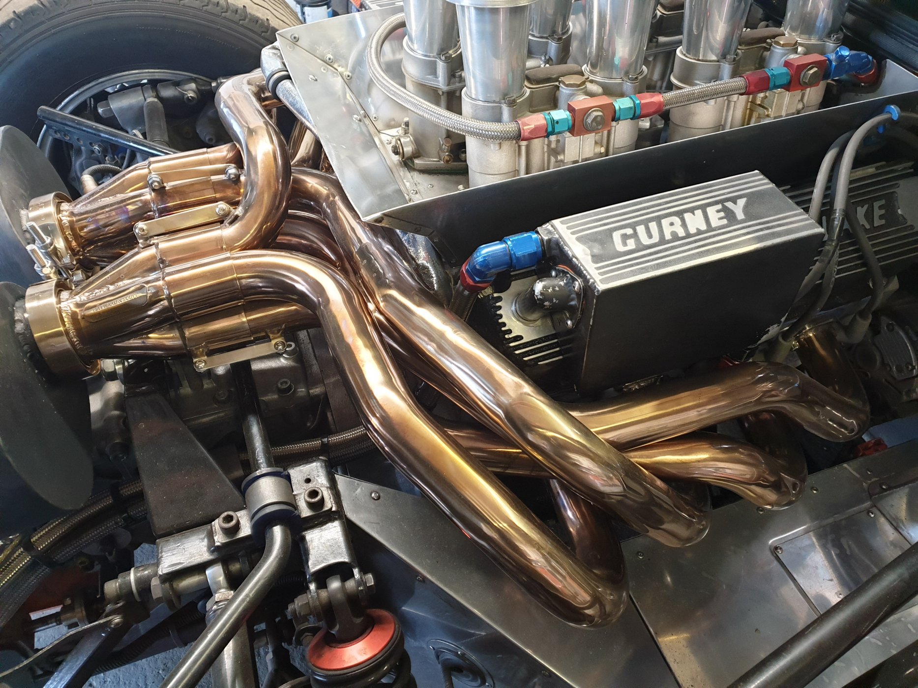

Blimey Eric, three years! Mine went from shiny to gold in one trackday! I must get some of whatever you put on yours. ;)
Yes, there is a ceramic coating on the inside of the headers in the picture above. I have seen two other GT40's with these headers, and they seem to be doing good to keep the golding off. A lot of that has to do with if you drive in the rain too, which normally I do not.

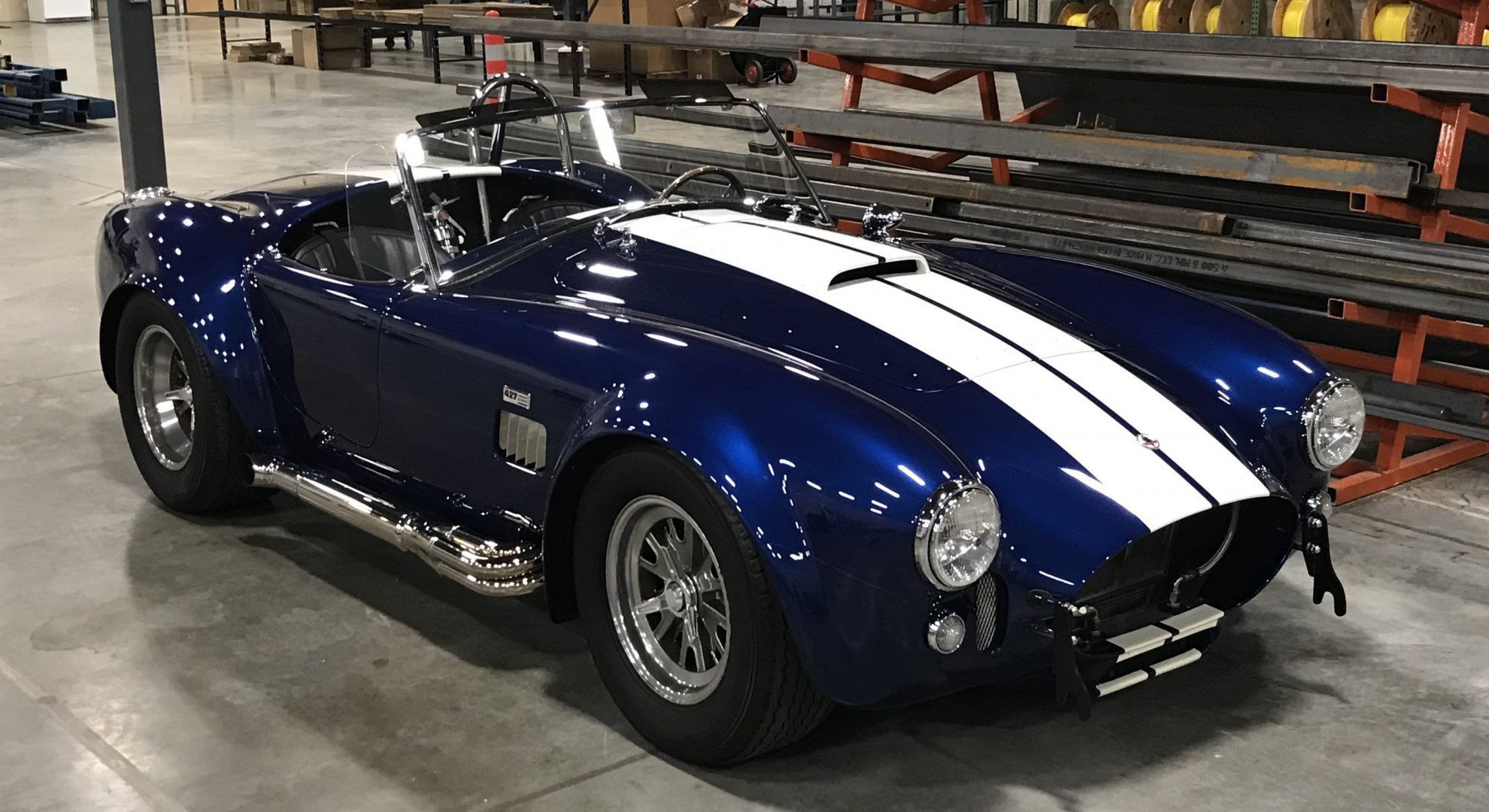

The three years was on my sidepipes for the Cobra. Here it is last year, about 1-1/2 years after taking them off for the second time and working the gold off them.
But I do not know how the headers will be yet. We will see.
