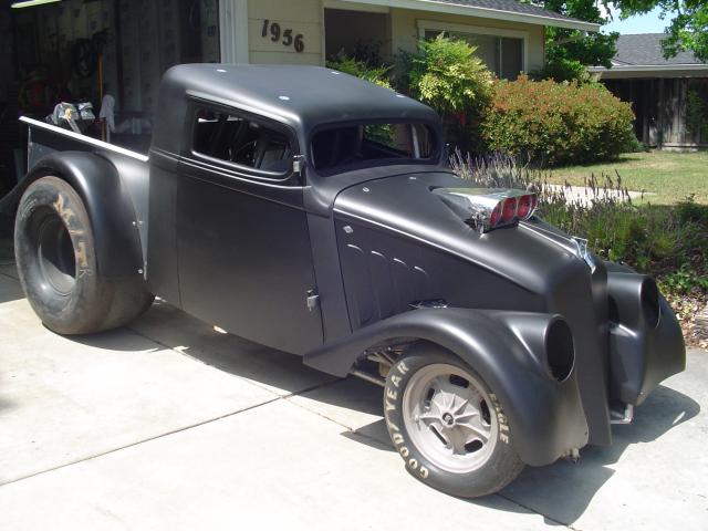

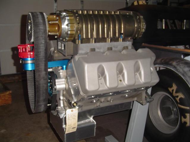

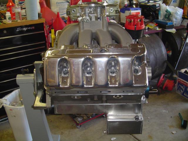

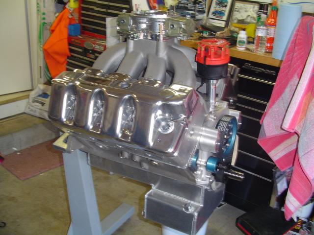

THE "Cammer" is 31.625" wide. The Boss 429 is 29" wide. I got lotsa toolz ta make 'em fit! Here are some shots of a 10.3" deck Boss 429s.

That supercharged boss looks like it would be a little down on power for a 2ooolb car.Now if you put on the lower blower pulley then it should move it along quite smartly.When I raced dirt track sprints the motors made about 750 hp and weighed about 1300lbs.If that boss motor made 1500hp(it should easily)then if you kept the car weight under 2600lbs,the car should have acceptable acceleration.........BARELY.
Actually, Egoman, The Gibson/Miller Blown 604 should make about 3,000 h.p. with 45 lbs. boost on Meth (a hell of a drug). I will probably not use the huffer and use a Kinsler EFI Stack Injector-good for a sluggish 950h.p.
