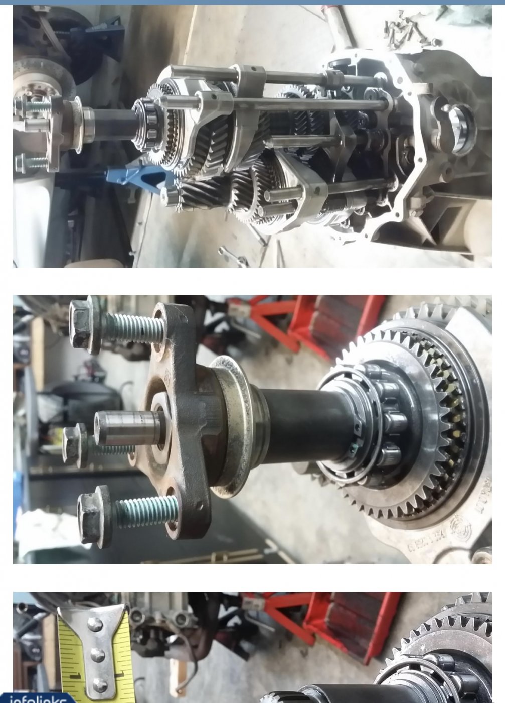

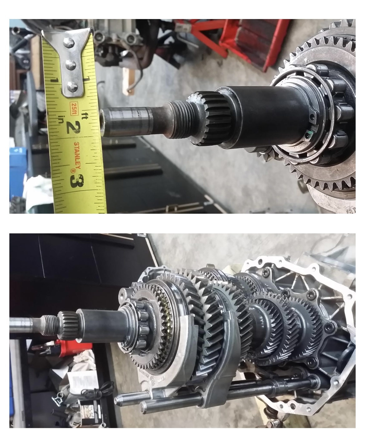

Ended up picking up another g96 transaxle for a steal. This however is from a C4. Not a huge deal as the drive end can be removed. More than likely I’ll pull this one apart, inspect the parts and if all good I’ll swap trans. If not I’ll replace parts in both transmissions and have two rebuilt trans for the cost of sending just one out.
here’s is what the 2nd shaft looks like on a C4 G96.
I’ll document my findings and more than likely do a write up, as I know this is a popular selection.
