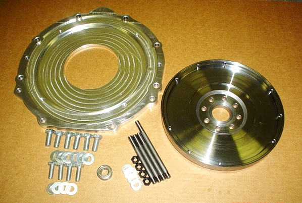

Thanx for the help all,
Joe I tried everything in you post and all seems ok, I couldn't find any scuffing on the splines, so I took the step and bought it.
the only thing missing is the release fork itself, the hydraulics are all on the box as are the shaft flanges etc etc....
it's a G50-03 1L so 5 speed non LSD and very heavy! compared to a UN1, I'll post a piccie with dimensions in the near future.
I'm Happy man. now lets bolt it up to the twin supercharged 1uzfe
Grtz Thomas
