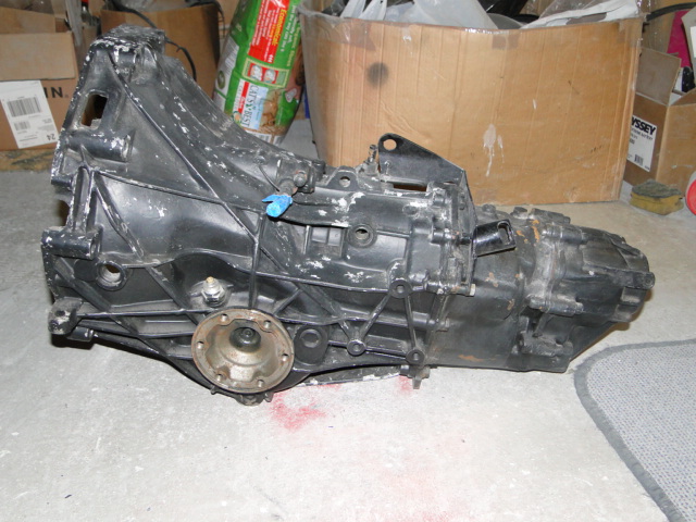

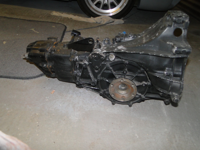

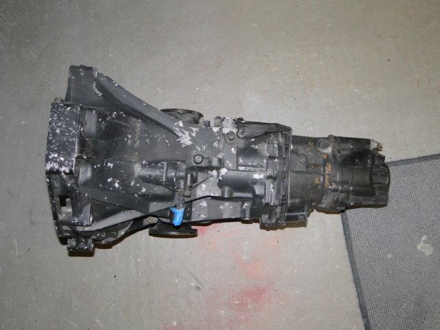

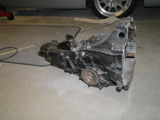

Hi guys,
Here are some piccies of my Audi tranny prior to me tidying it up and respraying it.
My question is this: -
I have no experience with tranny's at all. from the picture I have here, it seems that there is an opening into the box next to the clutch fluid drain point and that doesn;t seem right to me.
Also, does anyone know of any schematics to show me what's what, i.e. there are two sensors on there for what etc...
Please assume that I know nothing at all and treat me like an idiot, as when it comes to gearboxes, that is frankly true :o.
Thanks for you help guys.
Graham.

The hole in the left side below and behind the clutch cylinder is where the shifter shaft should be. Yours is missing. The 2 sensors are for the reverse light and the up shift light. The one on the rear is for the upshift light. There will be a code stamped on the flat area on top of the bellhousing area that will tell you what the final drive gear ratio is. It is probably either a 5N or AZZ. There are others but those are the most common.
The fitting by the left side output flange is the speedometer drive.
