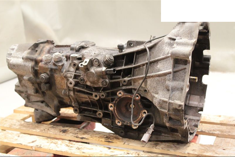

I am looking for an Audi 01E transmission.
Based on my investigation there are serveral variants of 01E, like DQS, ENU, FRG.
It seems that they all have been mounted on 2.5L V TDI and have the same gear ratios but what I have found in differences:
DQS have 130 mm Drive shaft flange diameter and 2.4 lites of oil
ENU and FRG have 88 mm Drive shaft flange diameter and 2.2 lites of oil
* Do you think 88 mm drive shaft flange is accurate, feels a bit small?
* Do they have any differences in strength?
* The picture below shows a FRG transmission and the flanges seems wider than 88mm, right?
