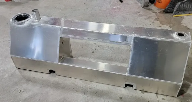

Mechanical fuel pump cable drive, custom bulkhead / tank built around the engine

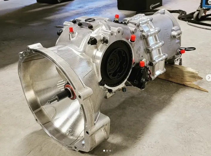

Holinger MTX transmission with geartronic paddleshift

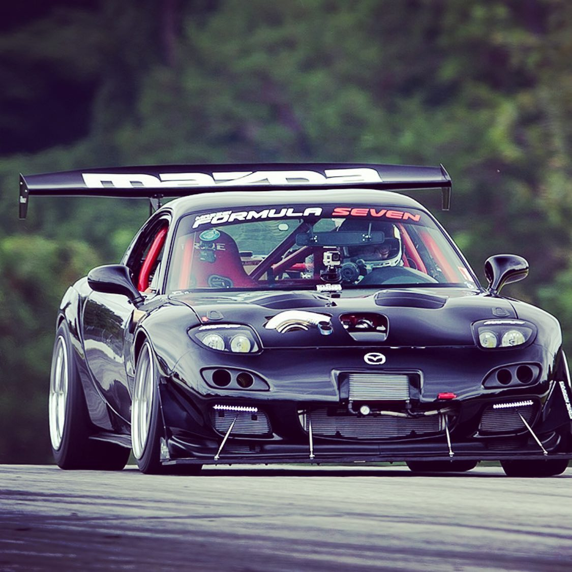

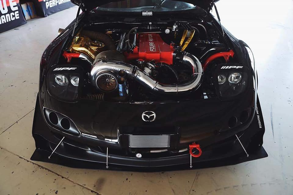

Picture of the last project, the Mazzei Formula 4 Rotor Turbo RX7

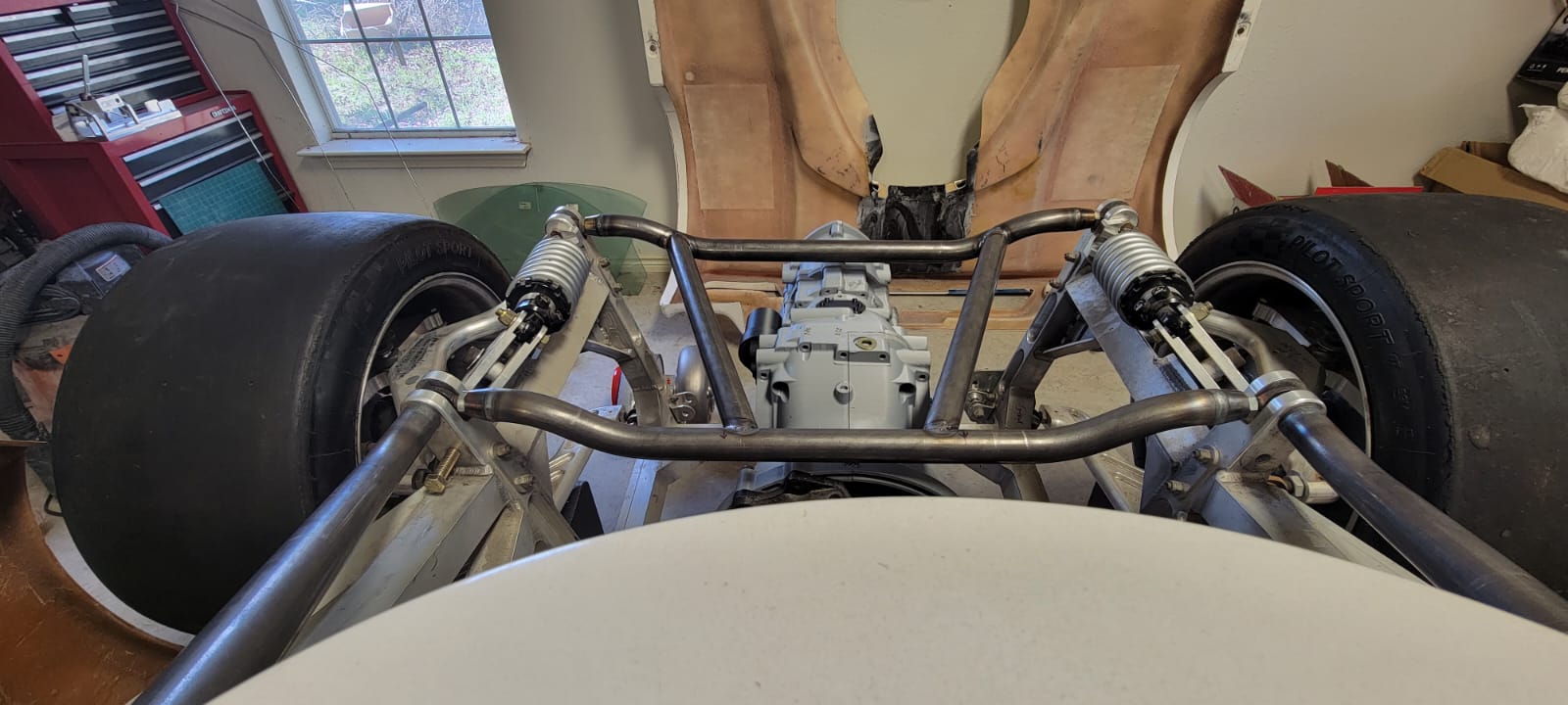

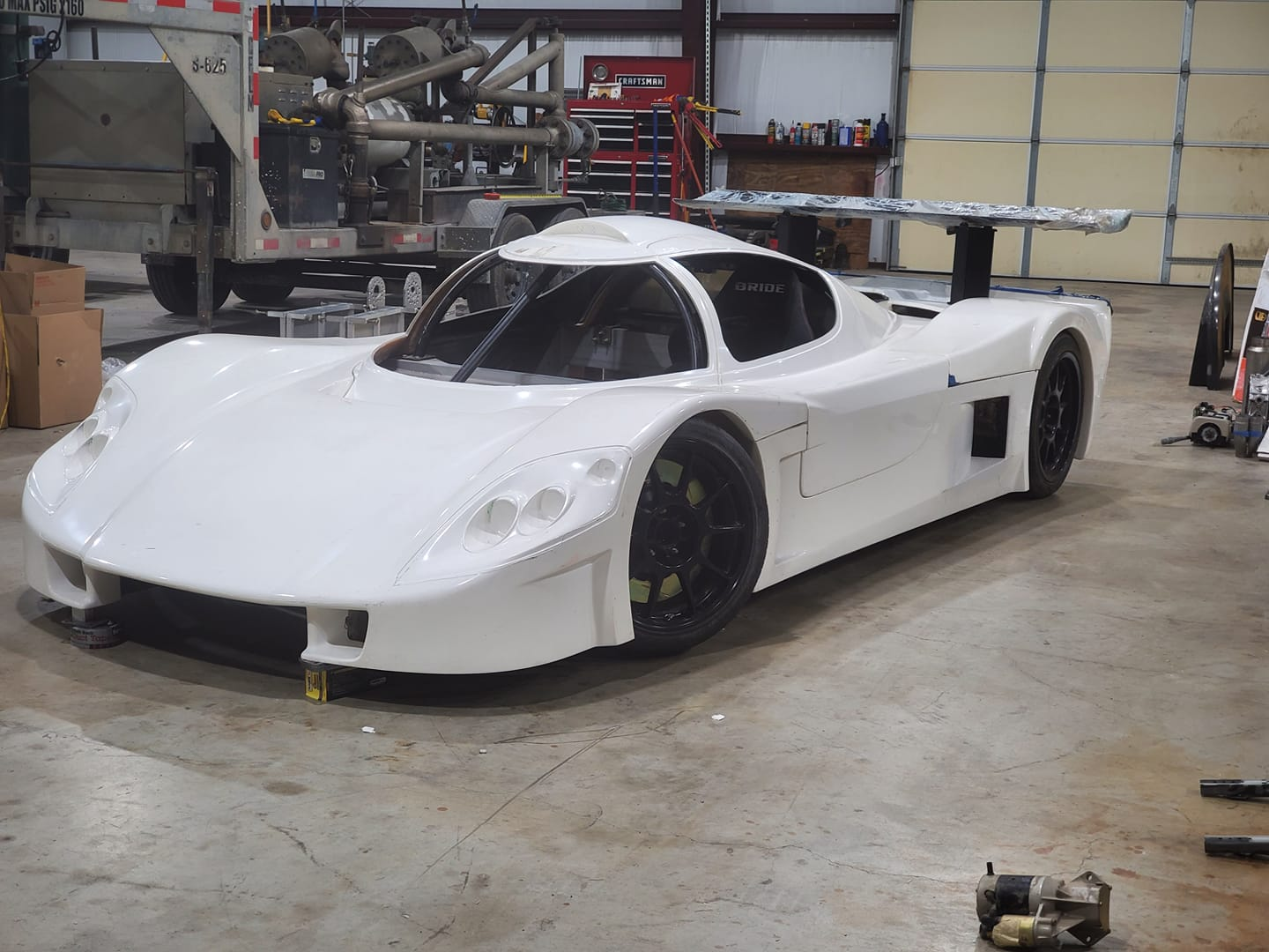

Current progress:

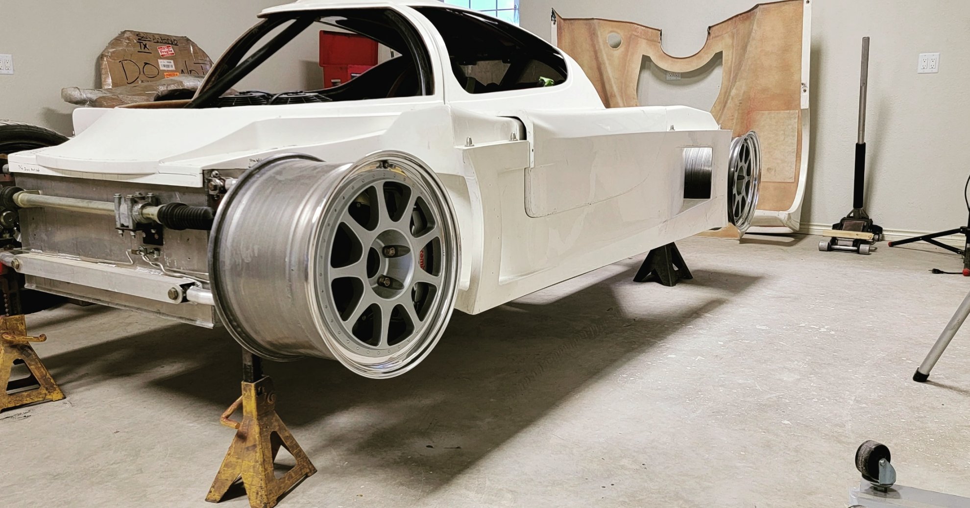

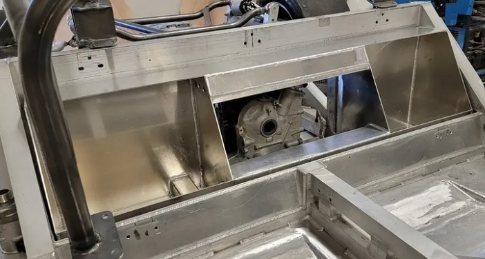

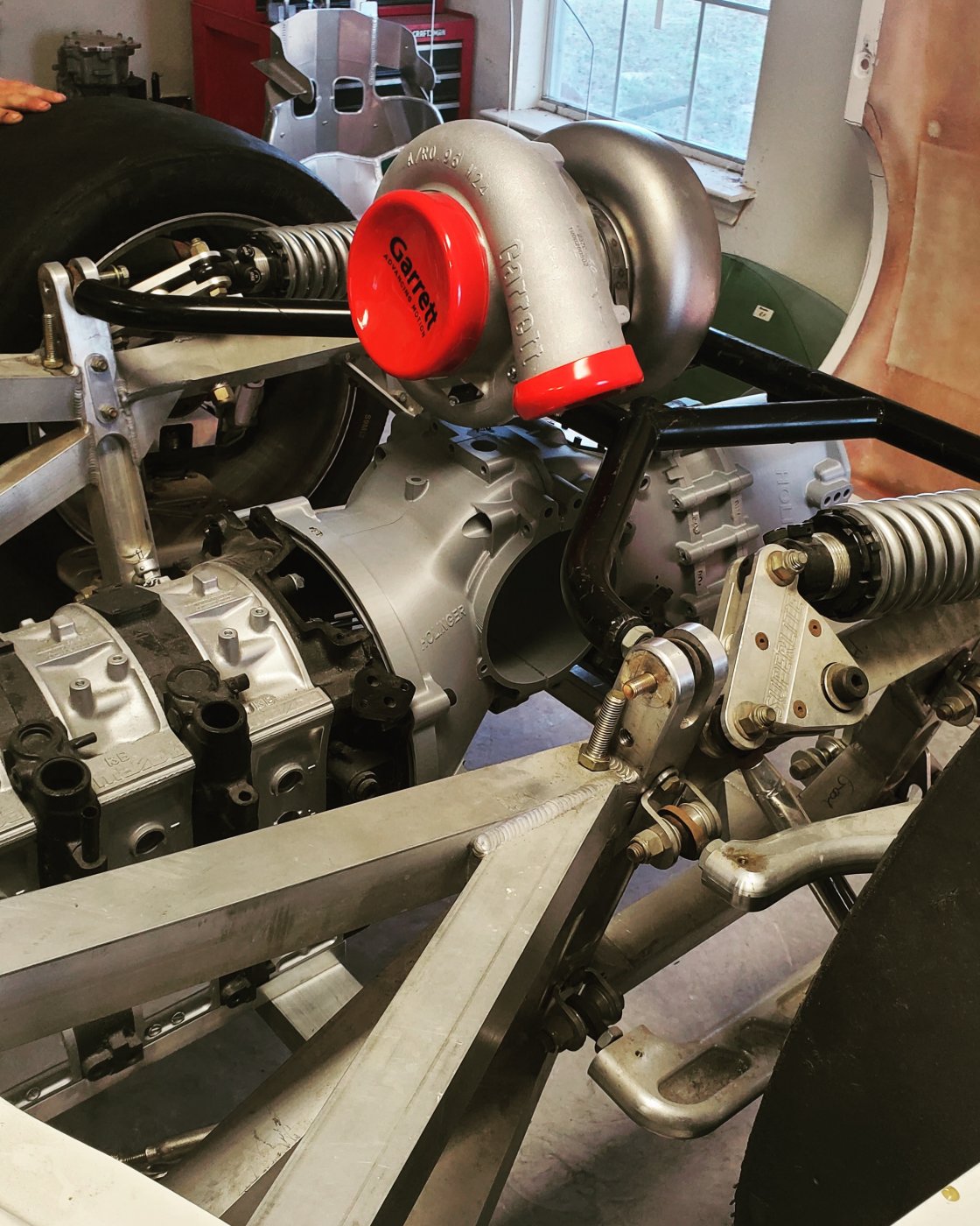

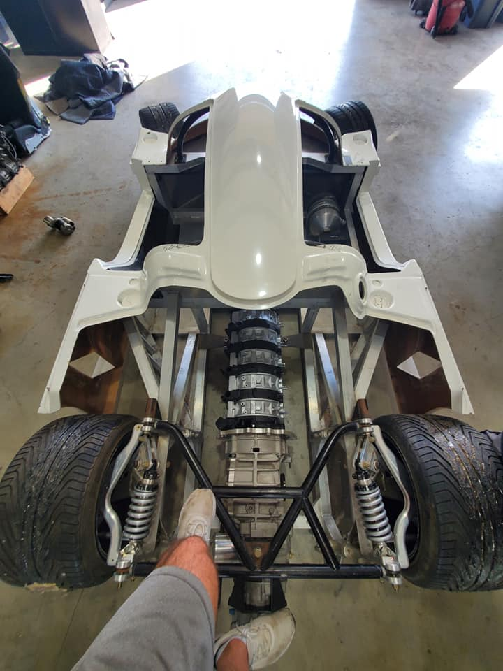

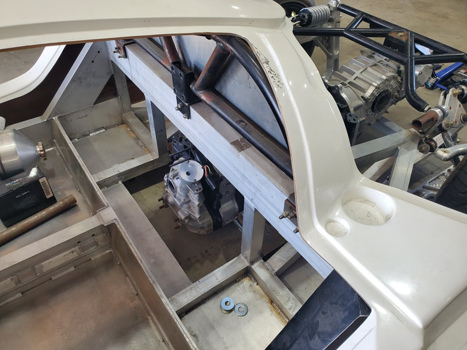

Firewall Cut, dummy block fitted with a g52 transaxle. Will be using the dummy block and transaxle until the MTX arrives from Hollinger. Dimensionally they're very similar so this should allow us to fabricate the fuel tank/turbo/manifolds etc
Body sitting on frame.

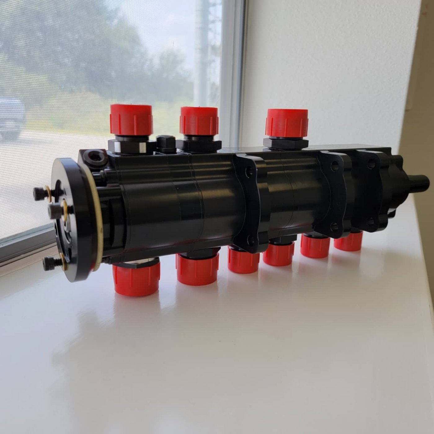

Planning to run a sump on bottom of custom fuel tank, that is equal depth to bottom of frame rail, and run a pickup up to mechanical fuel pump that will be cable drive off the dry sump pump

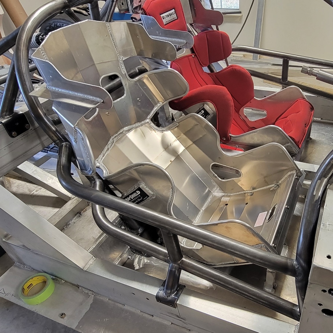

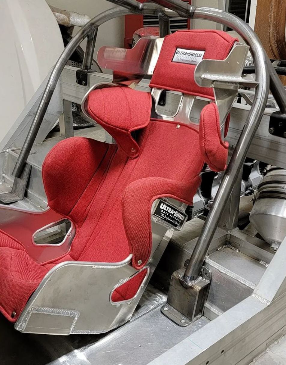

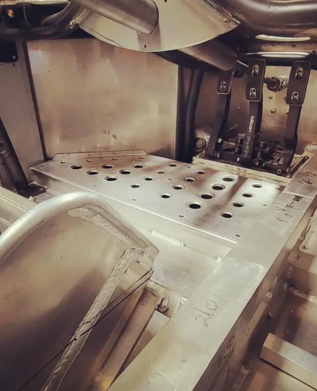

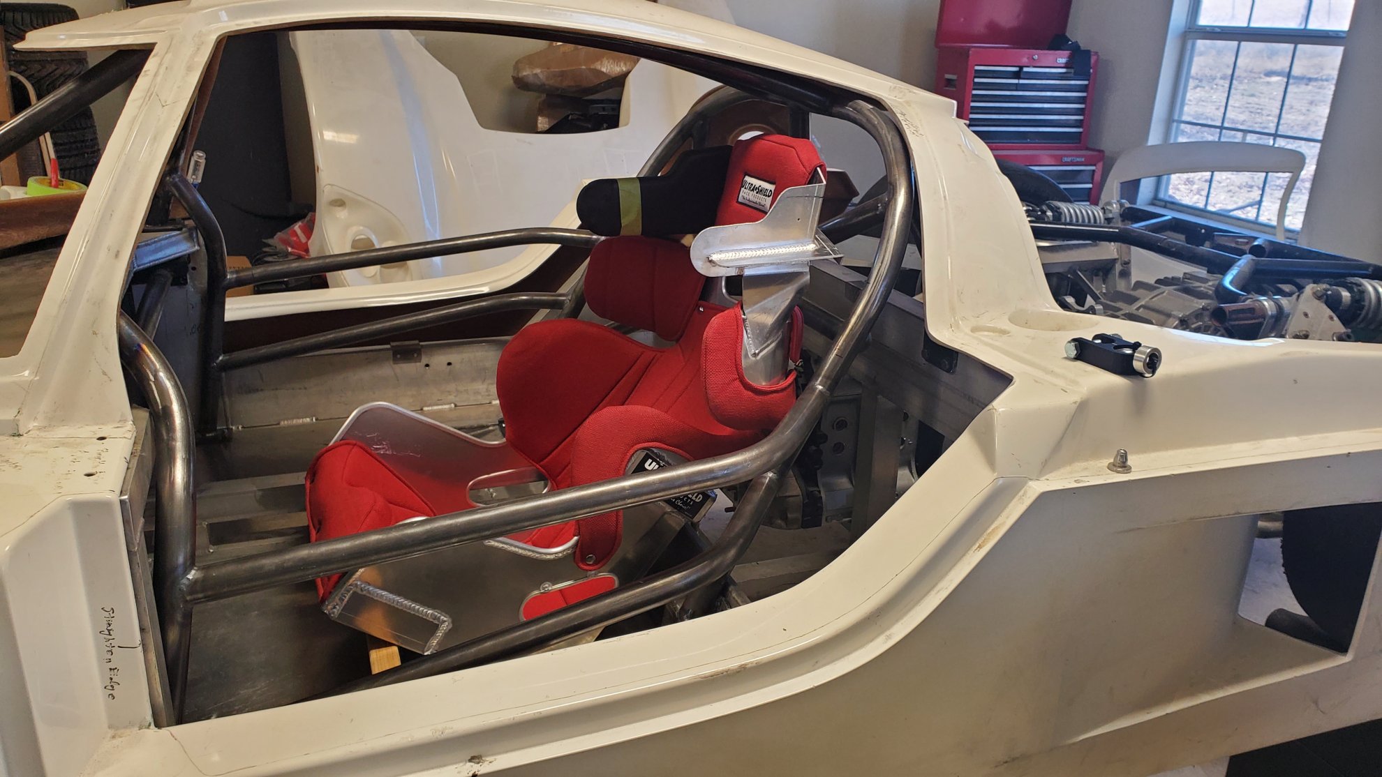

Currently just trying to source parts at the moment. Once we finally get ahold of the seats we're looking for then it should be time to finish the roll cage, mount the pedal box, steering column, and fabricate the bulkhead/fueltank(s)!

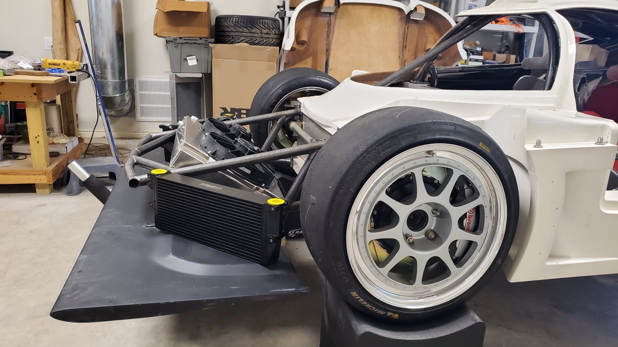

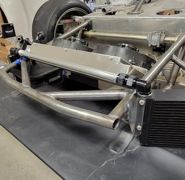

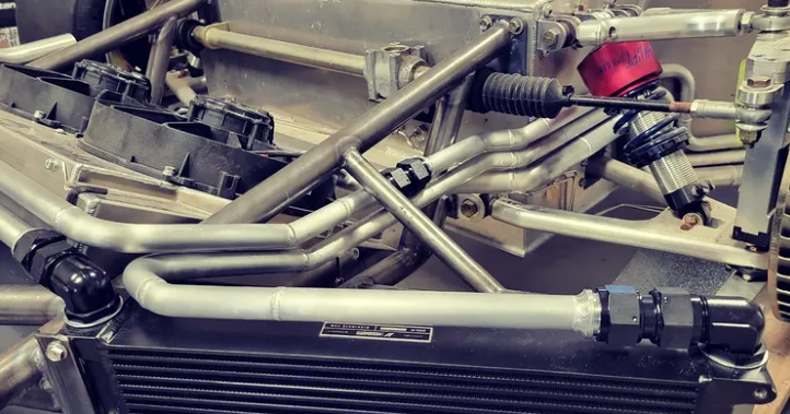

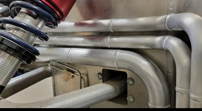

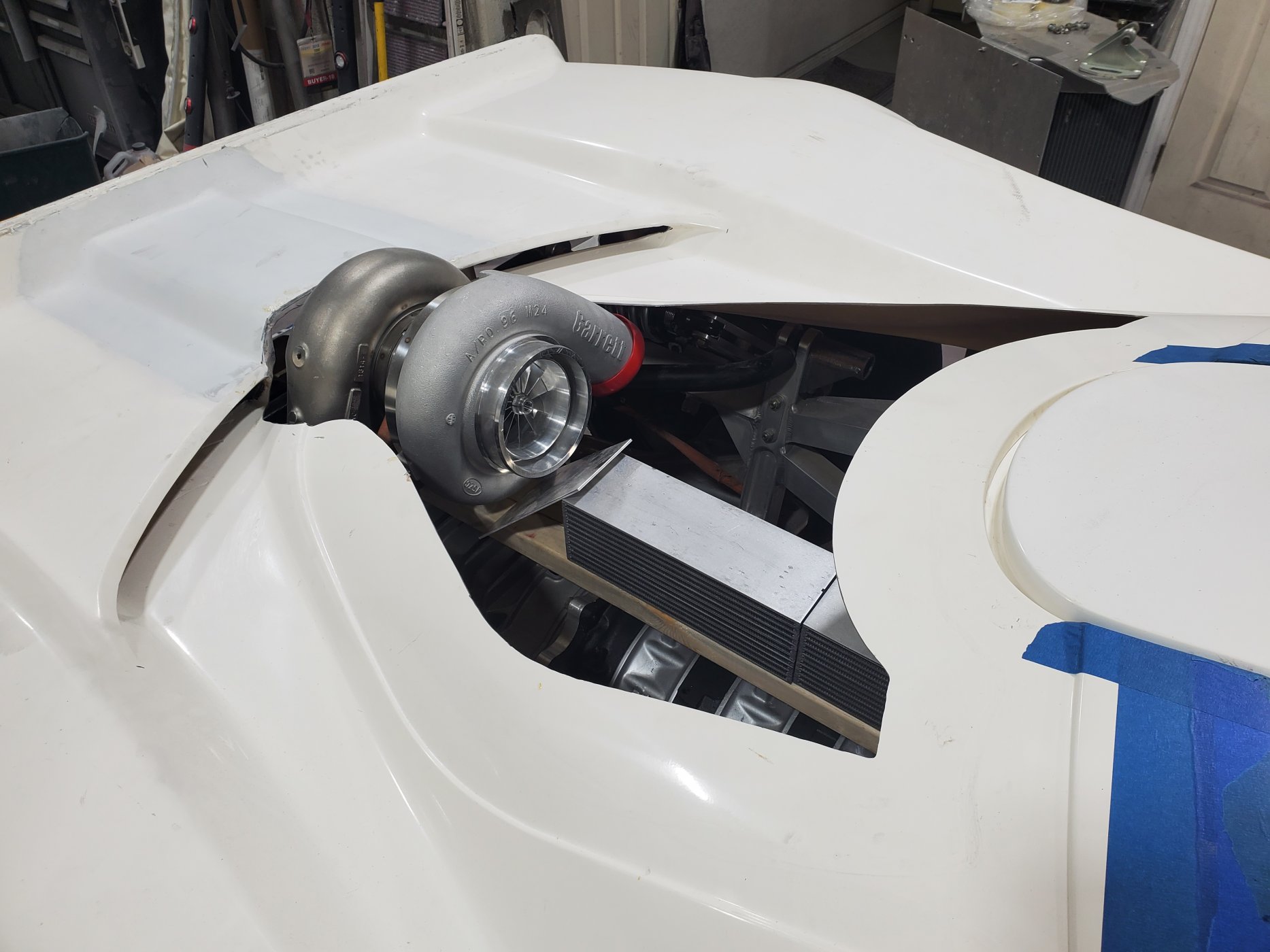

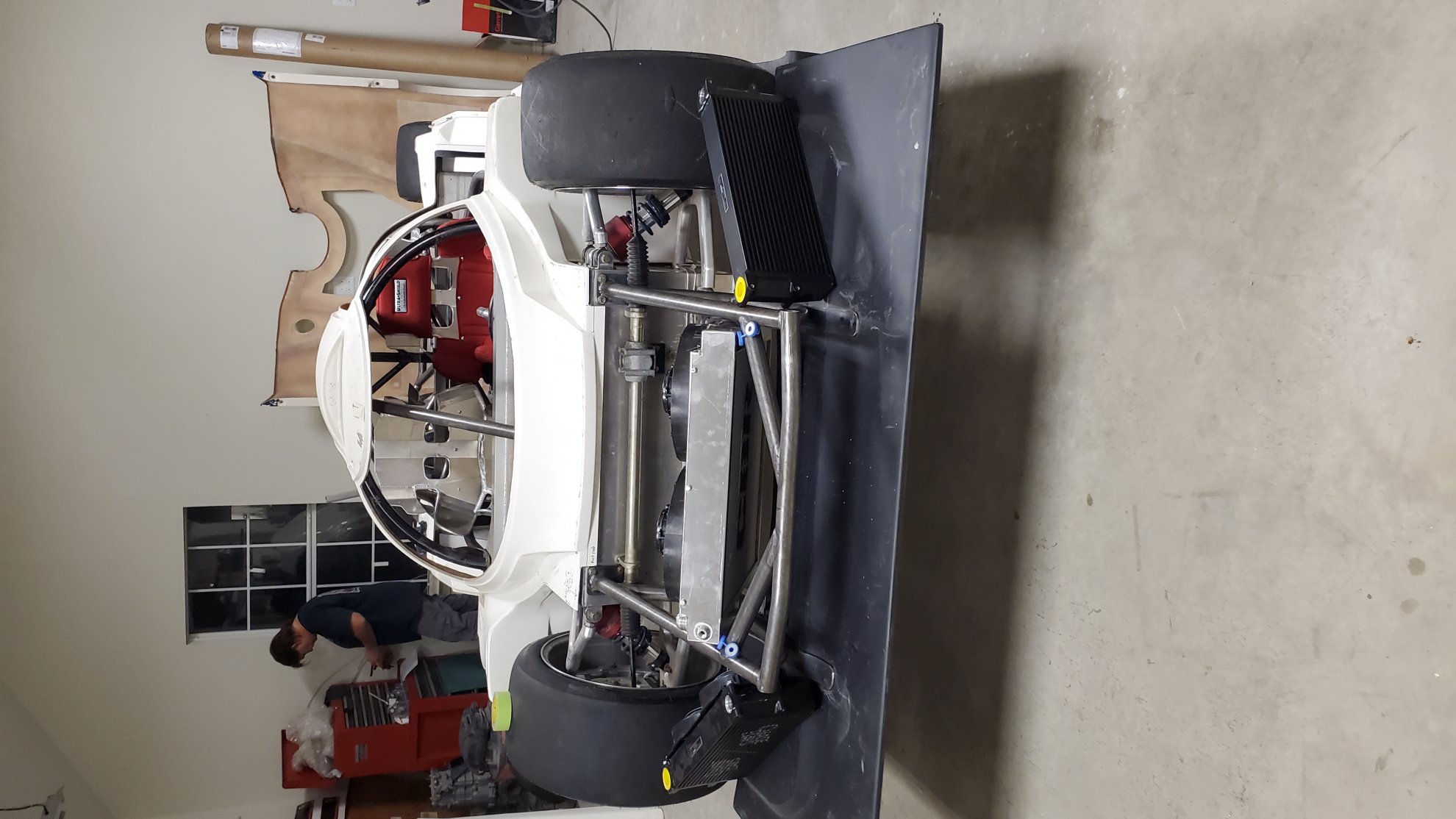

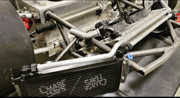

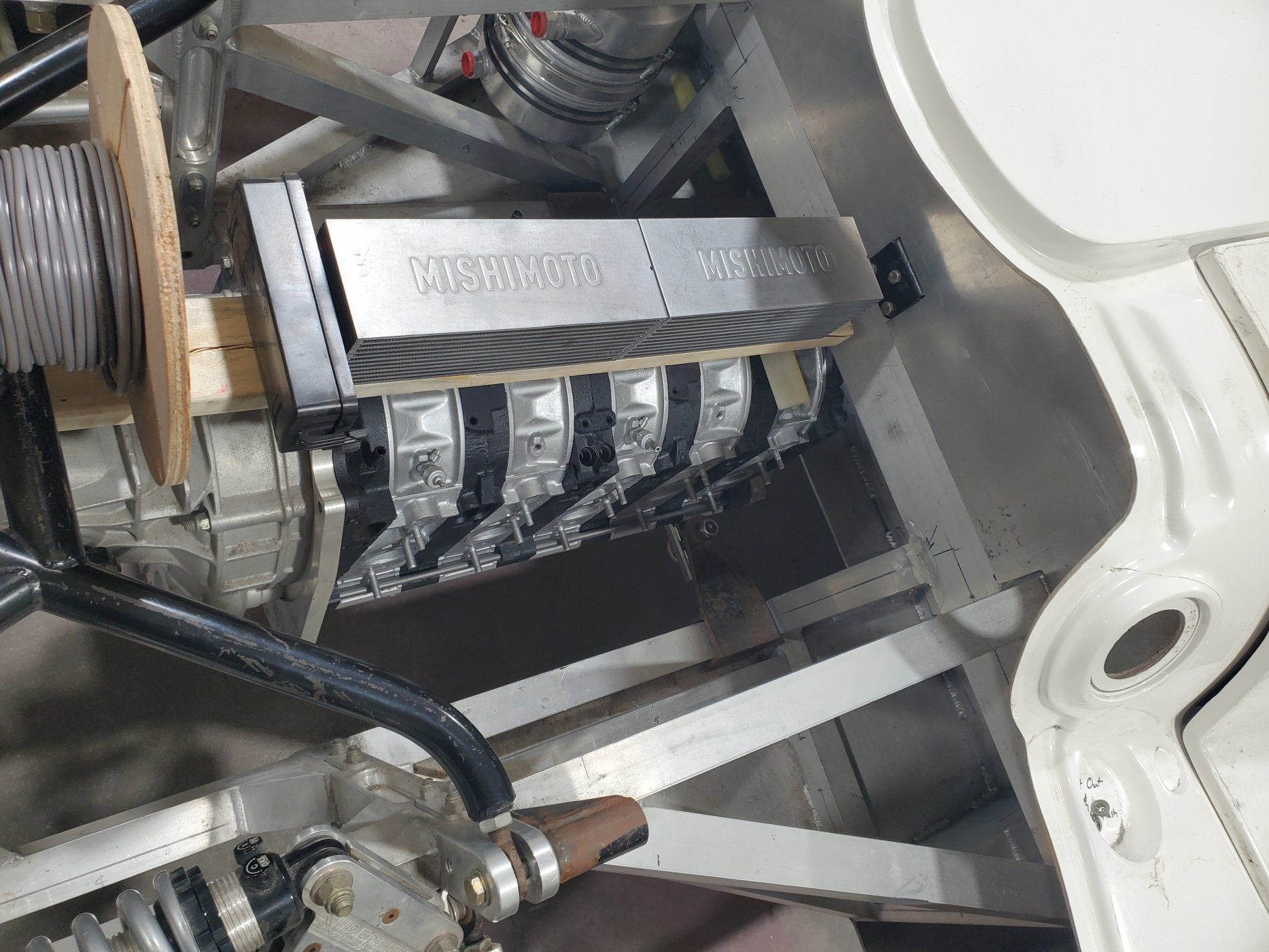

Tentatively planning to run 3x radiators on the car. Starting with 2x mounted in the rear (side pods), and 1x in the nose. 2x of the coolers will be on a circuit in a series, using two CWA400's, one for feed, one for return, to keep flow rate / pressure up, as it will have to feed through the 5 rotors, and two cores. The third radiator will be utilized for the water to air intake manifold plenum with a 3rd CWA400. All lines will be BMRS throughout the entire vehicle. Likely going with -20 or -24 for coolant hoses up/down the spider rather than coolant tubes. We will also be mounting two bar/plate style HD oil coolers with 16an inlet/outlets in the nose, on either side of the splitter. The air from the traditional brake duct inlet will be ducted through these oil coolers. We will be looking at one false headlight on each side to function as brake duct inlets.

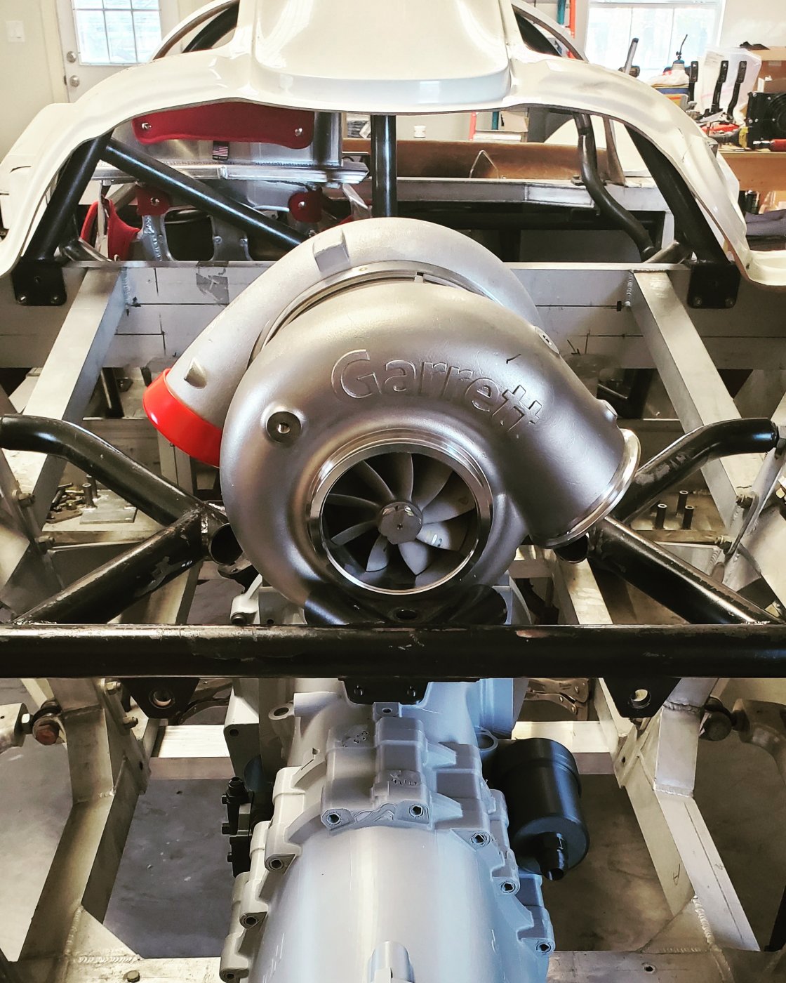

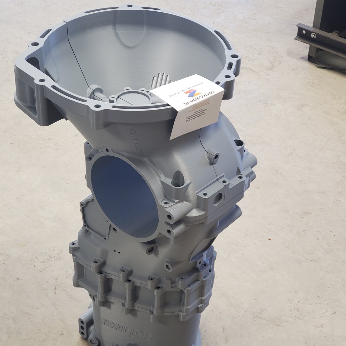

Working with Holinger to develop a clutch/flywheel and intergrated bellhousing solution to adapt directly to the rear of the engine, so that we do not need an adapter plate

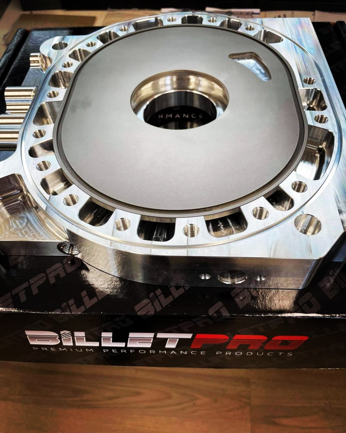

Working with Billet Pro/Promaz to see options for billet engine, at very least 3x billet main plates for the 26b style stationary gears,
Working with an aftermarket turbocharger company to develop a 118mm wheel to replace the 106mm on the G57 garrett, waiting on confirmation on my flow data, charted from the 4 rotor engine. Moving to the 118mm with the 20% larger g57 turbine over the GTX55 should perform relatively similar to the 4 rotor in terms of EMAP / MAP Ratio, EGT, spool characteristics etc

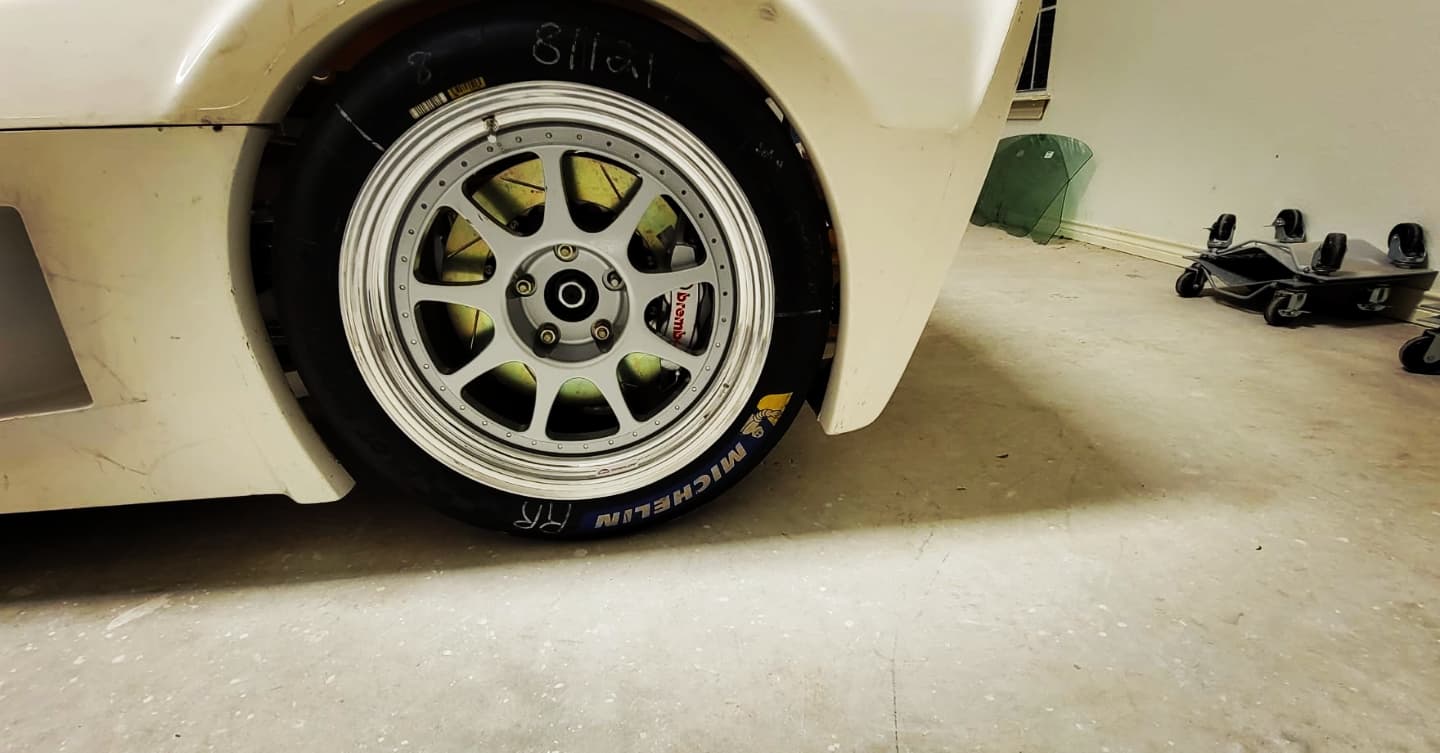

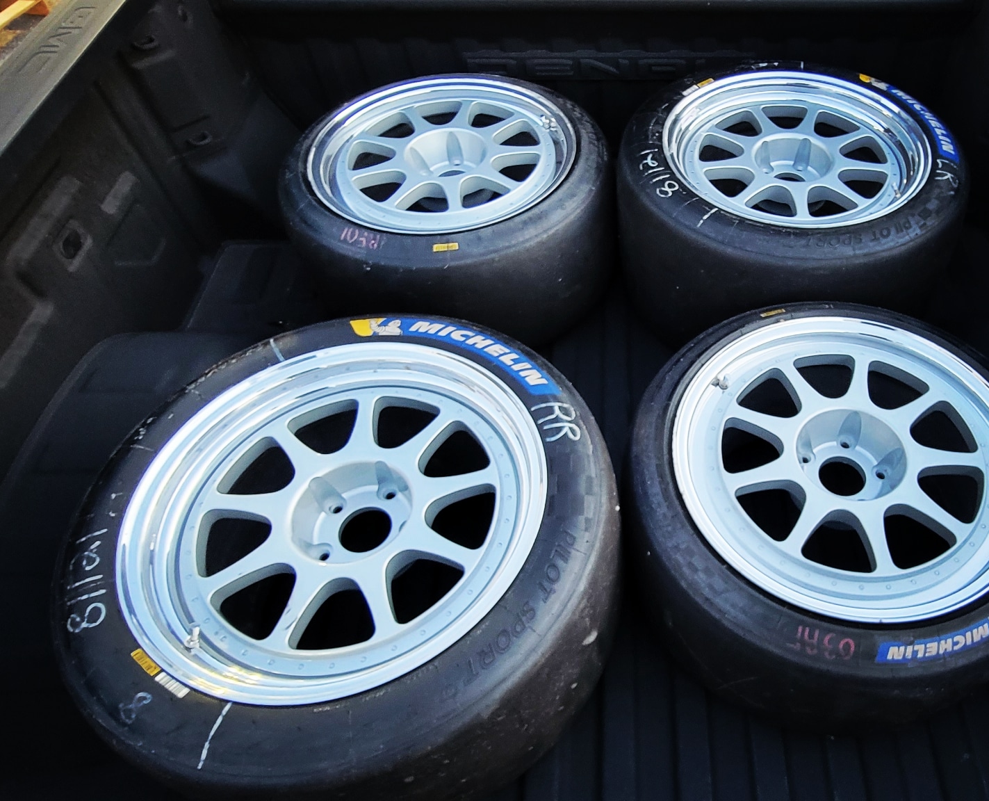

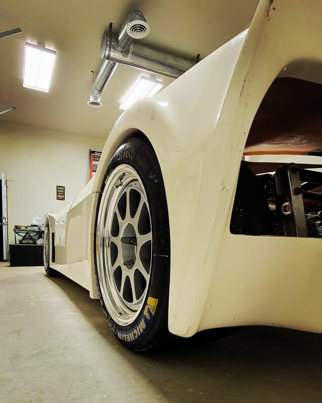

Also looking at fitting 680mm Michelin slicks, with section width of 353mm on the rear, might require clearencing the spider/rear clam a tad on the lower portions of the wheel arch,
And as we know the C4 wheel bearings aren't too trusy, hopefully at some point we can address this, maybe upgraded uprights or etc...

You can get by with the c4 stuff up front for a while. But no sense in wasting your time trying to make the c4 last in the rear. Bite the bullet and upgrade now, save yourself the pain later.

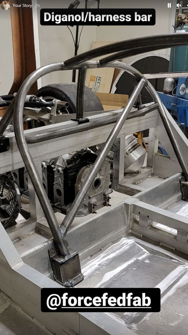

updates

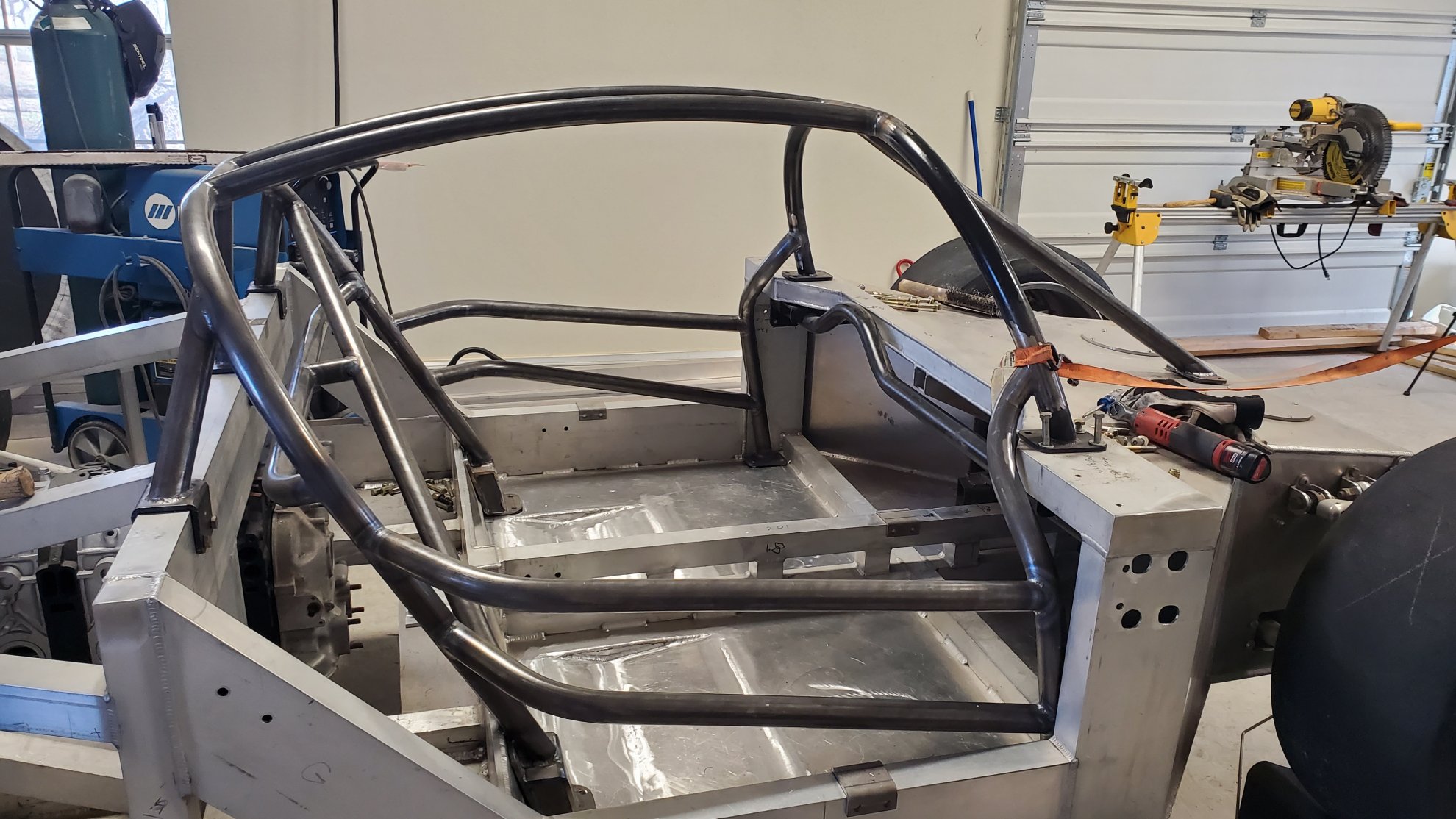

updates

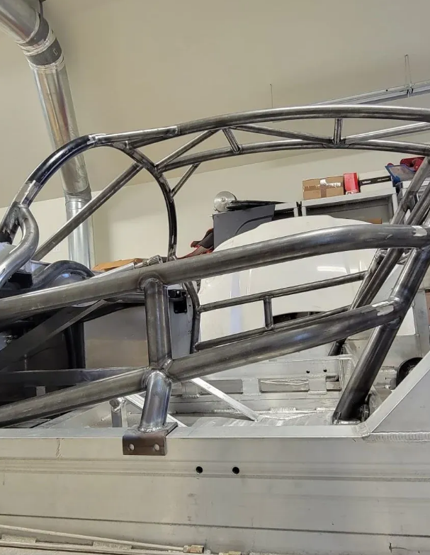

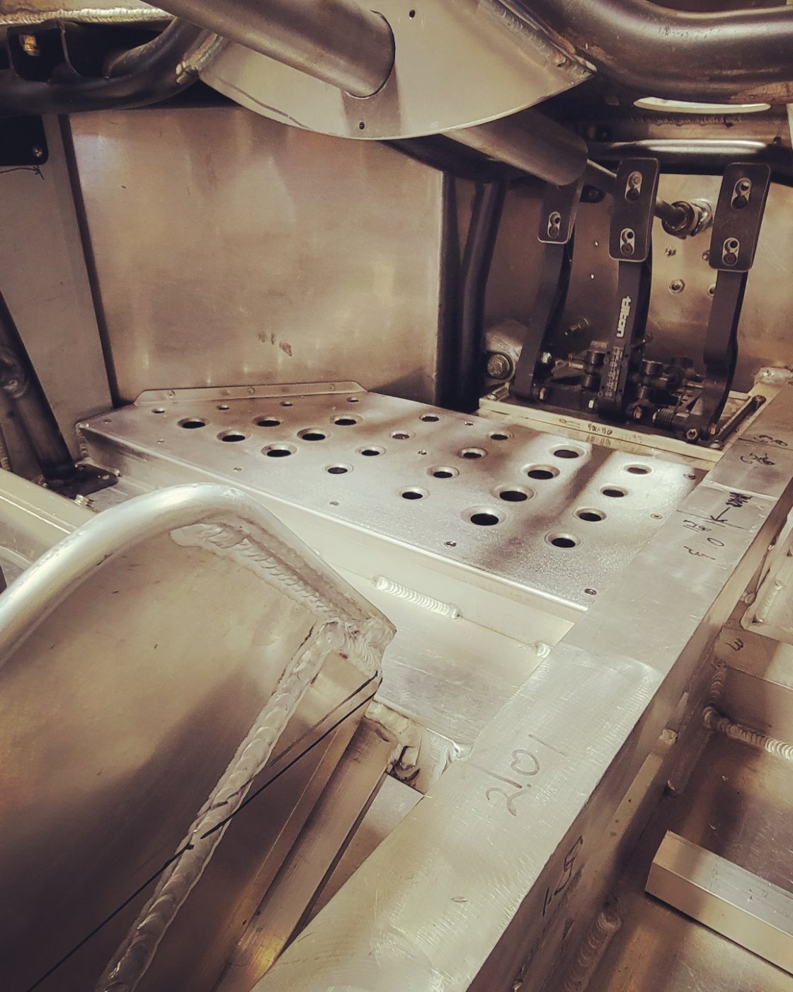

Updates
