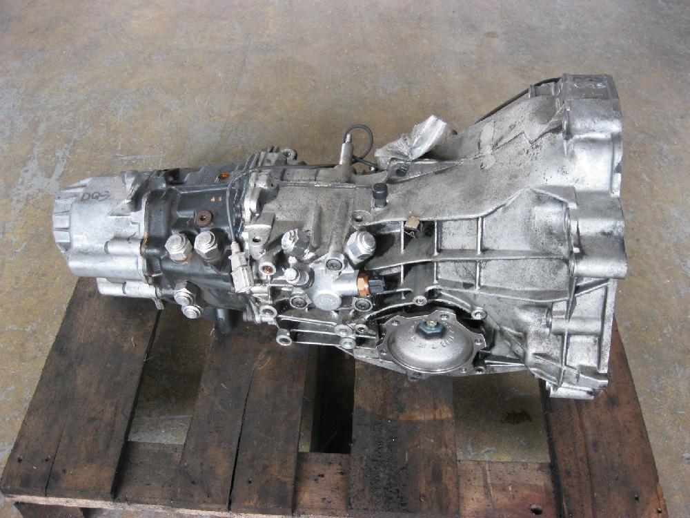

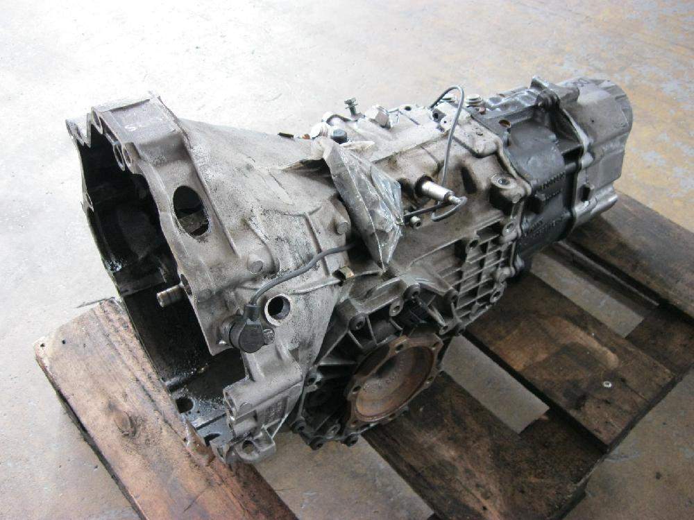

I have found a Audi 2.5 TDI 6-speed "DQS" box which i might buy.
Question; What does the DQS stands for? And do someone out there know the C-C measurement between the inner CV-joints?
/// Peter

This gear box was discussed here which had some useful info...
01E DQS Manufactured 04/01-01/02
01E ELQ Manufactured 04/01-01/02
01E FRF Manufactured 01/02-
Gearbox ratios (DQS/ELQ/FRF all the same)
Final 31:8 = 3.875
1st: 28:8 = 3.5
2nd: 34:18 = 1.889
3rd: 32:26 = 1.231
4th: 27:31 = 0.871
5th: 26:39 = 0.667
6th: 23:41 = 0.561
Rev: 38:11 = 3.455

DQS is the gearbox code. As RUFAZZ says it means its an 01E, it was one of the ones on my short list but I ended up with the slightly later model FRF. I've got a manual for them if you need any other information.
