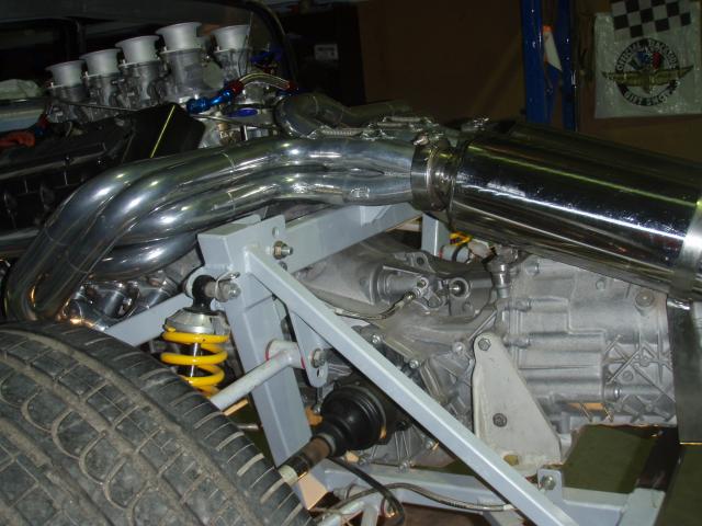

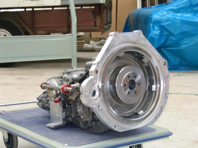

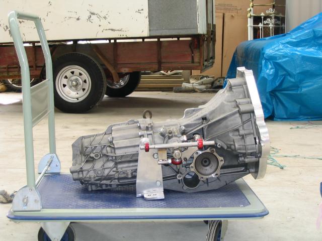

I have an A02 box in my car all alloy housing 6 speed rated at 380nm,i beleive it came out of audi a4 or a6 diesel.
It is shorter than an 01E with similar ratios and weighs about 63kg.
cheers Ali
cheers Ali

Hi, have not tried it out yet my motor is just being wired up to computer.
calculations say 6500rpm should equal around 320kph not that i will have horsepower
to do that ,i will only have about 330hp.
cheers Ali
