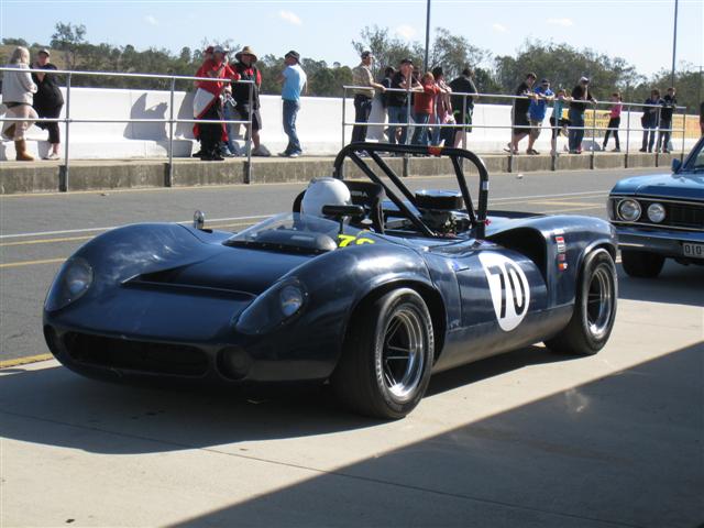

Awesome! Glad to see you out in it! Do you have some pictures of the completed car with detail shots? Would like to see what she looks like in the final state.
flatchat(Chris)
Yep, easy to drive --one handed through corners whilst changing gears and waving to fans along pit wall:laugh:
950kg wet & ~=400+ at the wheels
Don't over do it!
You've got us on power by a lot - about 150 rwhp at least. Our weight seems to be almost precisely the same, 954 kg, except for you're counting driver in your wet weight, correct?
