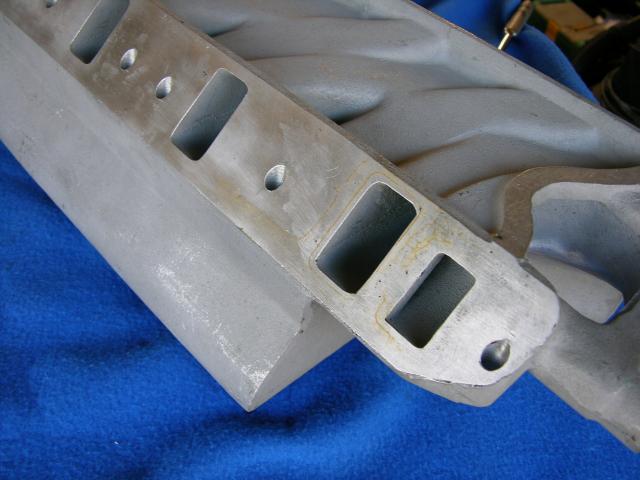

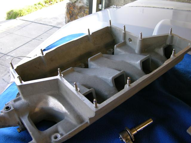

I haven’t posted in a while. Been busy with work and when I have time to tinker with the car I’ve been away struggling with my 48 IDA Webers and linkage and stuff. Anyway the photos here are of the Shelby RamBox in both 4V and 8V configuration tops. This manifold was produced for the 289/302 in 1969 and marketed under AutoSport Products Inc. As everyone knows Ford focus for TA racing was on the BOSS 302 after having a dismal season with the Tunnelport 302. I can’t really understand why this manifold was produced with the exception for Drag racing as where it was marketed for. Very few people know of it, even fewer people have seen it. And only handfuls have tested it. I know of only 1 person who actually races with it in Vintage TA racing. I so happen to own it with both tops unmodified and was going to run it in the single 4 barrel configuration as a 331 stroker in my toy car until changed my mind and fuss with these Webers. 8.2 deck block (new M-6010 BOSS302 block) ported C7ZE hipo 289 heads. The base can be fitted to a 9.2 deck block via the 351w adapter. One could even fabricate a top to accomodate the Autolite inline. Anyway I just wanted to throw this out there. To let you know the photo is relatively current here it is on the trunk (boot) of my SLK55.

Interesting & Rare piece of Alloy you have there Earl, The center pic gives a good idea of the (large) plenum volume, especially on a 289ci motor. would require a healthy accellerator pump shot to get things underway alright & would be fairly sluggish in the lower RPM range, you can compare with the Boss 302 manifold in James earlier post and see the reduced volume in that manifold. be interesting to see the coolant flow rates for L&R banks with that runner design from LH bank. Thanks for pics.
Kelly
