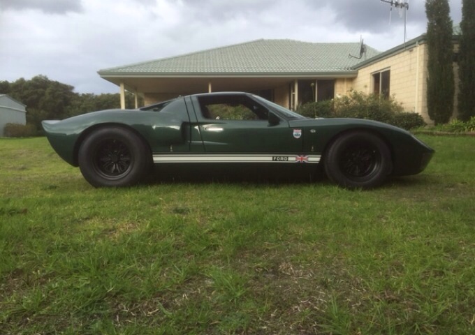

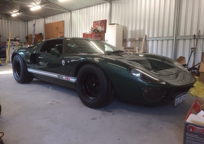

Got the Avons and new wheels fitted. I still need to set ride heights but very happy with the look.

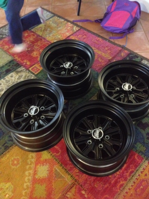

The Wheels are from Image in the UK (GTD5). I had them custom made to suit RF offsets, I wanted 5 stud bolt on because I plan to do some racing and feel more comfortable with that config than spinners. I have since taken the Image logo's off the wheel centre caps. They have nice deep dish front and rear and the quality and finish is excellent.

side shot with ride heights set. Avon are great tyres. Get them on your car you wont regret it.
