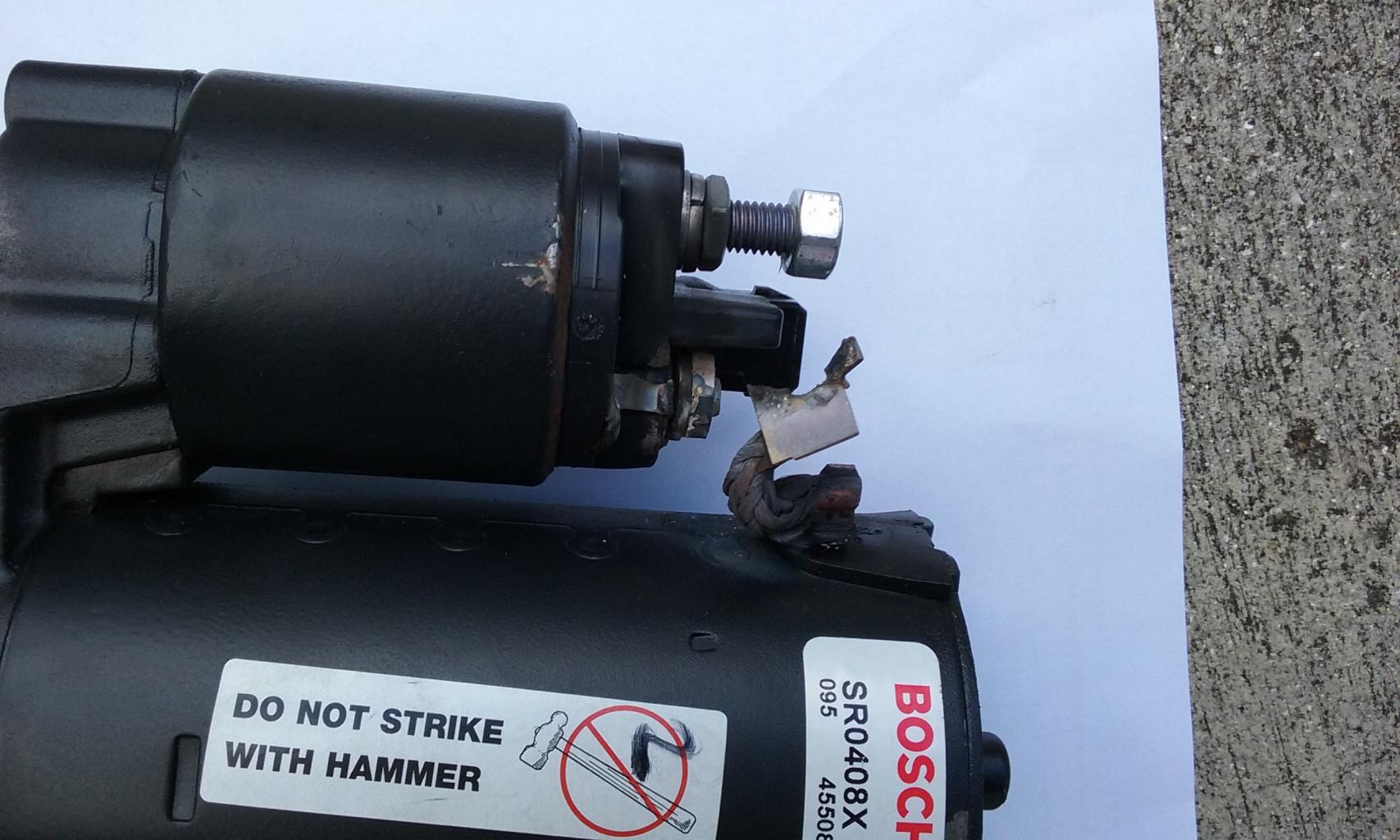

Joe I had exactly what you are describing. Cranks like a spin dryer when cold, sounds like it has a 9 volt alarm battery when hot. I spent an enormous amount of time on this problem. Increased the Battery cable to 2/0 gauge, tried a lead acid battery, jumped the isolator switch and another new starter motor. Same result after all this. Same result with a very large marine cranking lead acid battery 3 feet from starter and connected neg and pos directly. With a start button when the engine and trans are cold a press and the engine runs. When warm this does not work but a quick press and release then a press and cranking is like cold. I find it quite practical to drive the car like this but I would like to get to the bottom of the problem As I have changed every component used in a crank for something different but could only try another of the same starter I am left with the conclusion that the starter is the problem. I have an effective heat shield protecting the starter.

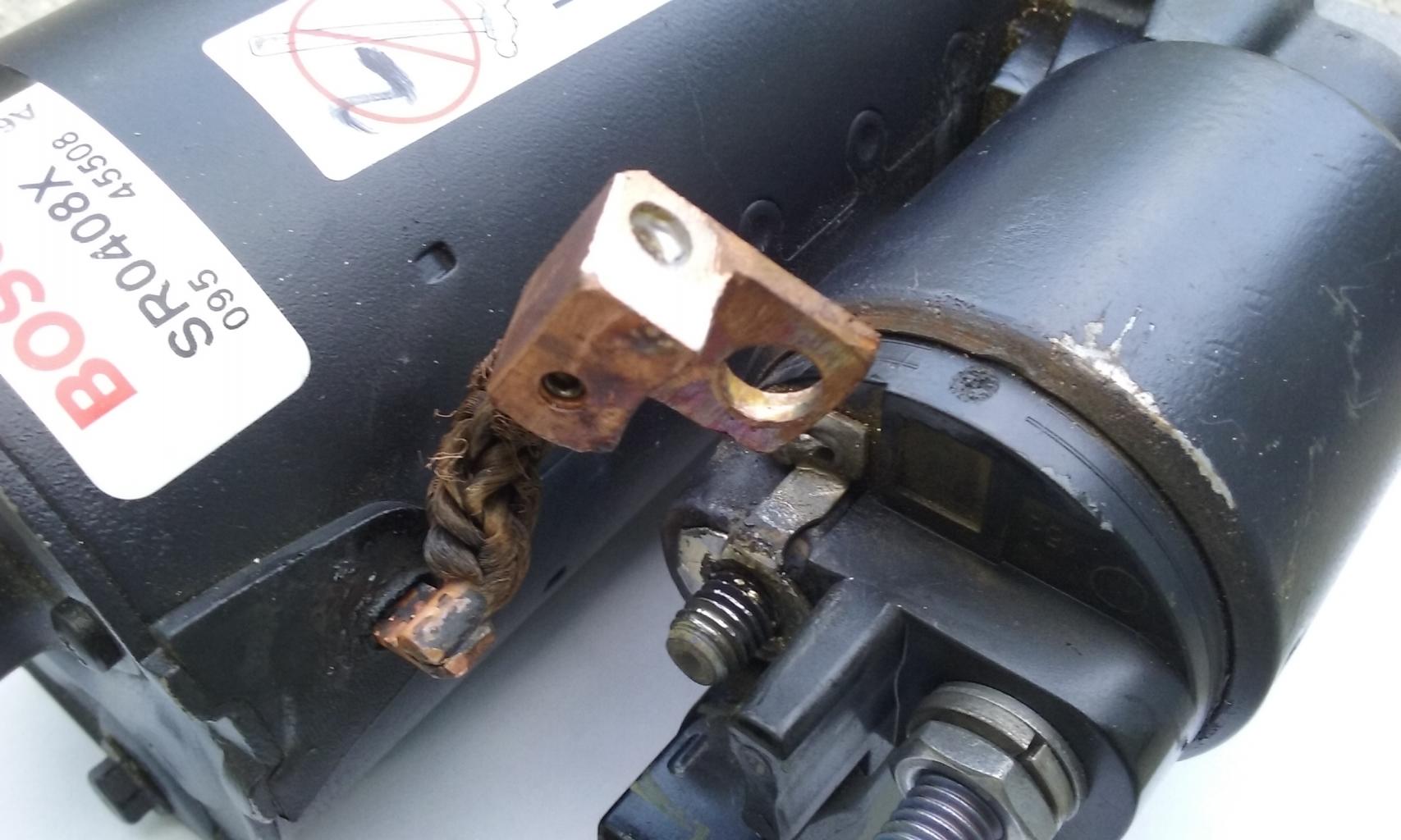

Since I posted this I had the brass tag on the braid between the solenoid and the starter motor melt through completely. This happened when cranking with a warm starter motor. I had noticed that this connection got unusually hot but took it that as it is a part of the whole starter assy Bosch know what they are doing. They do not and probably get away with this on easier cranking jobs. This tag is very thin for the current it has to pass. Of course when it is hot the resistance in this tag just amplifies the problem and eventually results in the meltdown.
I have attached photos of the melted tag and the copper block I made to replace it. The volume of this block can handle the current properly. I have not evaluated this work round yet but have confidence.

The melted Bosch connector on the braid was the result of hanging on the start button for too long. Have not had that again with my quick press instantly followed by a normal cranking press which gets me great cranking and a clean start each time.
