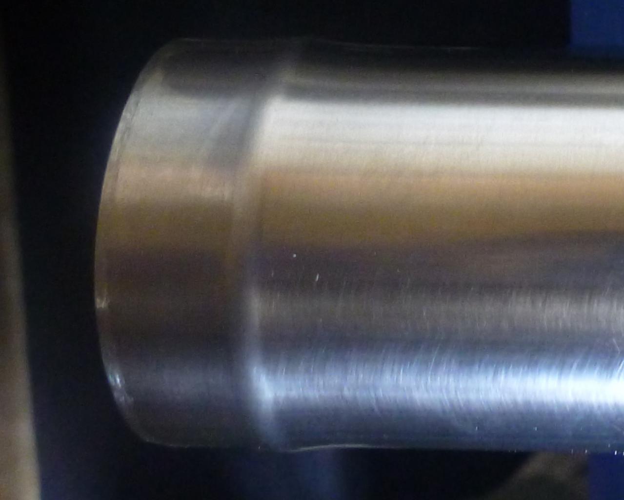

What wall thickness SS are you using? Hopefully not the heavier .049" or .065"...
The bead formers did a fine job on .035" 304 Stainless, which I used on my RCR over the supplied aluminum tubing. You don't need much....
Tom

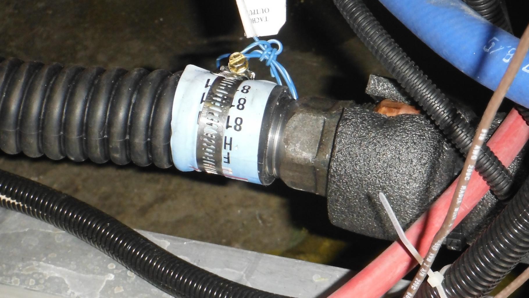

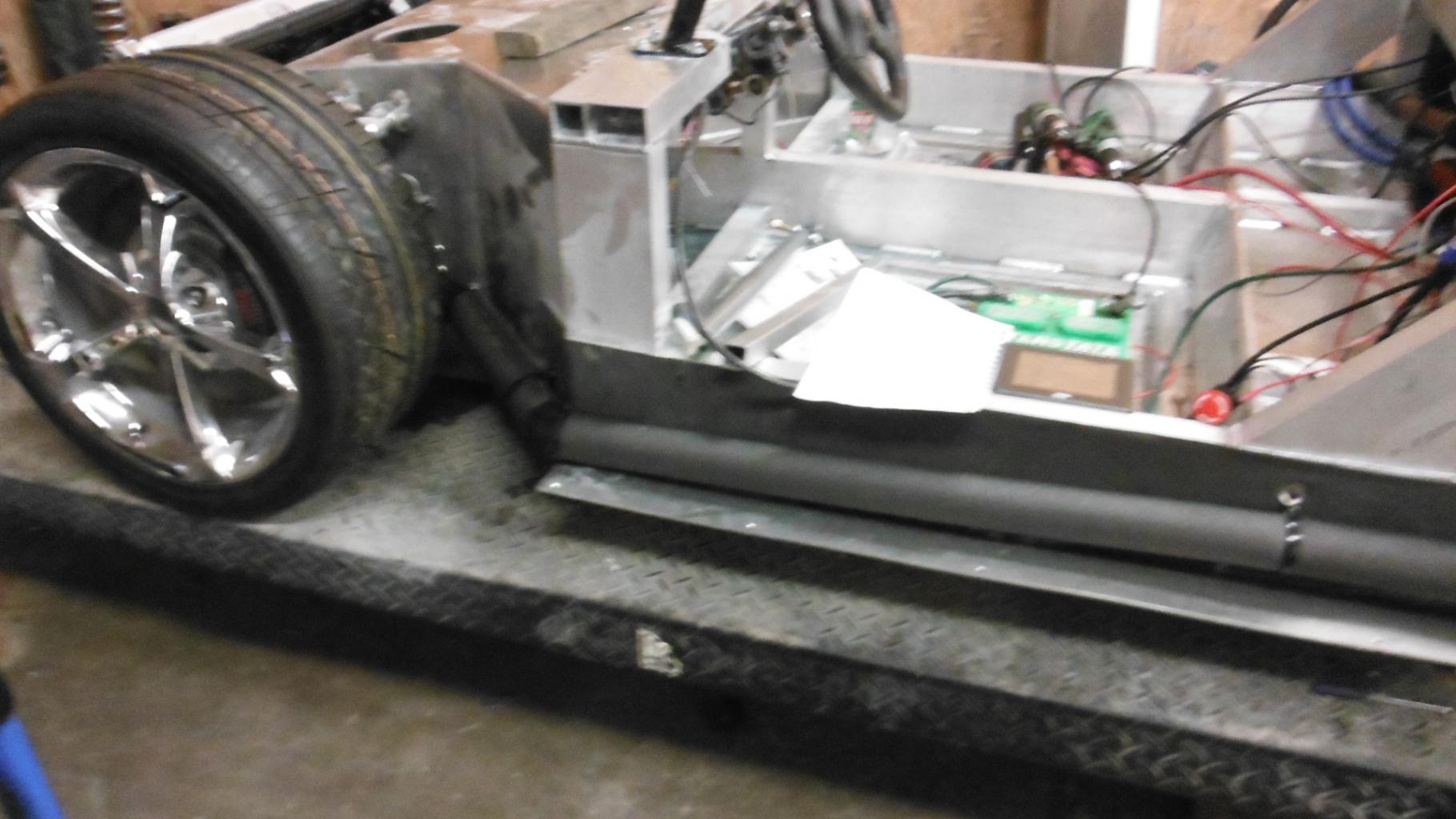

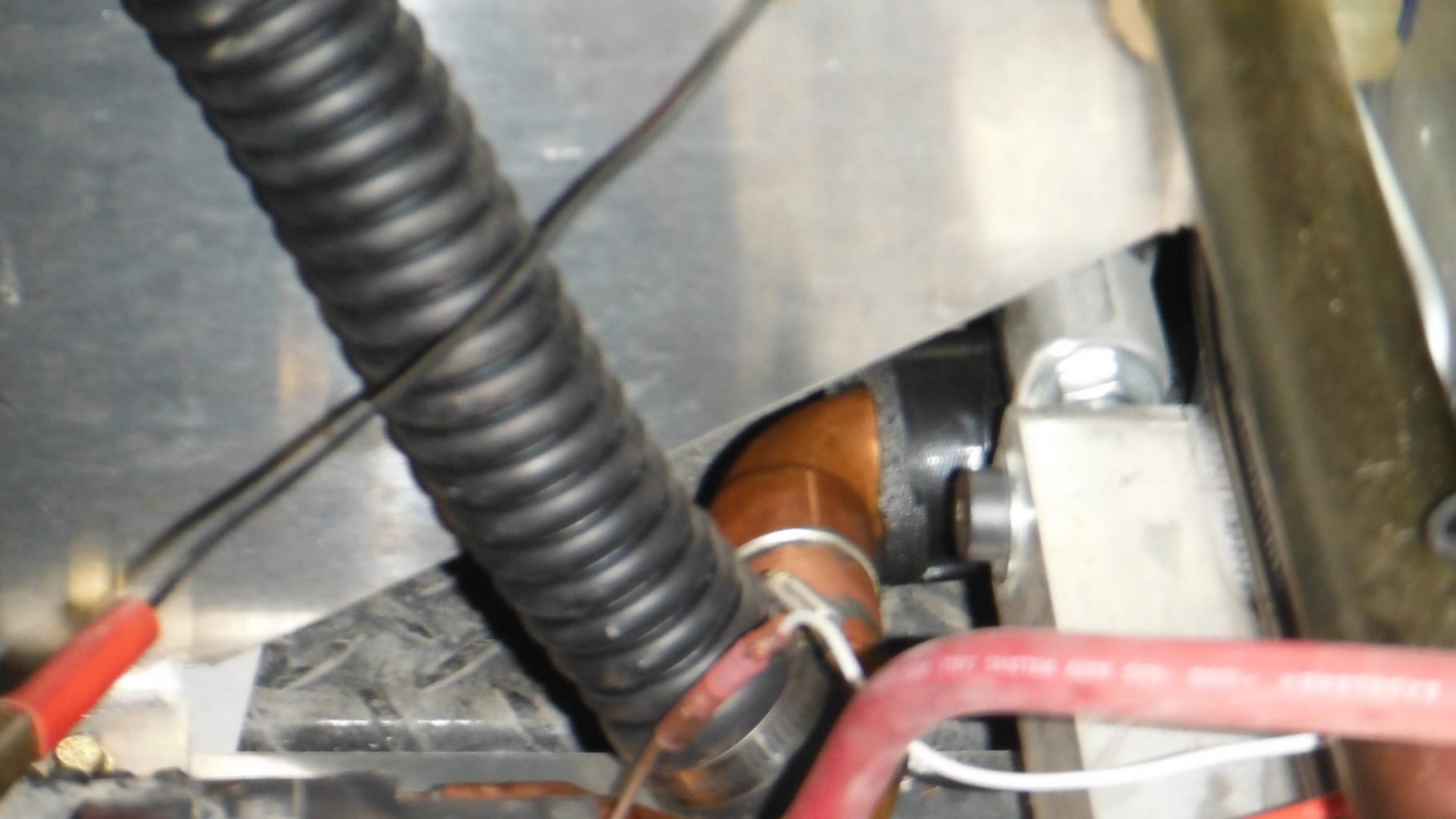

I made mine out of copper pipe, hose connections into a female adapter for the radiator hose. McMaster Carr has all those fittings for hose to pipe thread and just soldered them together.
Im not a good welder, im a B G welder, blob and grind so I can solder pipe, so that how I did mine.
