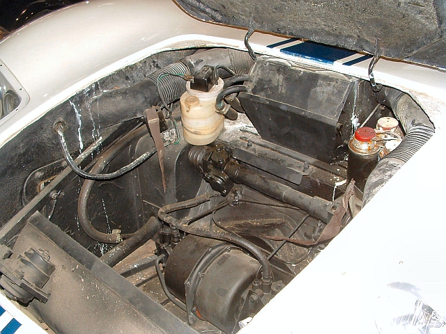

JimmyMac
Ian,
The MK III had a spoiler fitted in the lower front.
In the photo you can see where the two scoops touched the top of the rubber seal on curved plate.

JimmyMac
Ian,
The original set-up probably worked OK with just one of those old Kenlowe fans as seen in the photo.
However, it will probably be much more effective with two modern pulling fans such as those you chaps are currently using.
I really like the idea.
