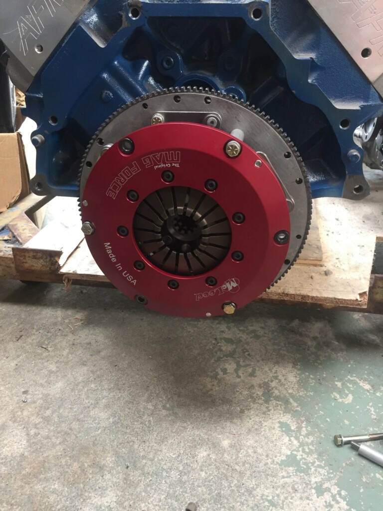

McLeod aluminum flywheel and organic/ceramic single plate clutch. I think that's their Super Street clutch. You may already have that in your car. Just make sure to get the correct RBT input splines (which are BMW ones). McLeod's # on that disc is 272180R
