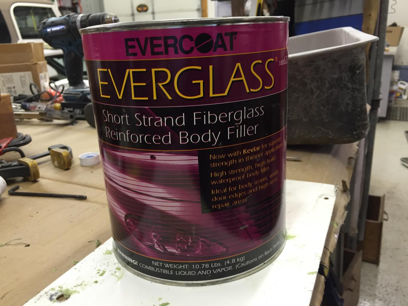

I don't know if it is available across the pond, but I'm using Evercoat's Everglass product which has both fiberglass and kevlar in it.. I've not heard of a filler with Carbon Fiber in it, but that doesn't mean much...
I've heard this stuff called every name in the book:
Kitty hair, tiger hair, bondo glass, etc....

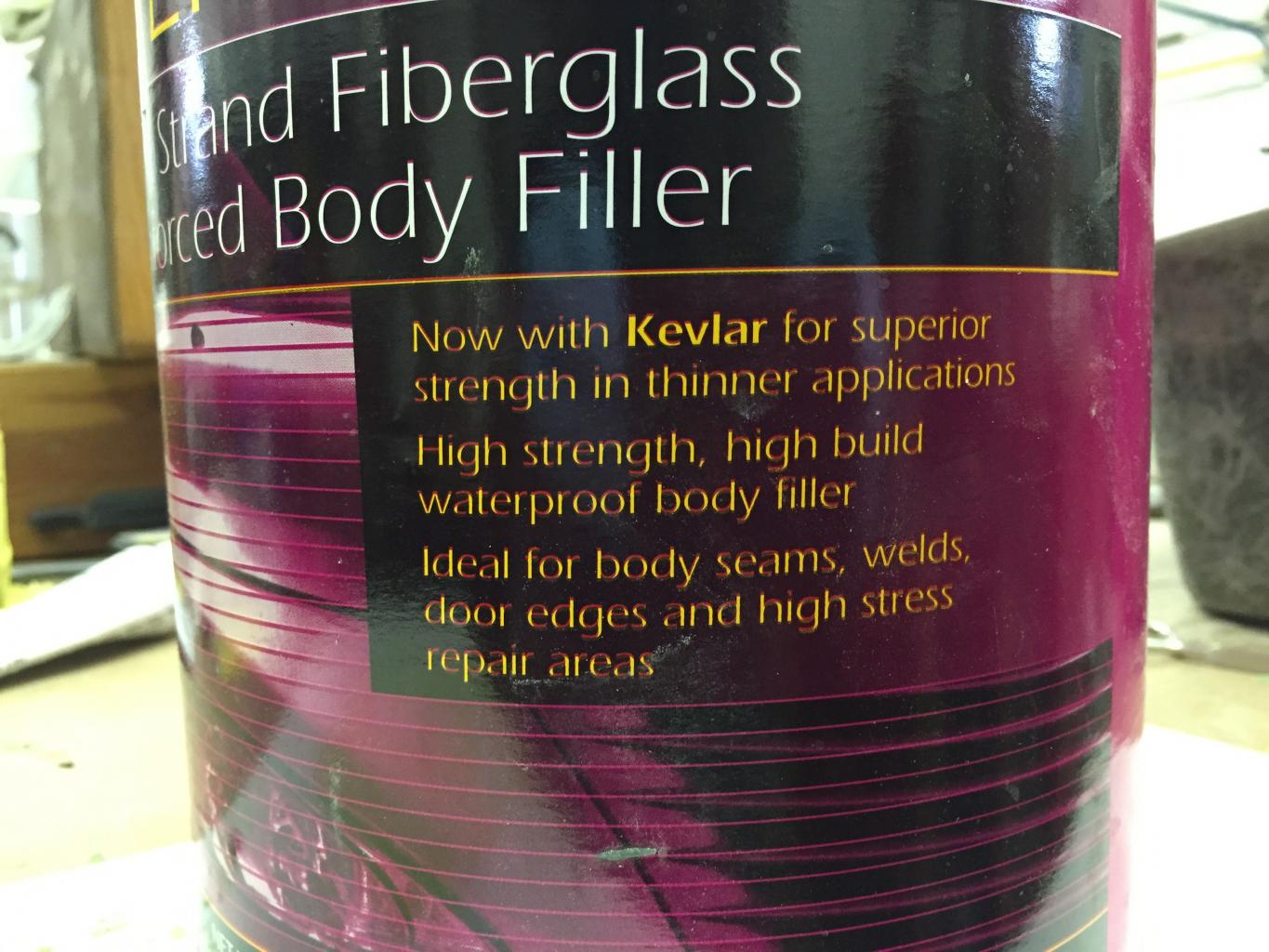

Another pic with a word of warning ---
Work this stuff while it is still plastic, because once it fully cures, it is like sanding steel!!!!:shocked:
