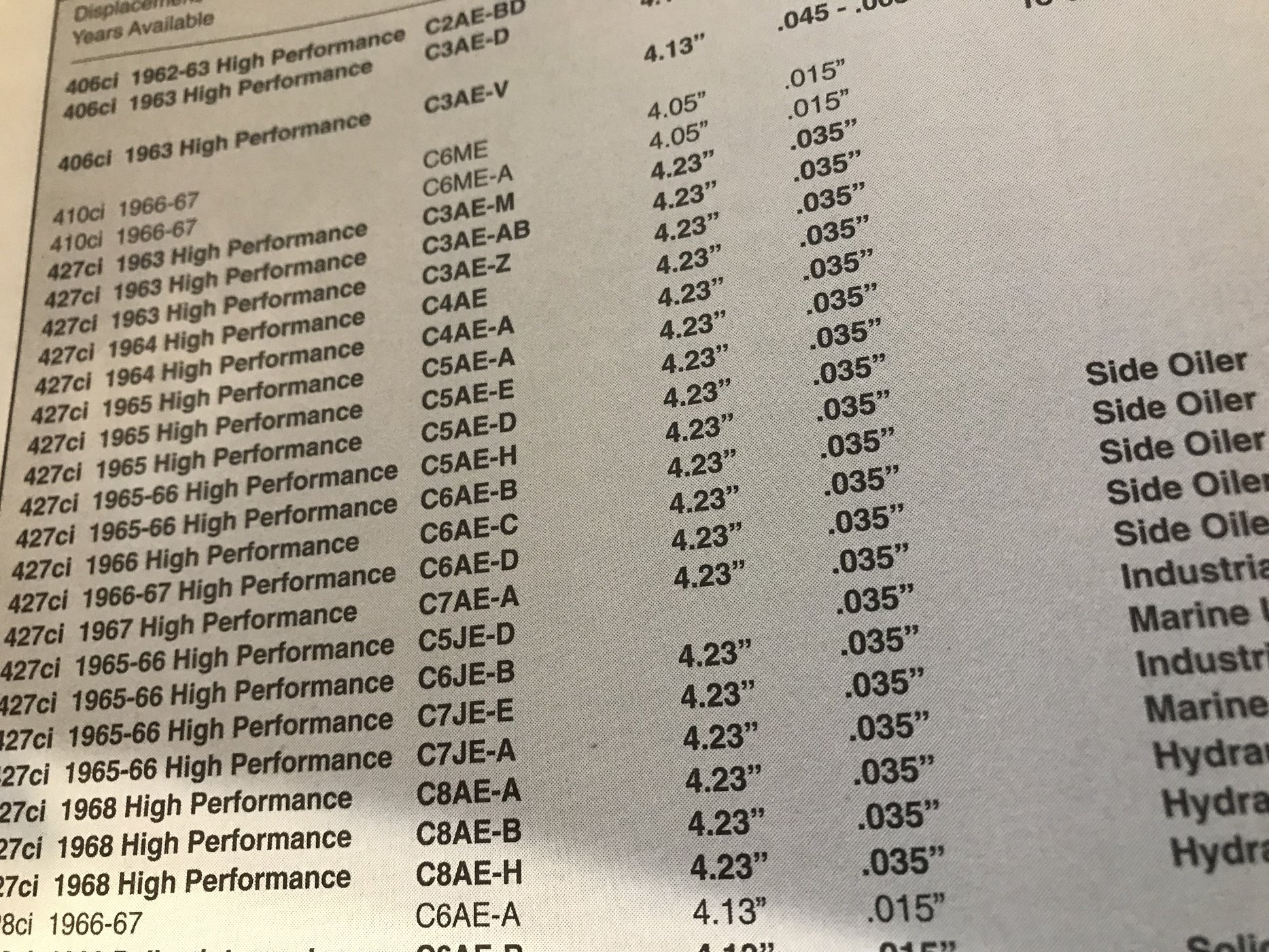

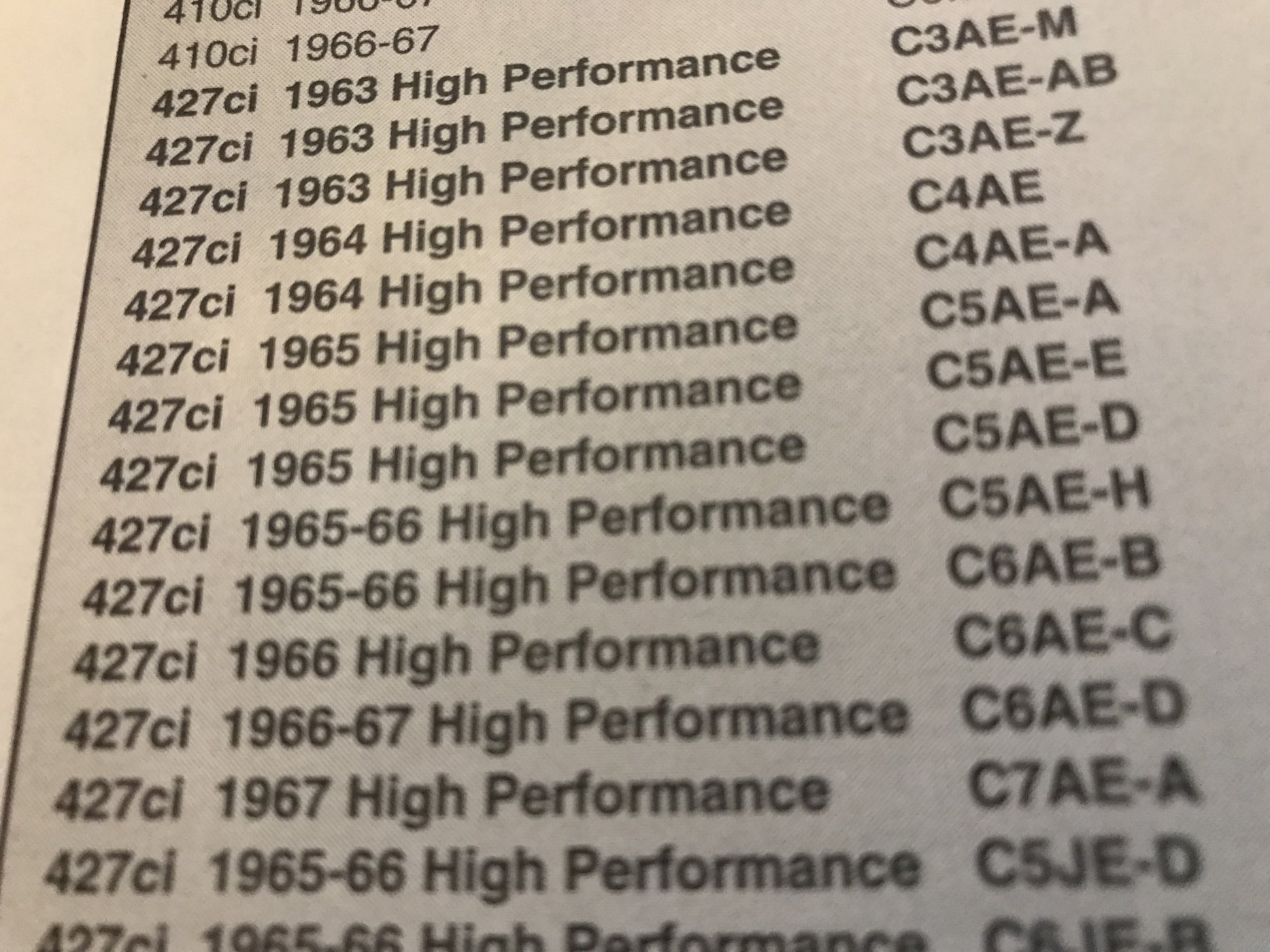

according to "High Performance Ford" book a C5AE-E block is a 427 but I'm not sure about the 6105. In the book it's not listed as a side oiler.

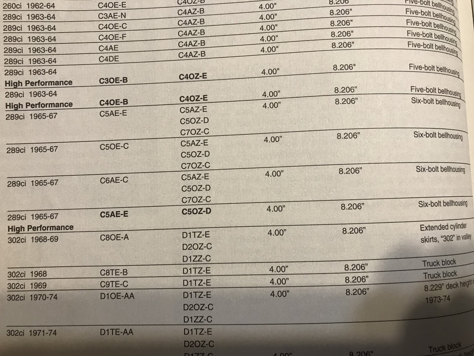

I'm sorry. Some how I thought it was a FE.
Let's try again
289 65-67 six bolt block

Engine block codes
The Ford casting number always starts with the 'Decade' character. Ford started using this structure in the late 50's with the first letter being 'B' . In the 60's the letter changed to 'C' and 'D' for the 70's and so on. The Decade digit is always followed by the 'Year' number. The combination of Decade and Year indicate the actual model year the part was originally designed for.
First character (a letter)
B = 50's C = 60's D = 70's E = 80's
Second character (a number)
Year of decade
e.g. C9 is 1969
Third character
Car model
E,g.
A – full size Ford
D – Falcon, Maverick
E – Truck
L – Lincoln
M – Mercury
O – Fairlane, Torino
S – Thunderbird
Z – Mustang
W - Cougar
Fourth character
Engineered component
E = engine
The second group of characters refers to the part of the car. In this case the engine.

So mine would be a full size Ford from 1965 Thanks Mike
