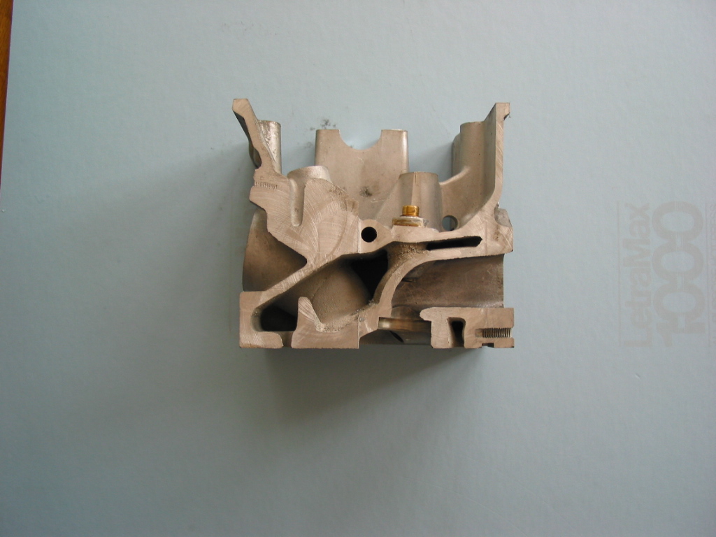

The main problem is the fact that the exhaust port is basically shaped like an "L"
This site has some cutaway pictures of the heads:
Index of /Whitepapers
Here is the nasty exhaust port:
http://www.mwrench.com/Whitepapers/V-12 head/V-12 head cutaway.jpg

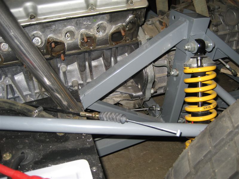

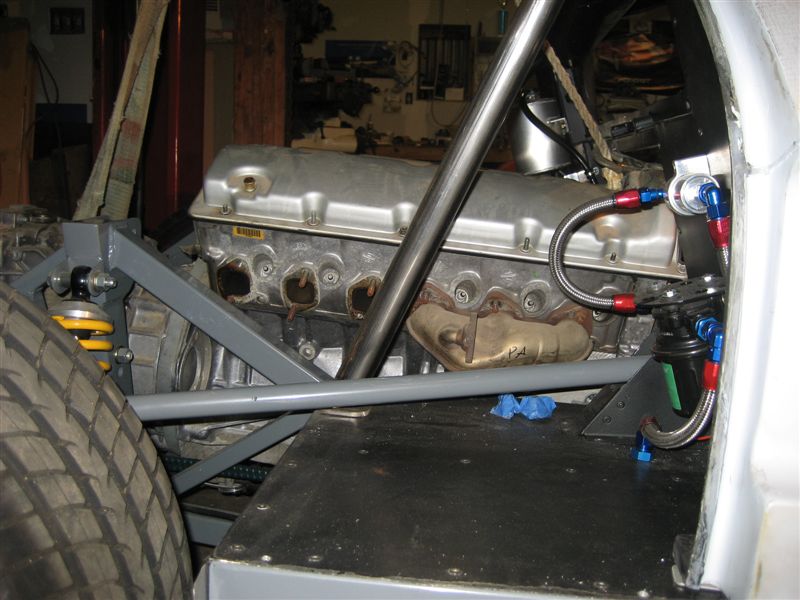

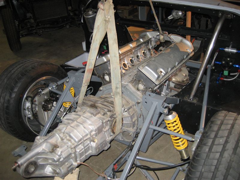

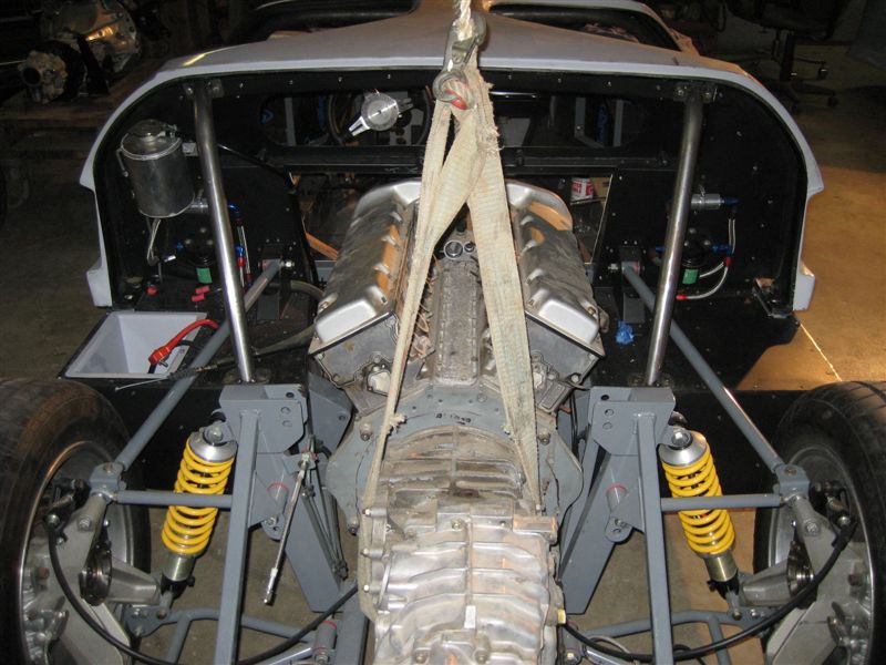

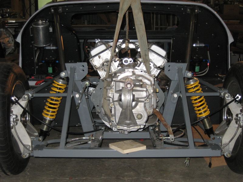

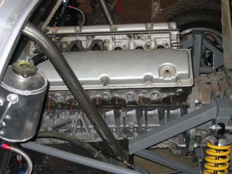

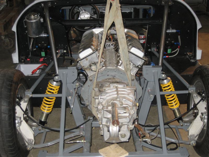

Yes, it'll fit. Here's a "drop in" of one of my mockup M70's and a G50/02 into a friend of mine's early Roaring Forty.
If you'd go forward with this concept, you'd want probably want to dry sump the engine, as the sheet metal sump becomes the lowest point on the car.
Last pic is of the M70 that we've been building for, as yet, an undetermined chassis. This engine is actually one of the 6.0 liter M70's built by Henry Lawrence and it's still at his shop.
