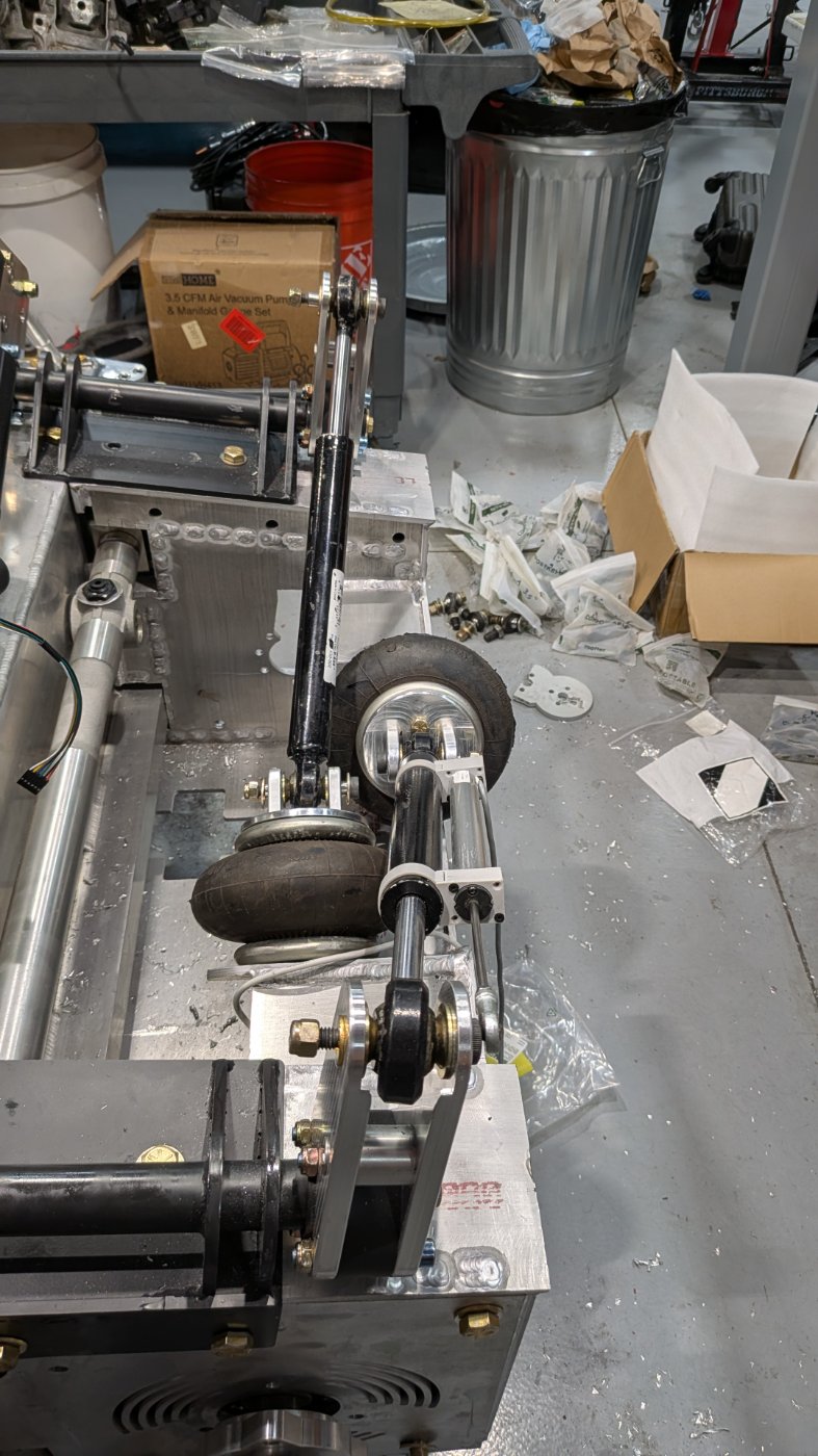

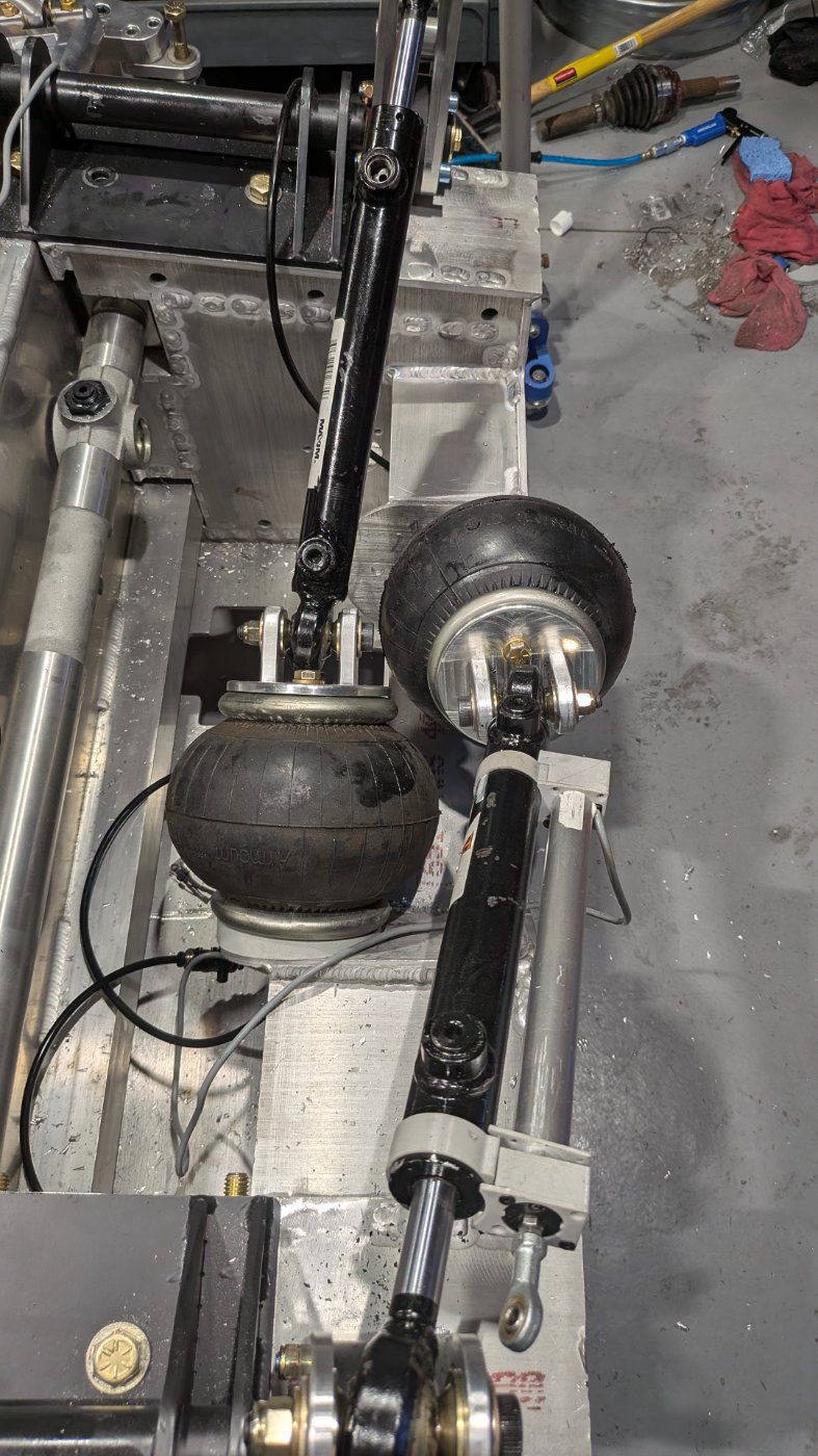

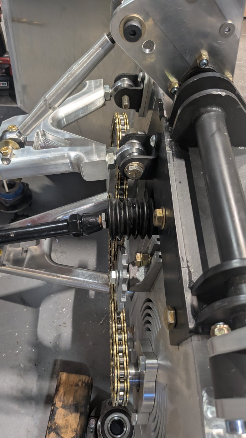

Small update. Finalized the air spring locations, each actuator is on a 4.8 degree angle, and I am adding cantered perches to the springs so they are perfectly in line with the actuator. These are printed but not installed yet. Also added the cover to the front motors, and the front bearing for the sprocket shaft, so the whole drive is in double shear, as recommended by EMRAX. Motor spins freely and with out contact anywhere.

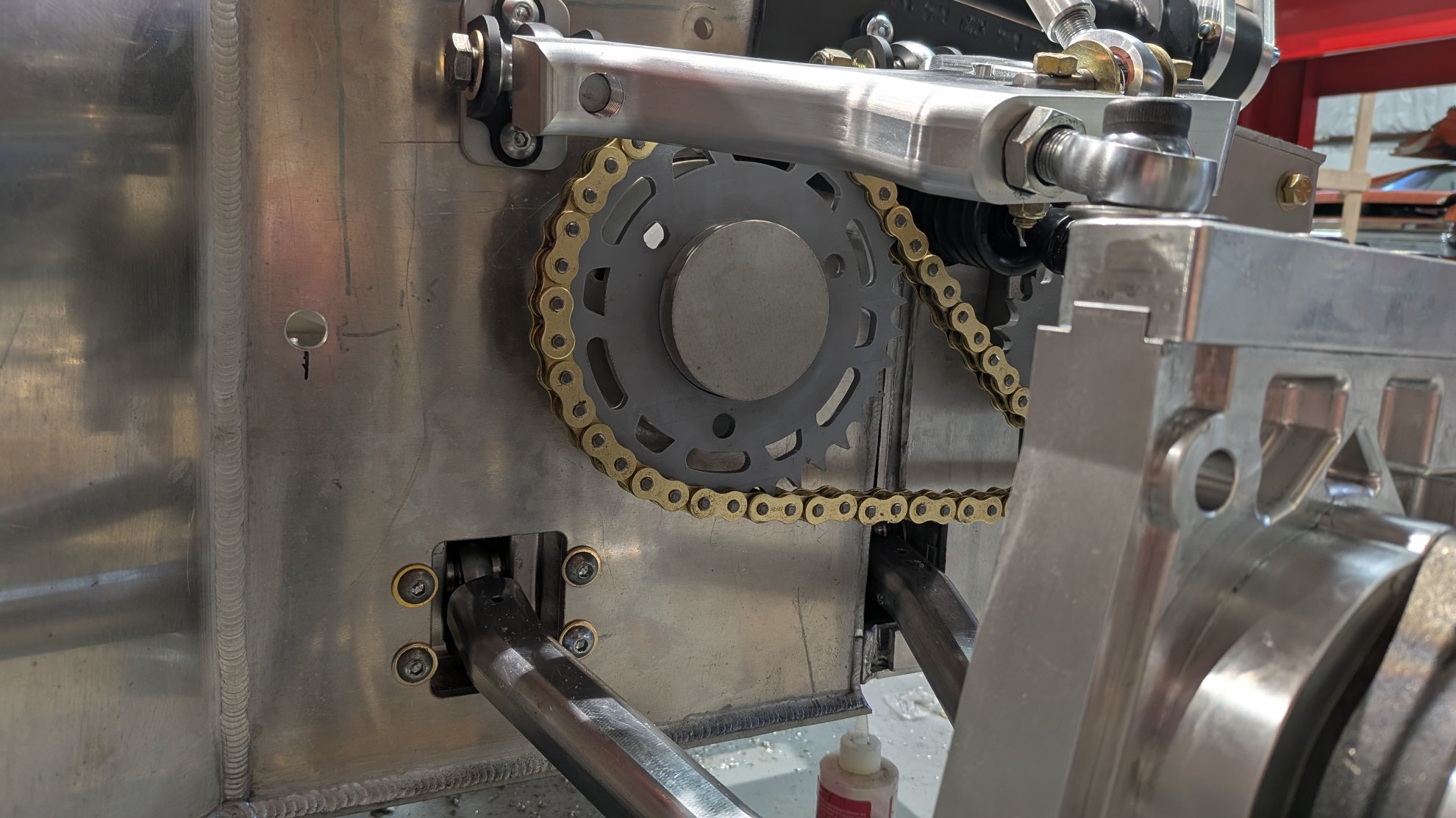

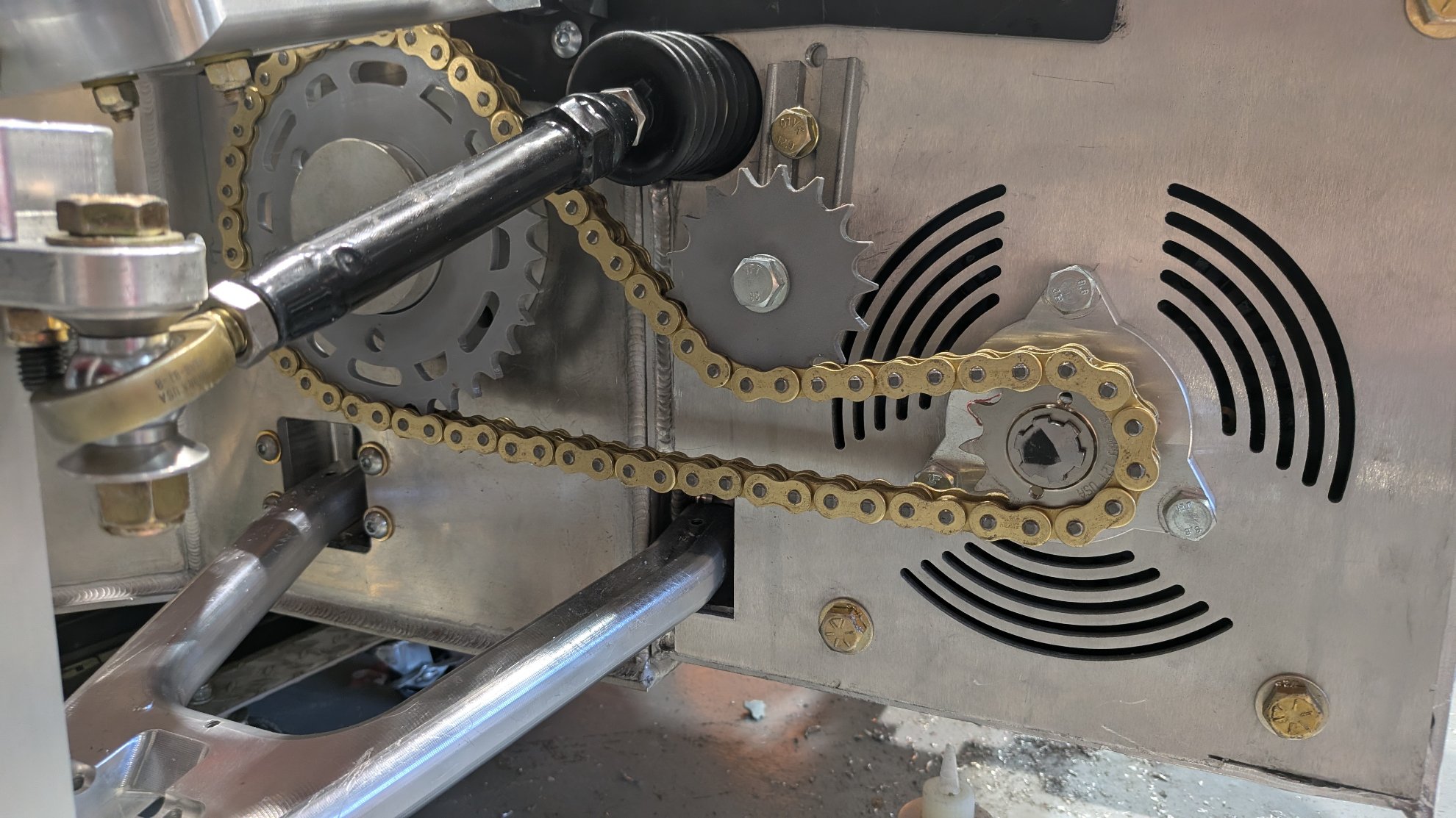

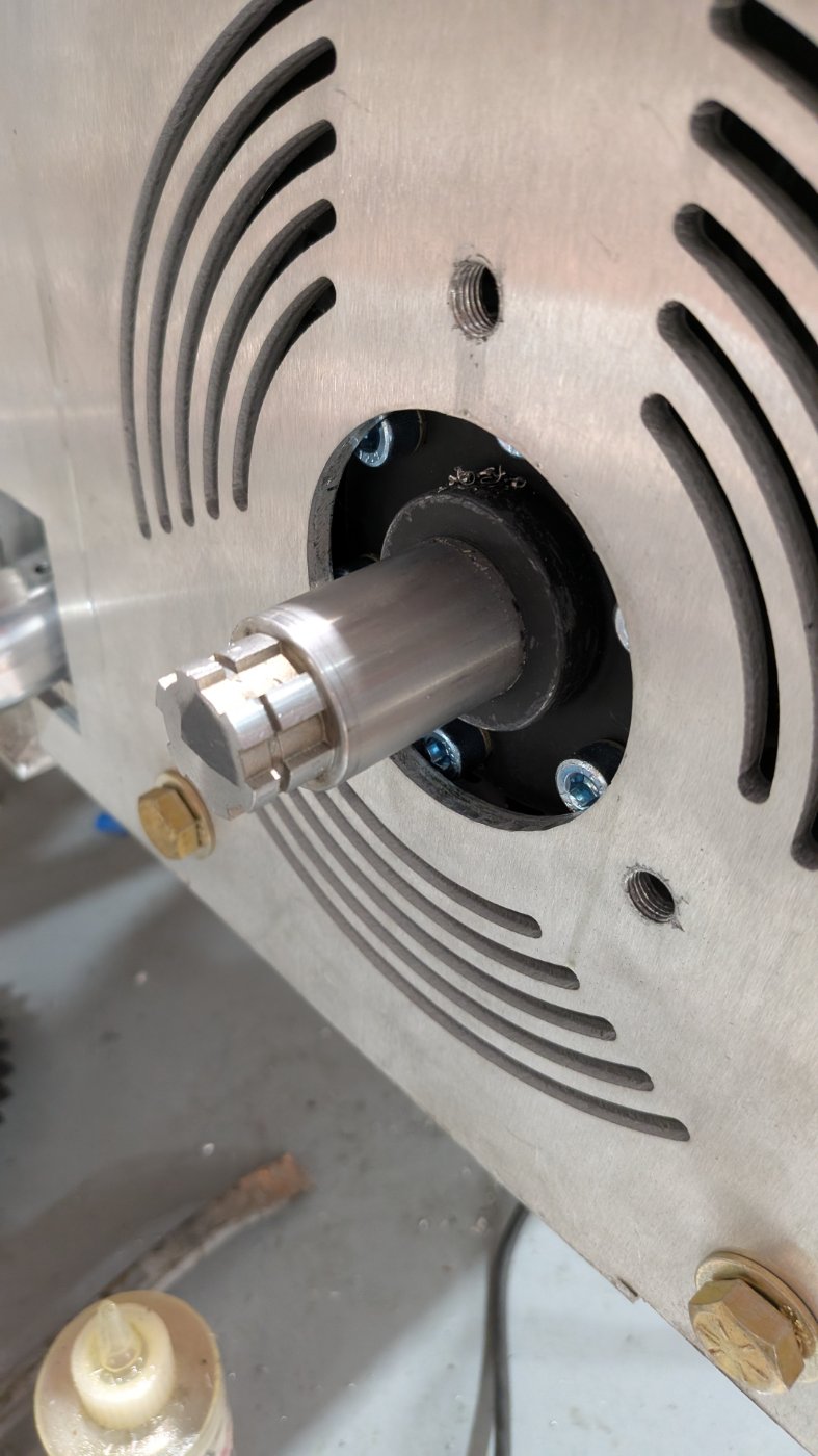

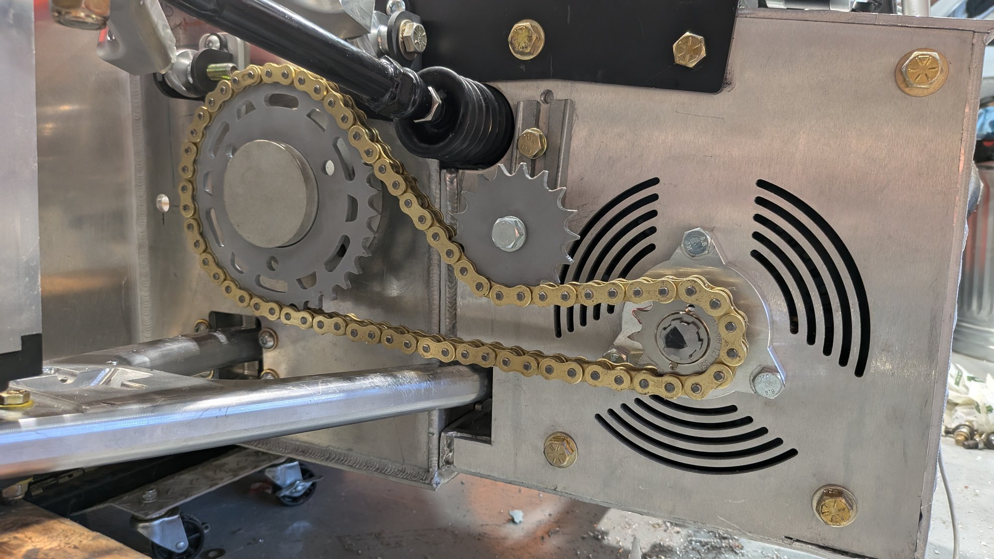

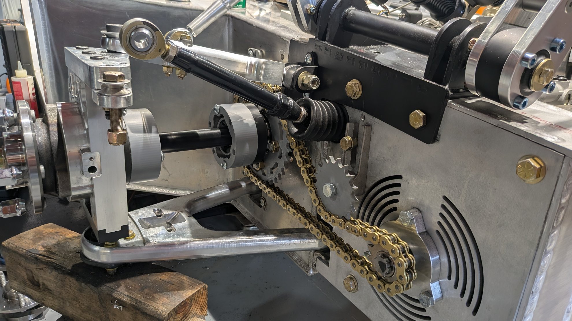

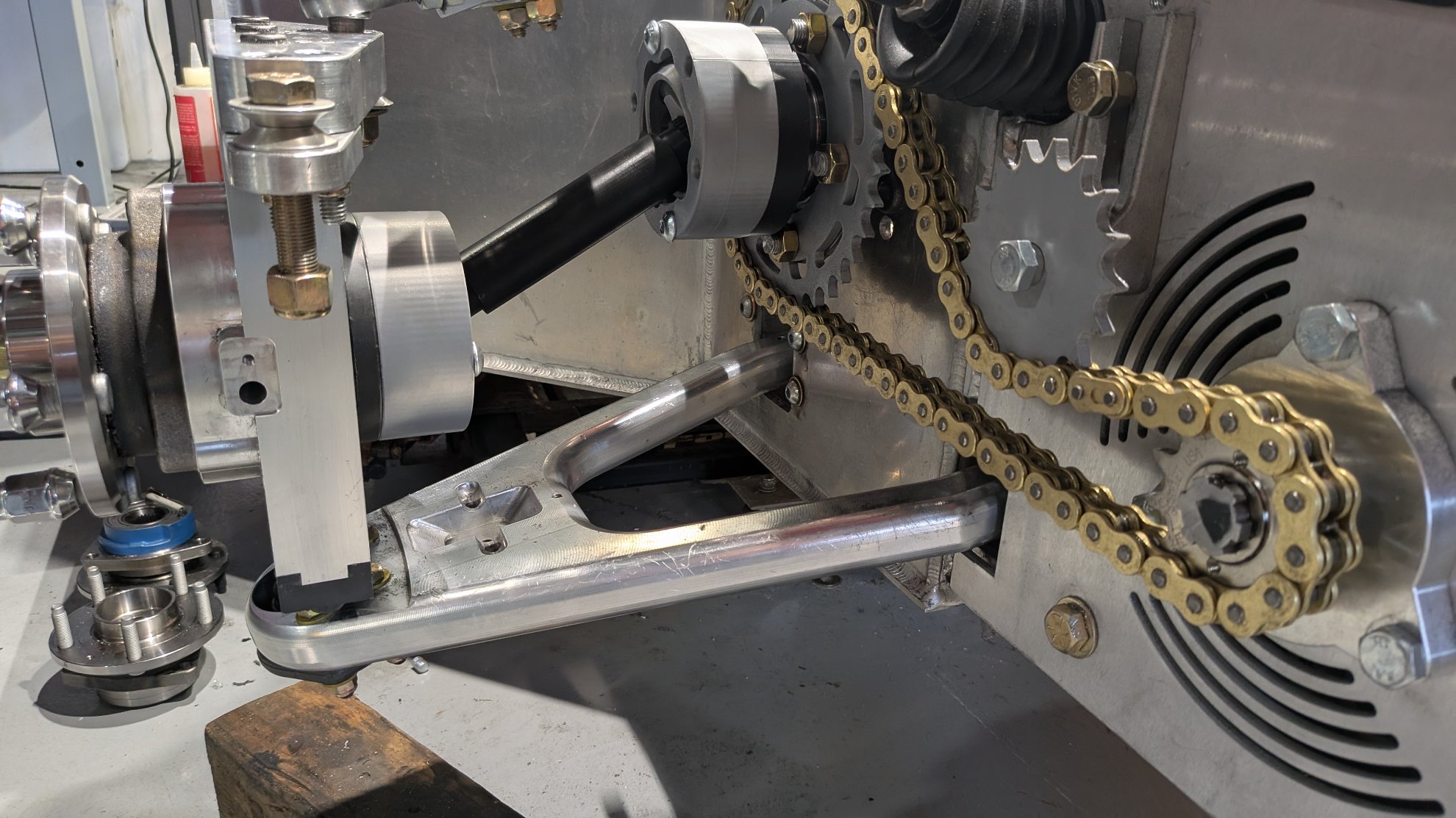

Finally I mocked up the chain drive to where the front axle will be. I had made the sprockets in chromoly, but this is one place where my printed parts worked fine, but the metal ones did not. I think I got the pitch wrong on it. So everything is just 3d printed right now. But...it all fits and clears the A-arms at both bottom and top of travel. Full droop is a little close, but I do not have the chain under tension in these photos. What is mocked up is my worse case from clearance. The rear sprocket is 36T front is 10T, tensioner is 17T.

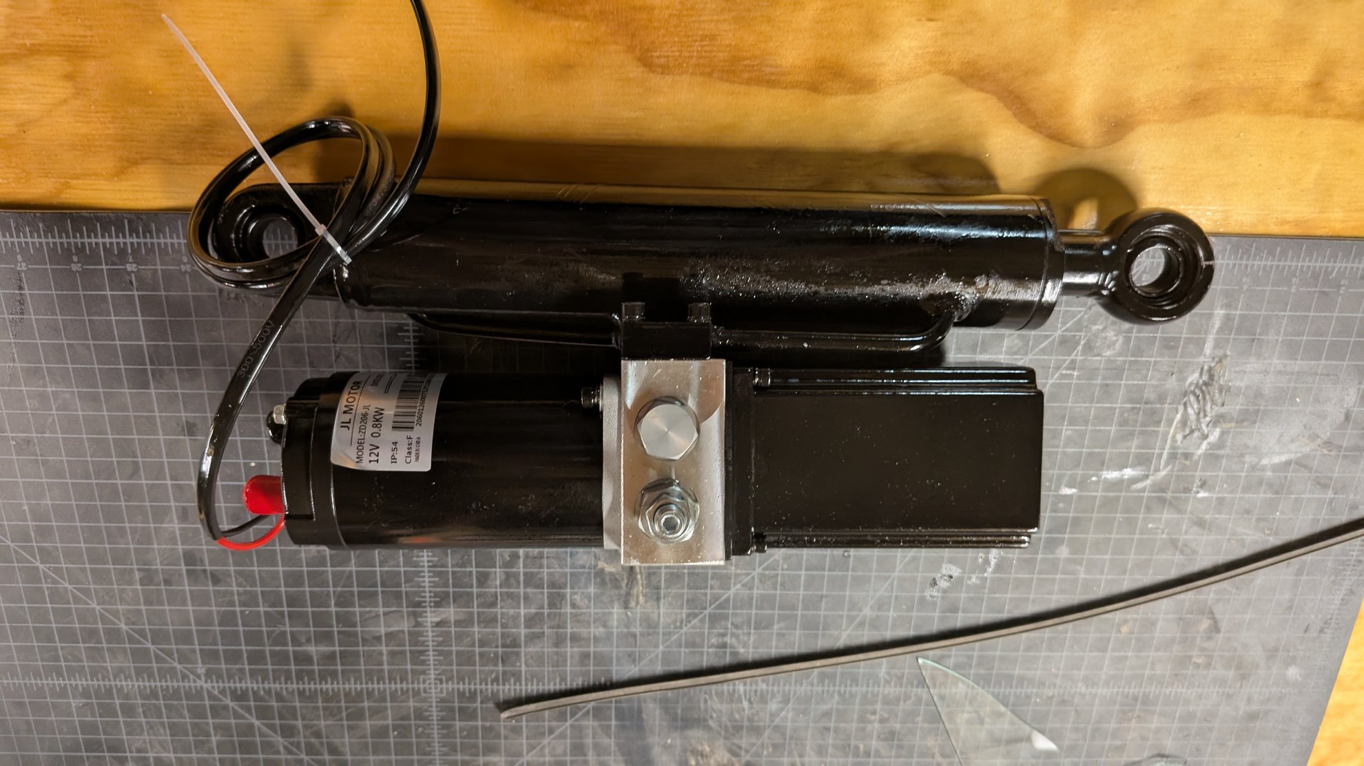

Sourcing/building actuators for the suspension system. When I started designing the suspension system for this car almost 6 years ago now, there were not too many examples of active suspension systems using mechanical actuators.

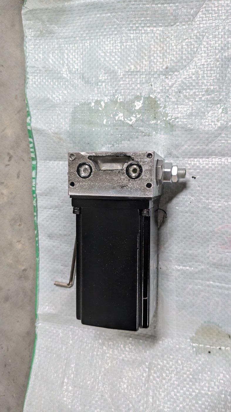

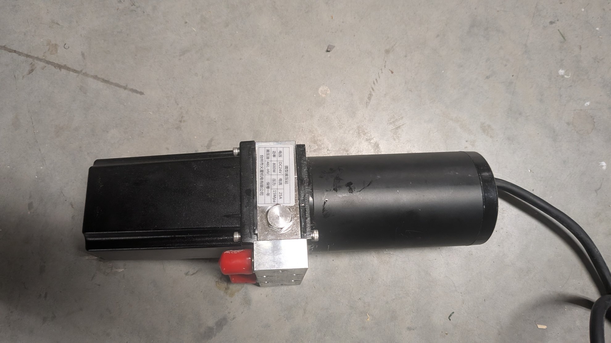

I designed my system in anticipation that I could not source or make a actuator that could do >10 inch/sec., so I am using traditional dampening and springs. If anyone know of small hydraulic pumps or actuators that might work, Im all ears. As is, my active system will be more like Williams/Porsche body control systems. With that in mind, I went out and started buying small hydraulic pumps.

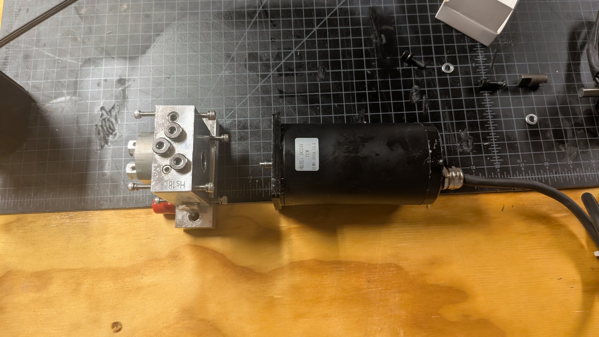

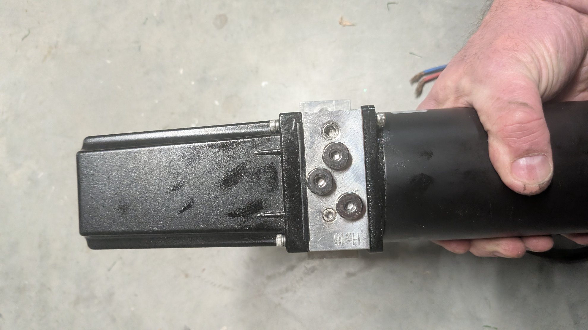

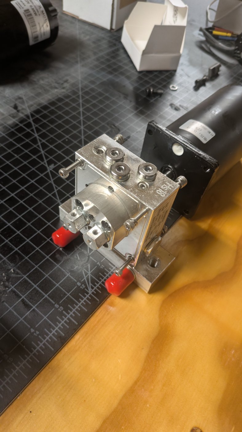

First one: was the HS10-350 its about 1.1L/min bidirectional output @ 15 mpa. https://www.ebay.com/itm/316076660015. This would get me about 1.4 Inch/sec stock at 24v.
Second one: is part of a 2" bore cylinder https://www.ebay.com/itm/147148211496 1.8L/min, 25 mpa, 12V 800 watt. This would get me 2.5 inch/sec at 12V.

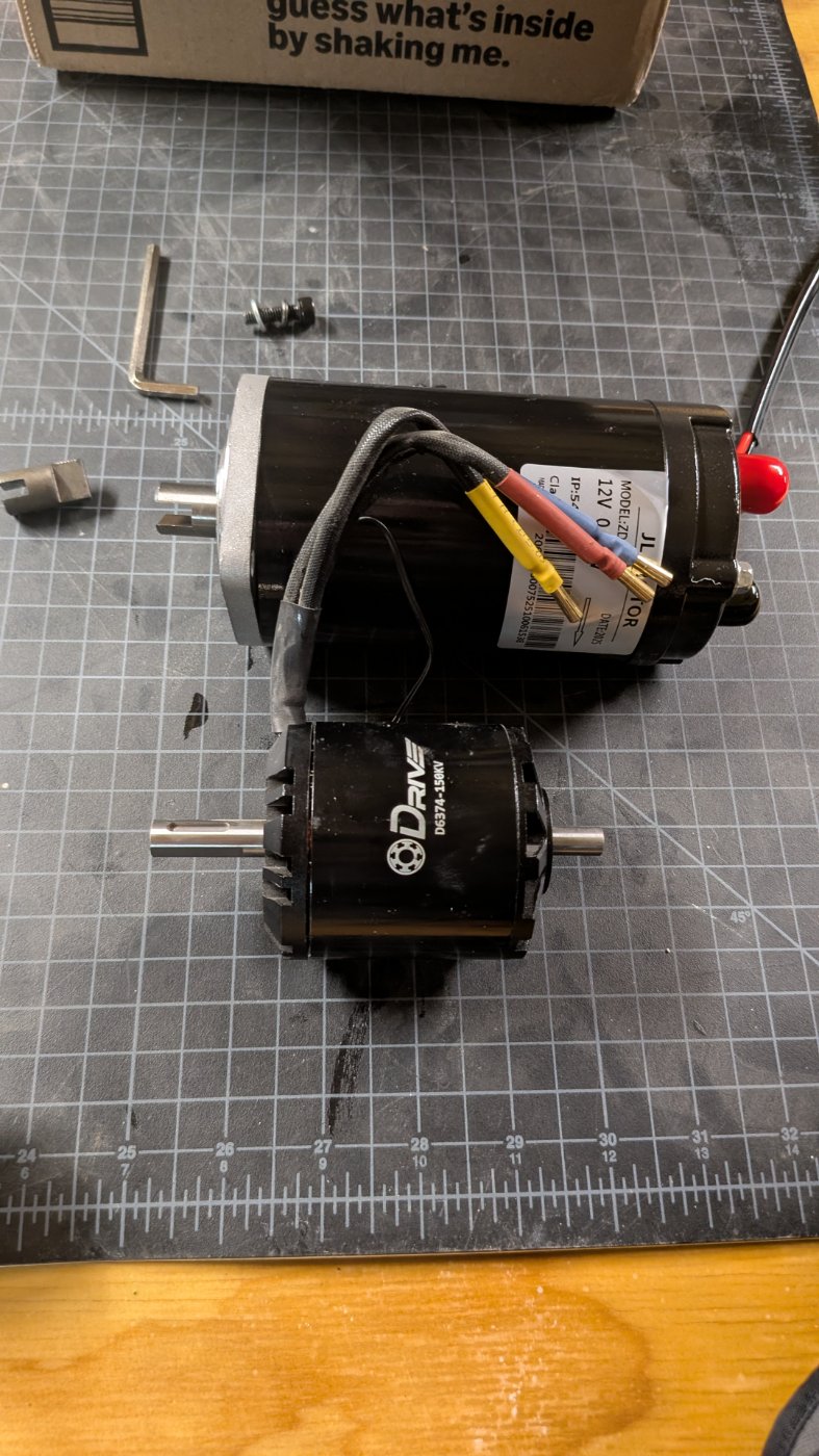

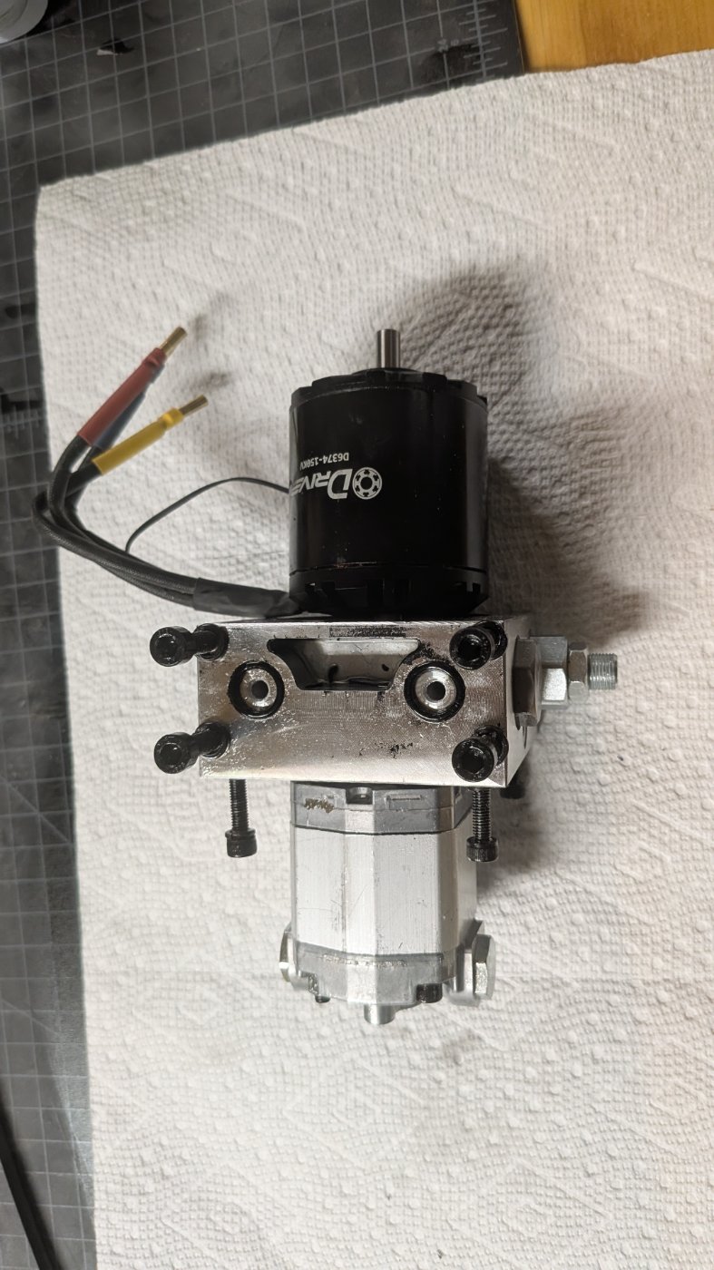

Neither is going to get me to where I need to be stock. So i disassembled them with the goal of swapping to motor to a BLDC motor of much higher power (https://shop.odriverobotics.com/products/odrive-custom-motor-d6374-150kv) 5.3 Kw peak, 2.6 Kw continuous power, 6500 RPM @ 58 volt. I would love to use a 400V motor, but I can find a small 5kw 400v bldc. Again, I'm open to suggestions. The advantage of using a smaller BLDC is i can use the Odrive ESC/controller which allows CAN control @ 8000 Hz, they use these things for drones and balancing robots.
My plan right now is to use the BLDC motor on the larger stripped down hydraulic pack with the 0.65 cc head and run it at 6000 RPM, and that should get me a solid 5 inch/sec extend rate. I may try to source a 1.25 cc bidirectional gear head and see if I can get 10 inch per second, but it going to take more work to source the gear head.
I'm open to any recommendations if anyone out there has hydraulic experience.

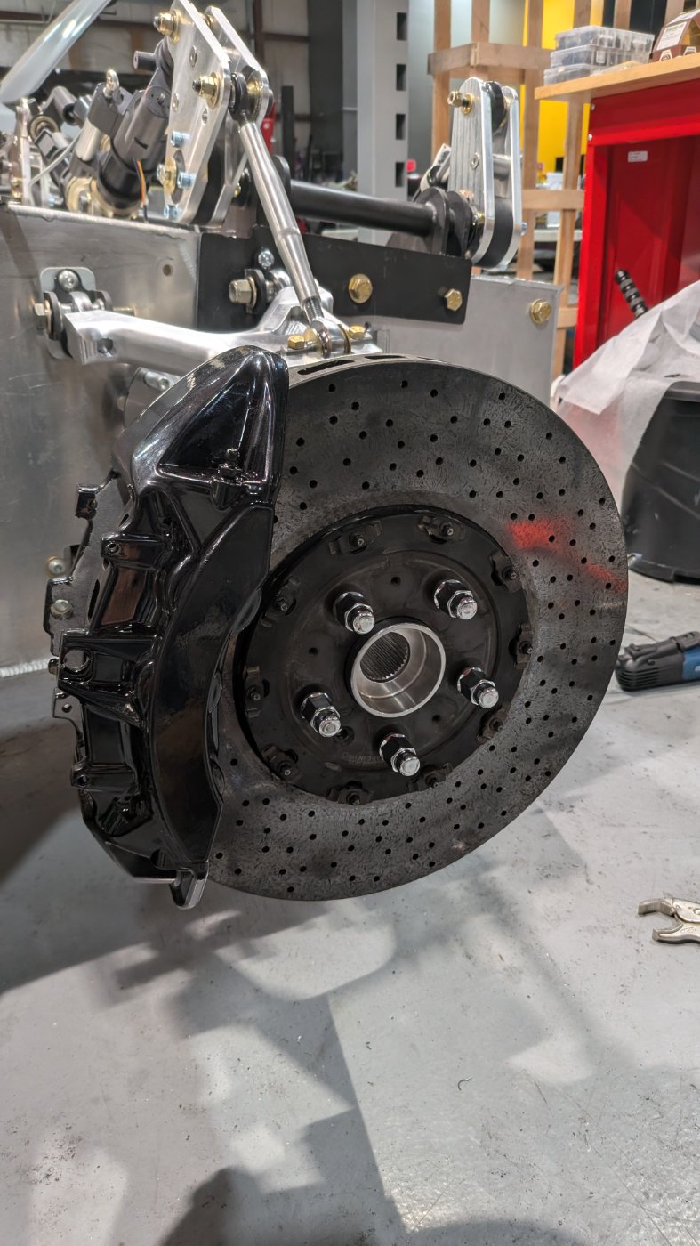

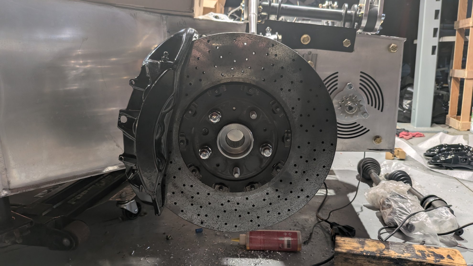

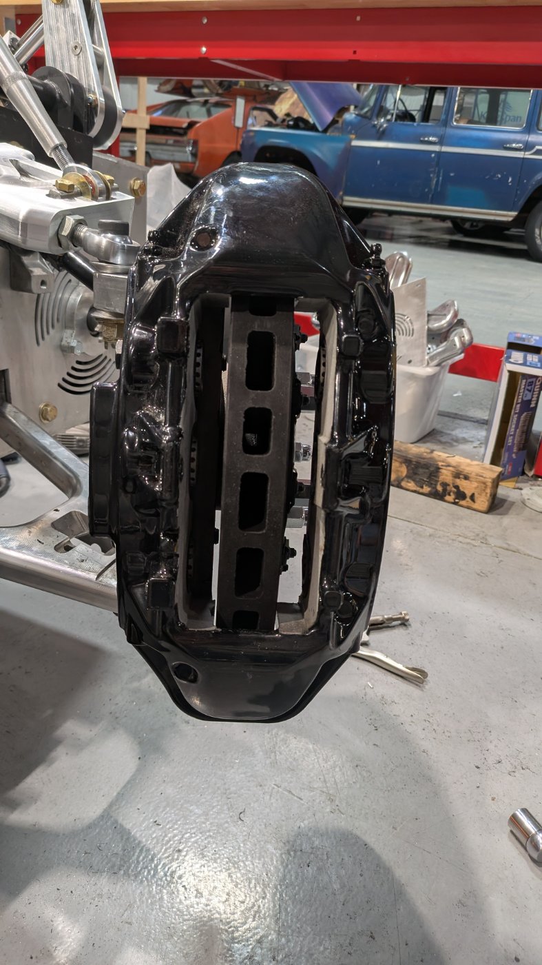

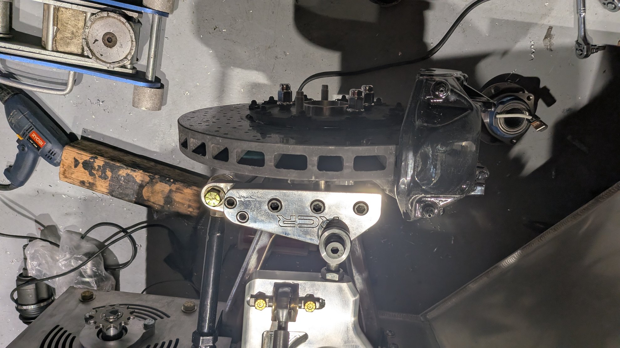

Got the C7 ZR1 carbon ceramic rotors and calipers mounted. Had the wrong size caliper bolts, but everything fits on my custom uprights. Pretty sexy stuff if you ask me.

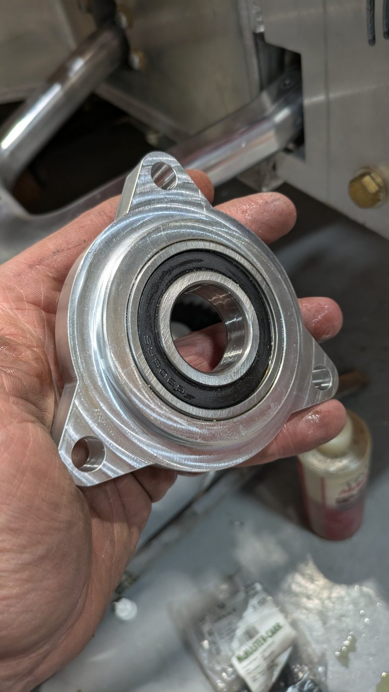

Front axle design. So mounting a front axle to a car never intended to have one is not easy. I settled on using a axle hub from a kia (beefy and narrow) mounted to the side of the chassis directly under the top dampener perch. The 36T drive sprocket will bolt right where the rotor would bolt on a car. Originally, I hoped the I could use two axle ends, one from a C7 Zr1 and one from a Kia, couple them, and call it a day, as they joints have some play, and my calculated movement in the axle from full drop to compression was under 10 mm. Sadly, reality had a different story. Turns out to have just about 1" of travel, so I will have to use a CV joint a one end, and so I might as well just go for Porsche 934 CV's with stub axels at each end, kind of like we do on the rear end. Stubs and CV's will given me more clearance between the hubs, so the angle will not as large too. C7 Zr1 Stub axles are readily available so that is nice, but I am going to have to design one for the Kia, unless anyone knows of a source. I am going to print up a set of stub and 934 CV joints and try to mock up an axle before I order one from The Drive Shaft shop.
But it is coming together. To see a axle on the front end of the car is rewarding knowing how much work it took to get here. To my knowledge this is a first for a SLC, and maybe for any RCR monocoque car.
Also go the caliper bolted, clearance is spot on.

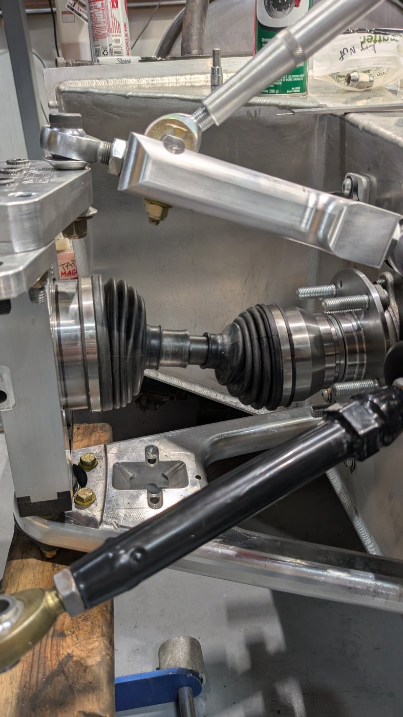

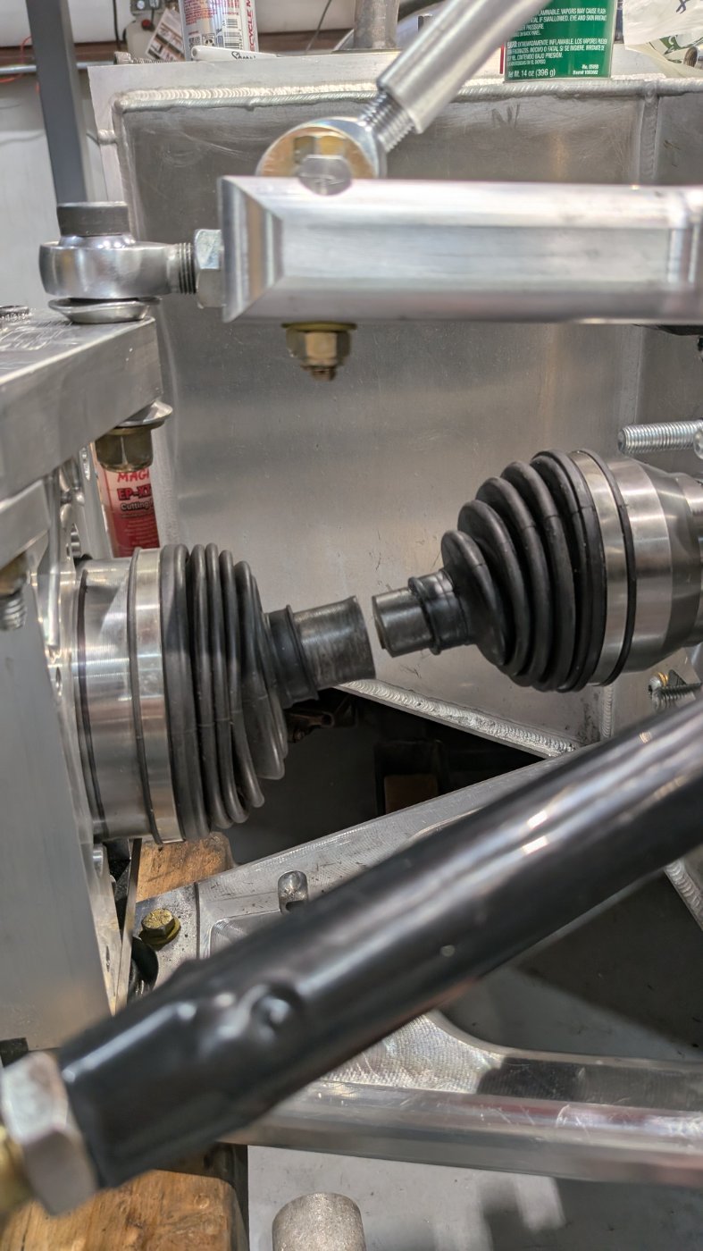

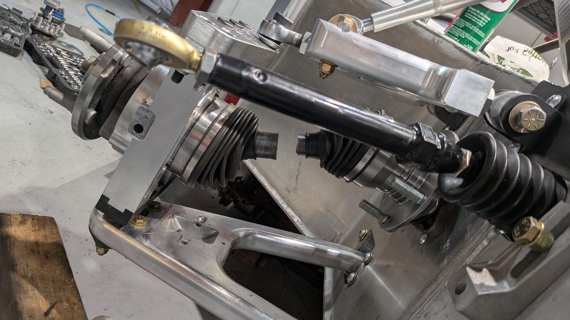

So I printed up some 934 CV's and man they are big. I think I might do it all in 930. Ill post some pictures of the the 930 vs 934 setup tonight when I get home. The 930 also has a couple more degree of articulation. I am just going to machine the stubs myself, faster and cheaper.
Bob

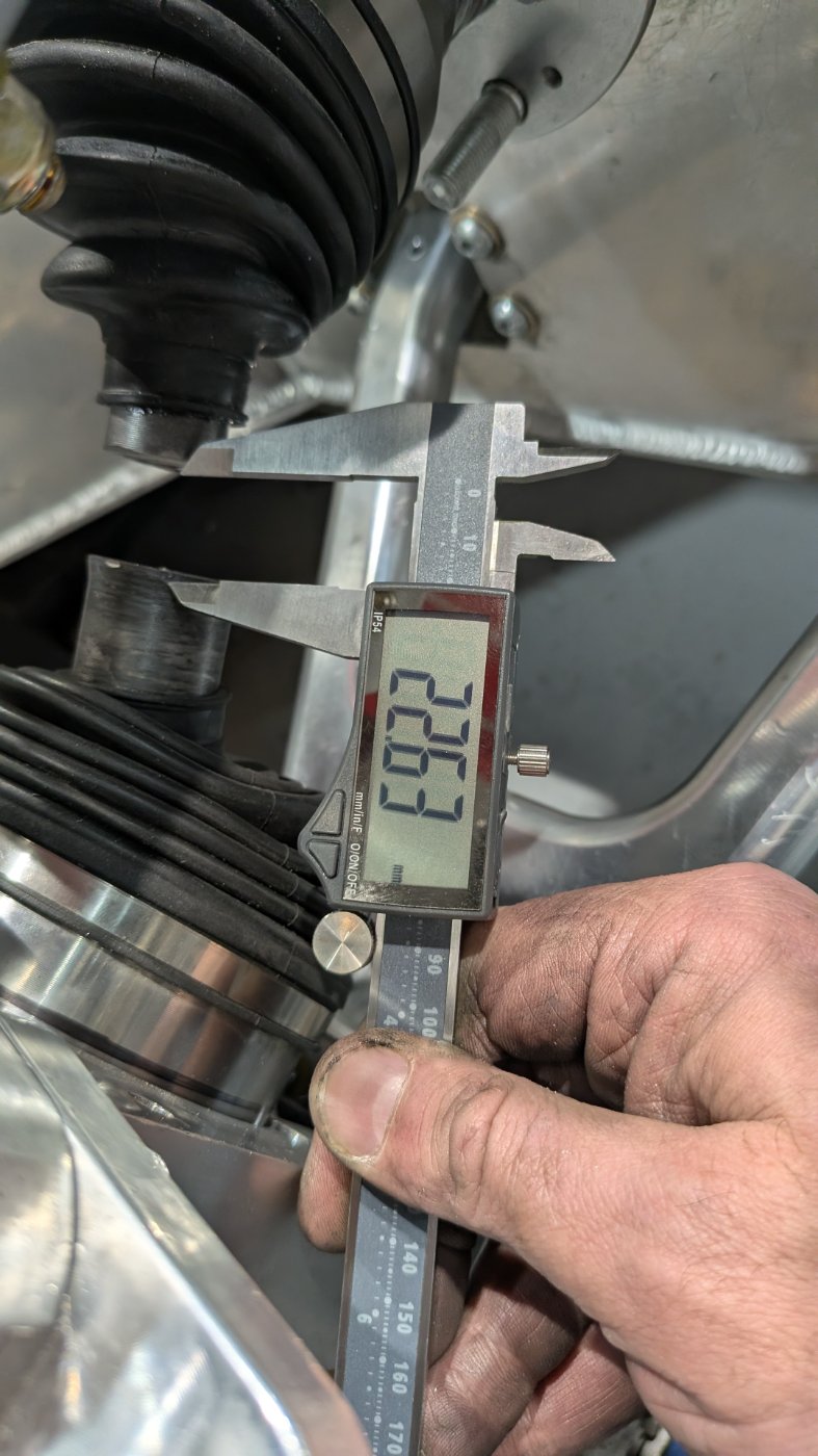

fitted everything yesterday. looks like it all works. 930 cv joints. axle worked out to be 4" spline to spline. Air-ed up the bags for the first time, at they expanded much more than the spec sheet says they should, almost 8 inches! realized i fundamentally didn't understand how these things work, and that they need a constraint/cage to limit deflection and max/min expansion/compression. For my bags its 4.5 inch max/ 2 inch stroke. So working on constraint system now.

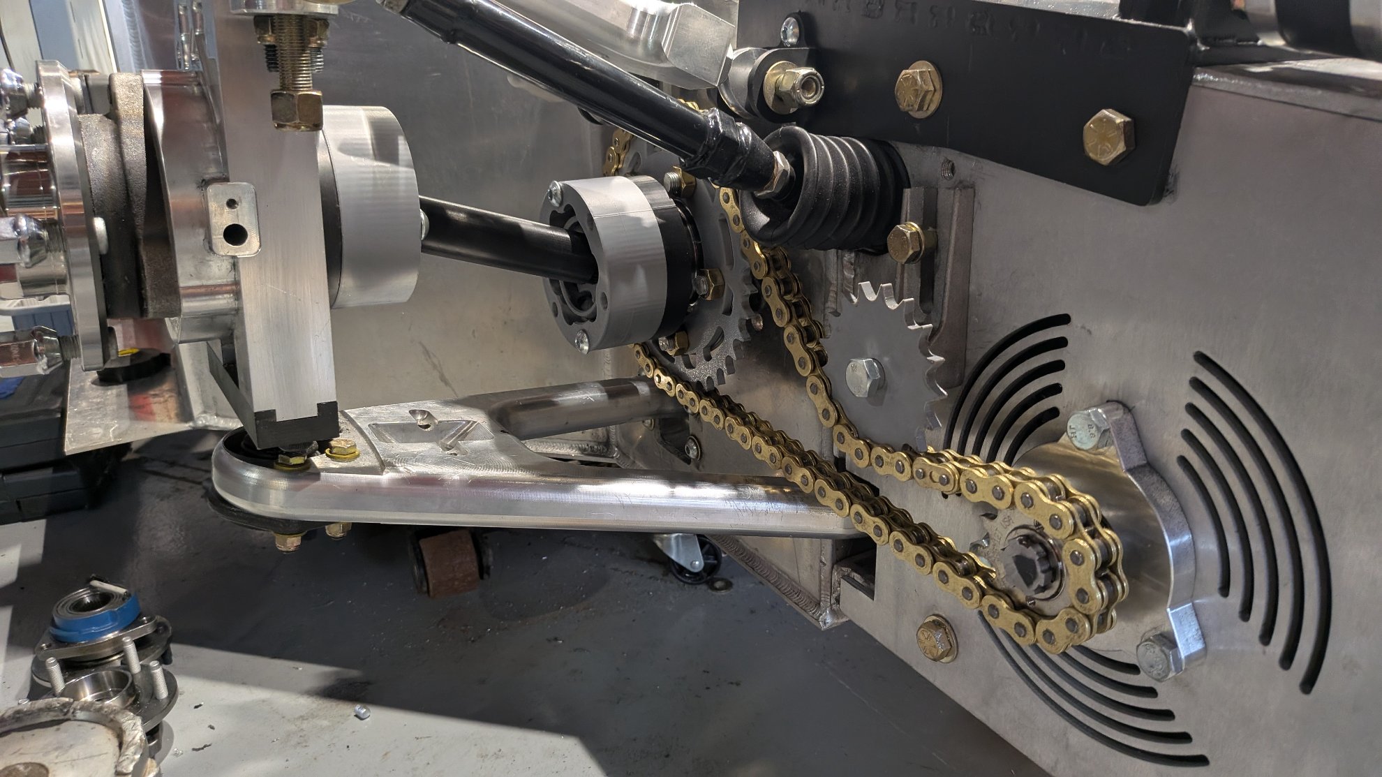

What is the chain drive?
The chain drive is for the front electric motors. They are ERAX 228 124 Kw / 220 nM torque one on each side. Chain drive is to transfer power and gear it up 3:1. very hard to make these cars get driven front wheels. I have no idea how someone could do it with a traditional differential and drive shaft. I should say in the final form the chain will be tighter, once i get the metal sprockets made, and will have a chain guard over some of it.
