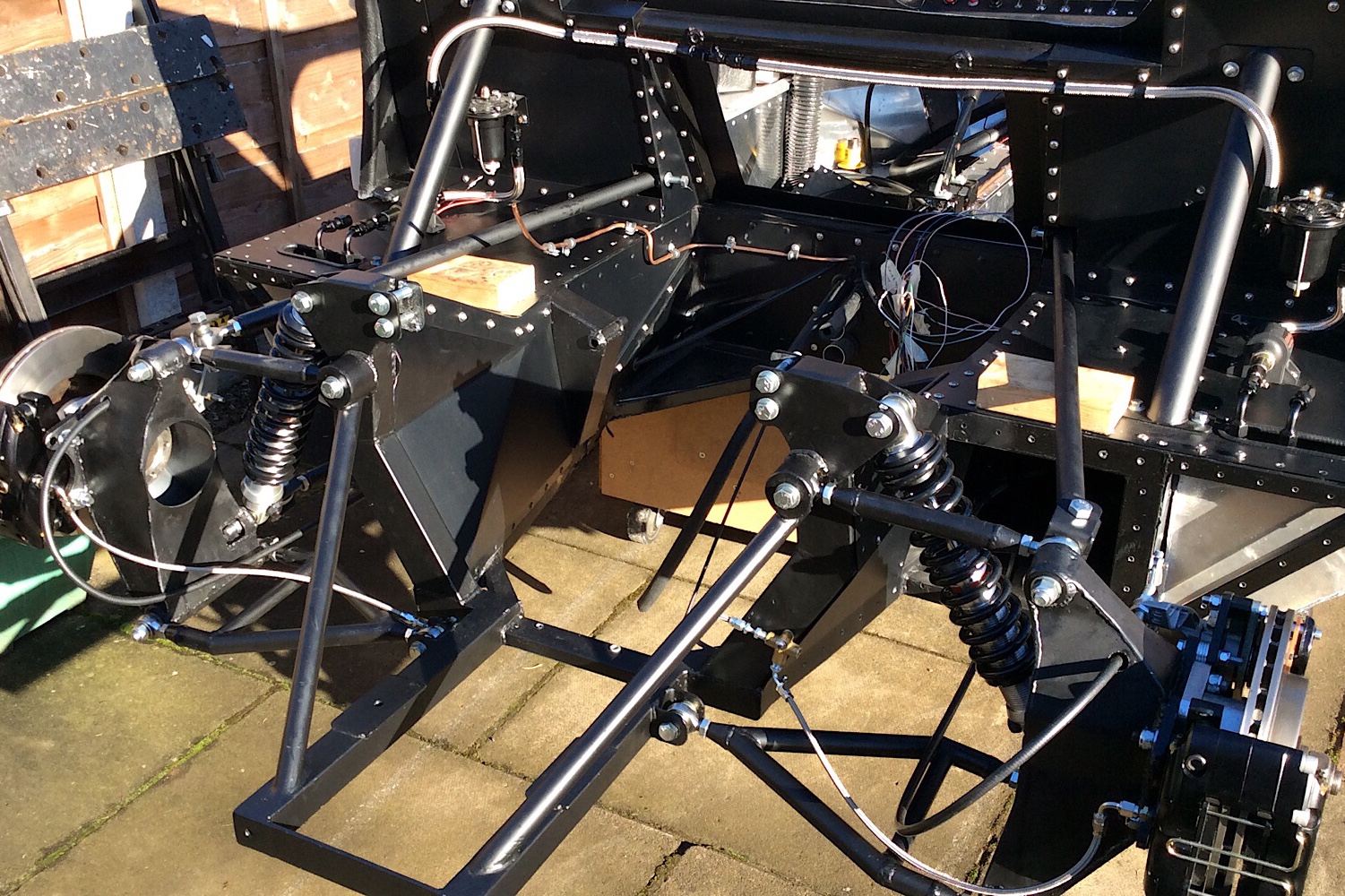

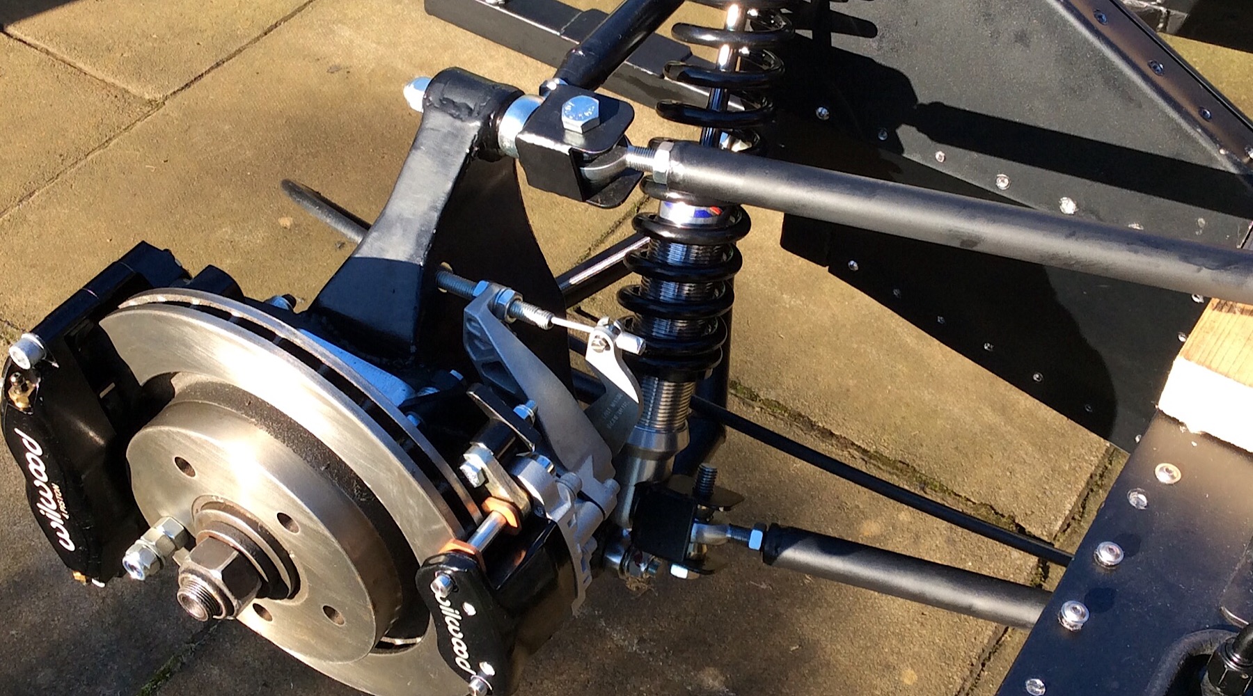

I wanted to move the lower spring mount outboard further from the centre of the lower wishbone.
Seems to have worked out ok.

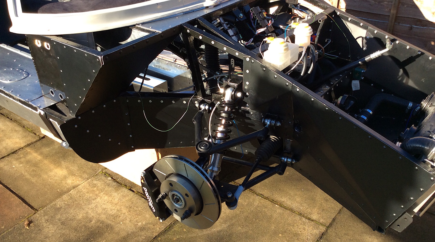

Also been cracking on with brakes and brake pipes.
Using Granada Scorpio discs at front.

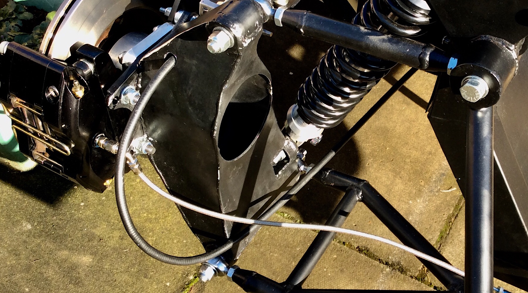

At the rear it’s “standard” Granada Mk2 discs.

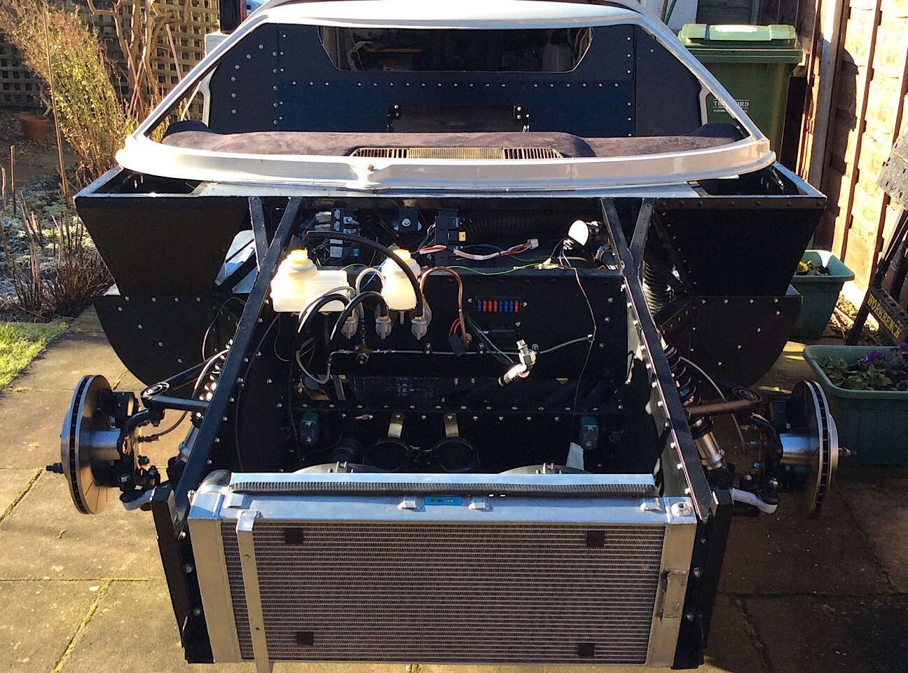

Nearly finished with the brake pipes and, as you can see, all four coil-overs in place.
It’s taking a while but considering the Manchester weather I’m quite pleased with how things are going.
As ever if you spot any cock ups please let me know!

Here’s a link to the cables Nick.
I’m afraid they are not a quick fit to our caliper.
Required a fair bit of chopping about.

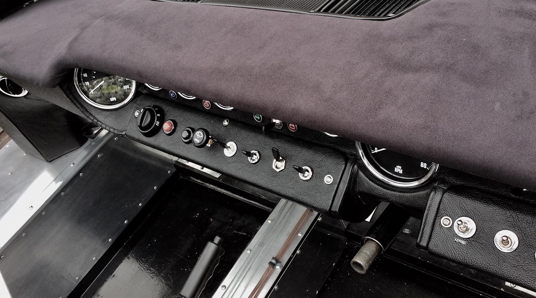

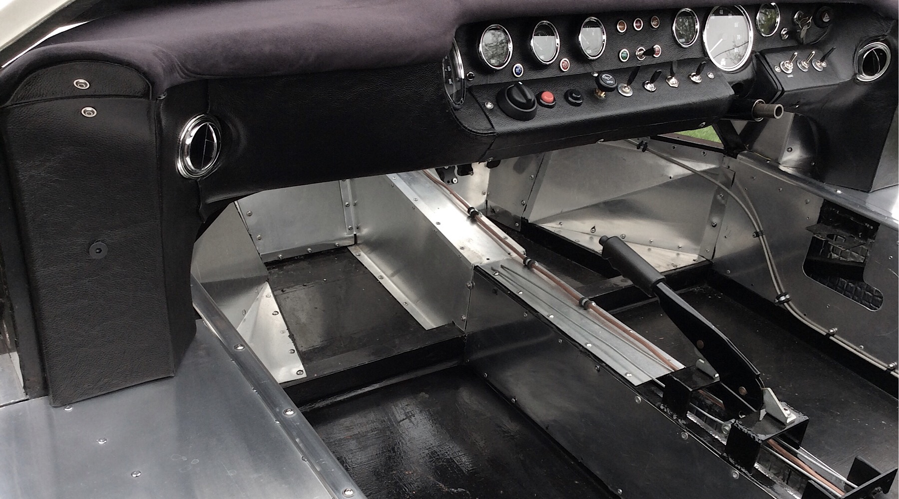

Got the dash top fitted using a couple of screws each side.
I know it will be completely different with the screen in place but the removable top makes the build easier.
The eagle eyed amongst you will have spotted the “Ariel” on the switch panel.
Don’t worry.
Just testing for durability!
