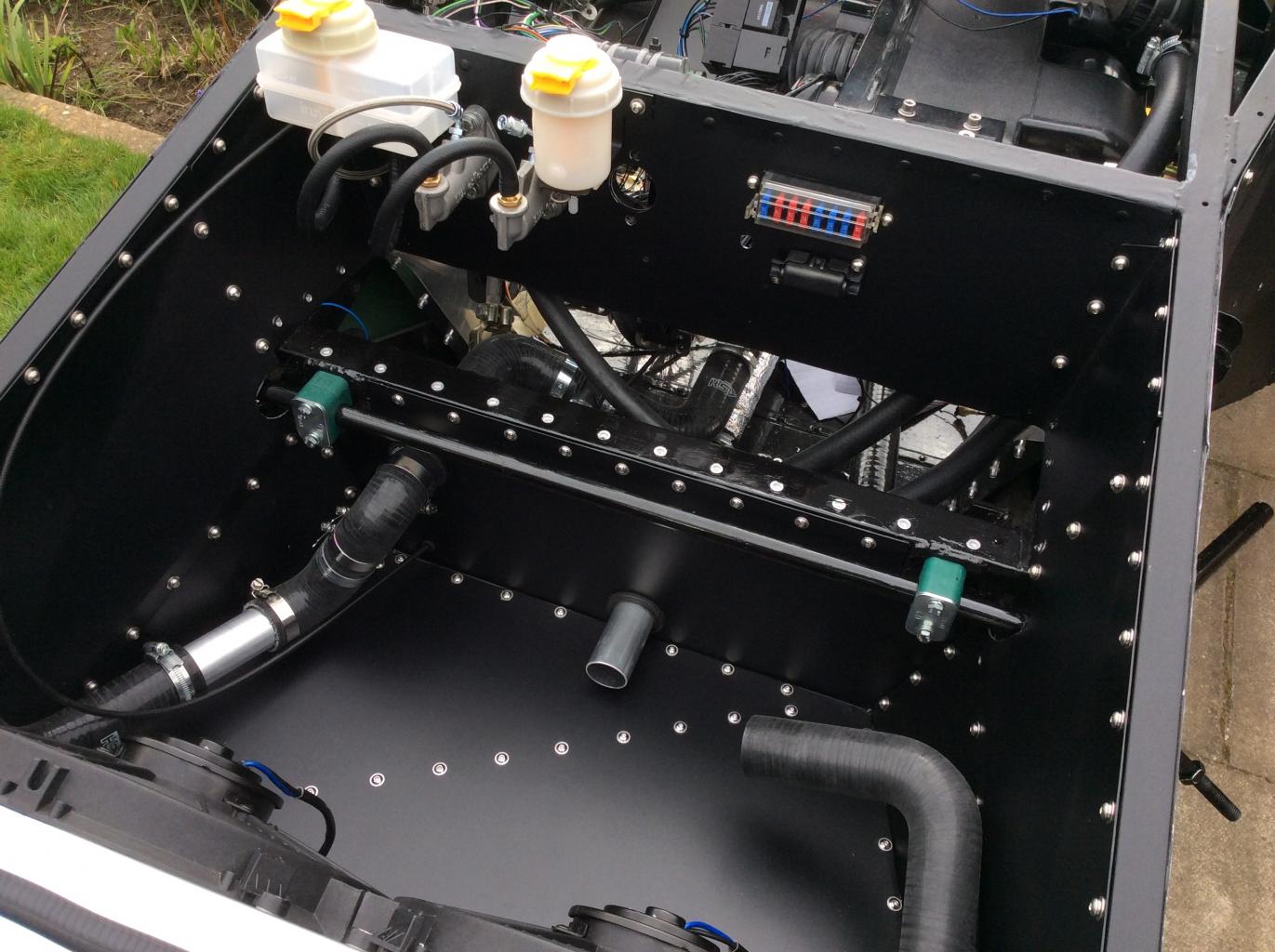

Made some progress.

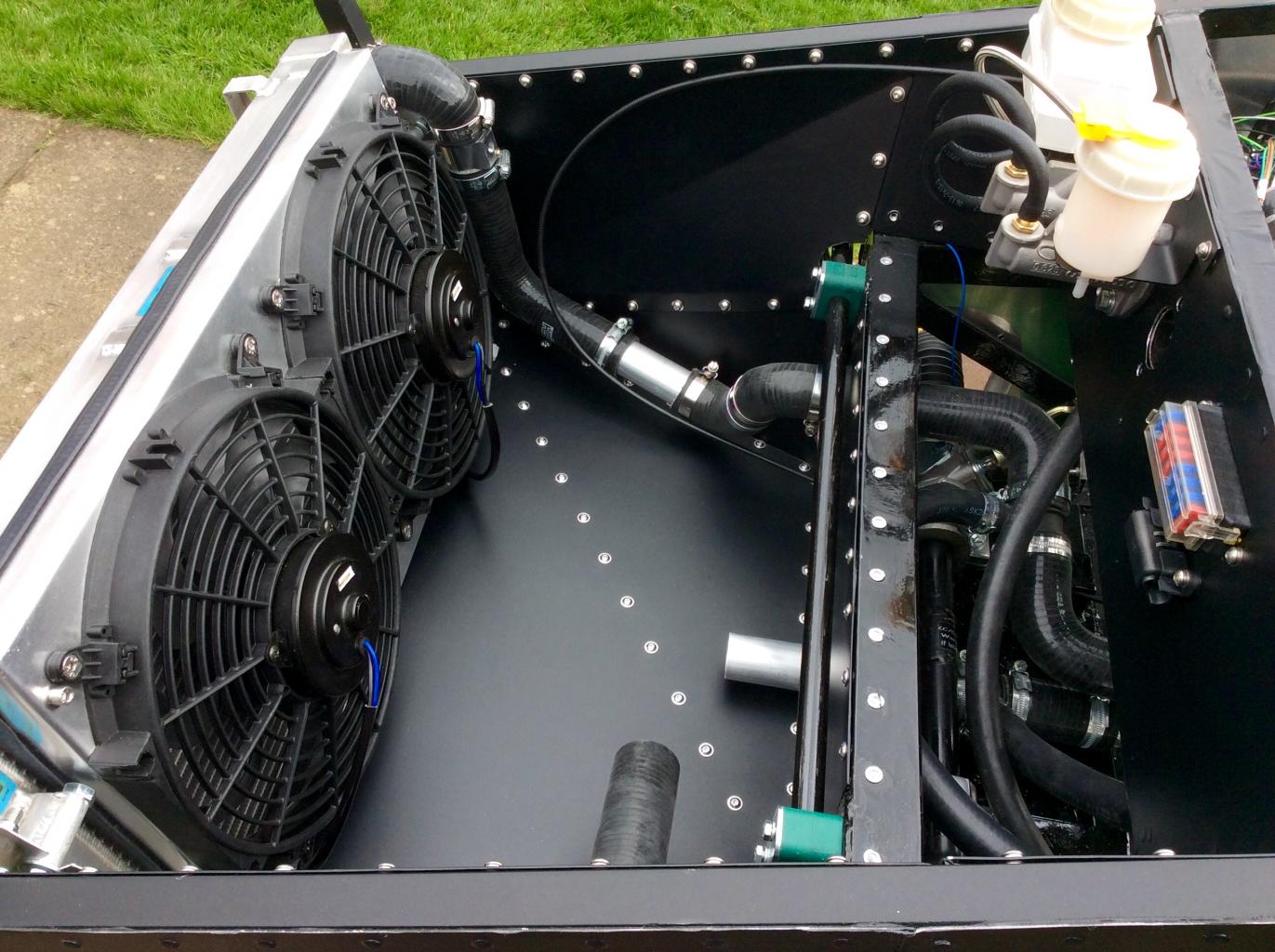

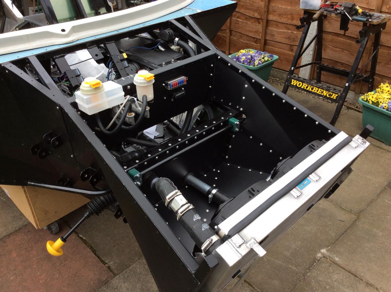

Some changes to be made before the body is fitted.

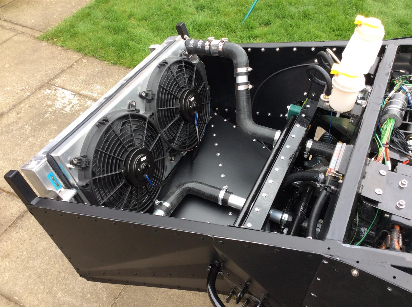

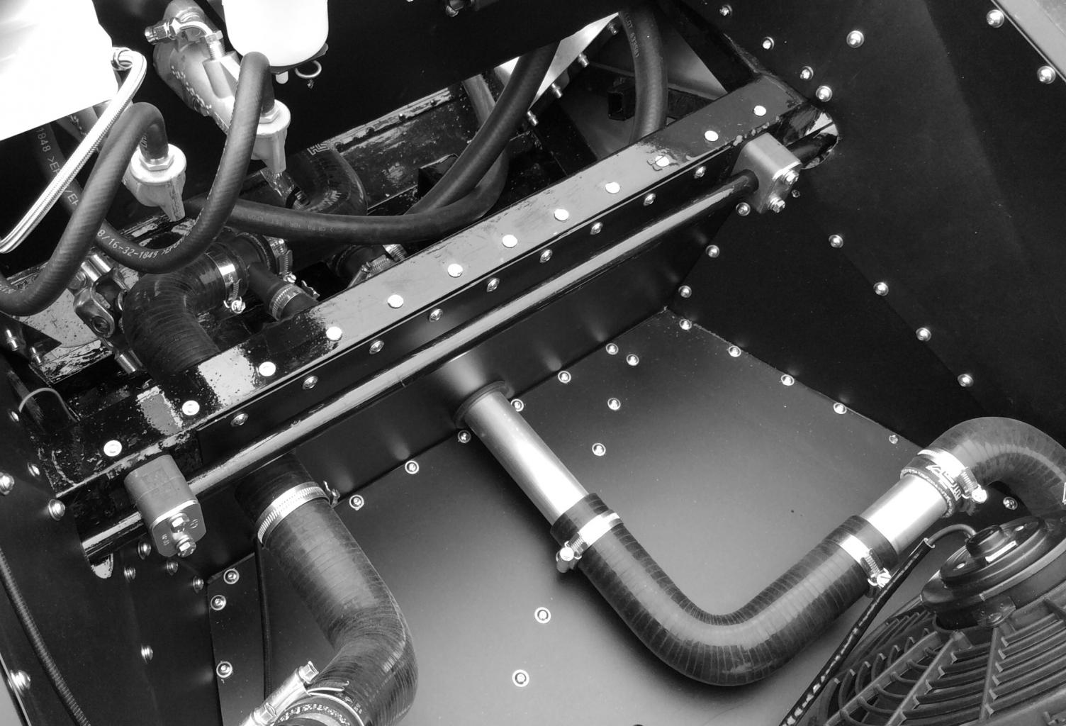

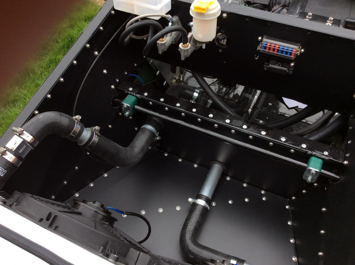

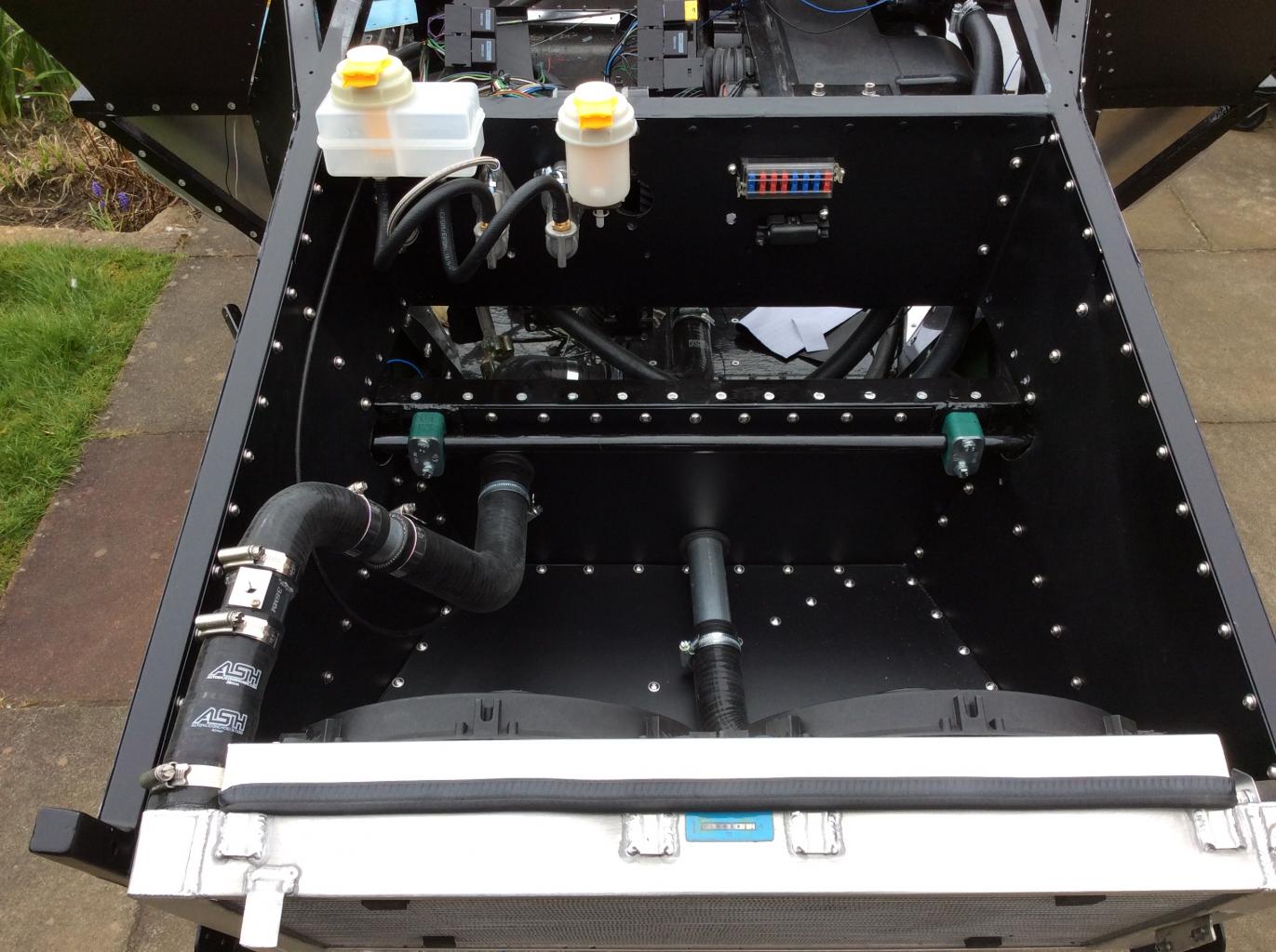

Hi Bob,
Look like:
- Reservoirs mounted too high ?
- Radiator mounted upside down (looks like the drain at the n/s top)?
Great build, keep up the good work
Rgds
Andy
Hi Andy. Thanks for that. Yes the brake reservoir has to come down slightly. I haven't cut the bracket down yet. It will end up the same height as the clutch cylinder which is ok. Well spotted!
The radiator is, I think, ok apart from the "top" hose. Most 40 radiators dont have a top hose but Bob Jones bought one that has! Anyway Lee Dawson pointed out that there's no way I can fit the nostril panel with the hose the way I fitted it. Bloody obvious (now it's been pointed out)! Easy sorted just a bit embarrassing.
Ok, I think I've got it now.
Hoses should miss the nostril panel and I've lowered the fluid reservoir.
Thanks :thumbsup:

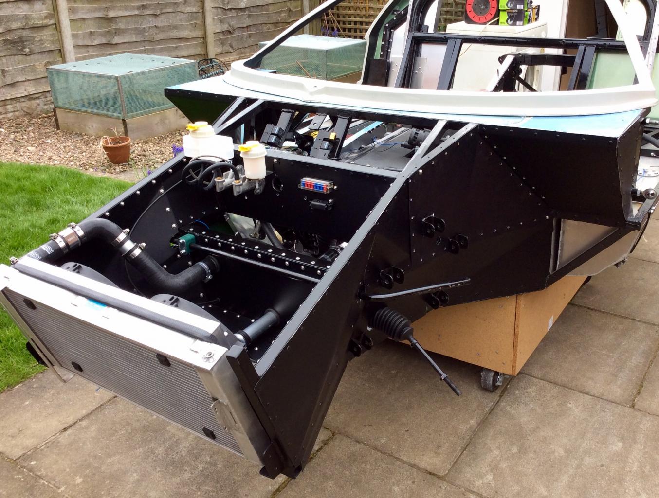

Thanks Daniel.
Well that didn't take long I'm busted!
It's vinyl wrap.
It'll protect the panels while I build and if I need to I can just strip it off, paint, polish or wrap again.
Bought some off eBay and it worked fine.
The finish I chose was plain carbon fibre.
There are loads of finishes out there including patterned carbon fibre and chrome!
It's all over YouTube. Here's one example.

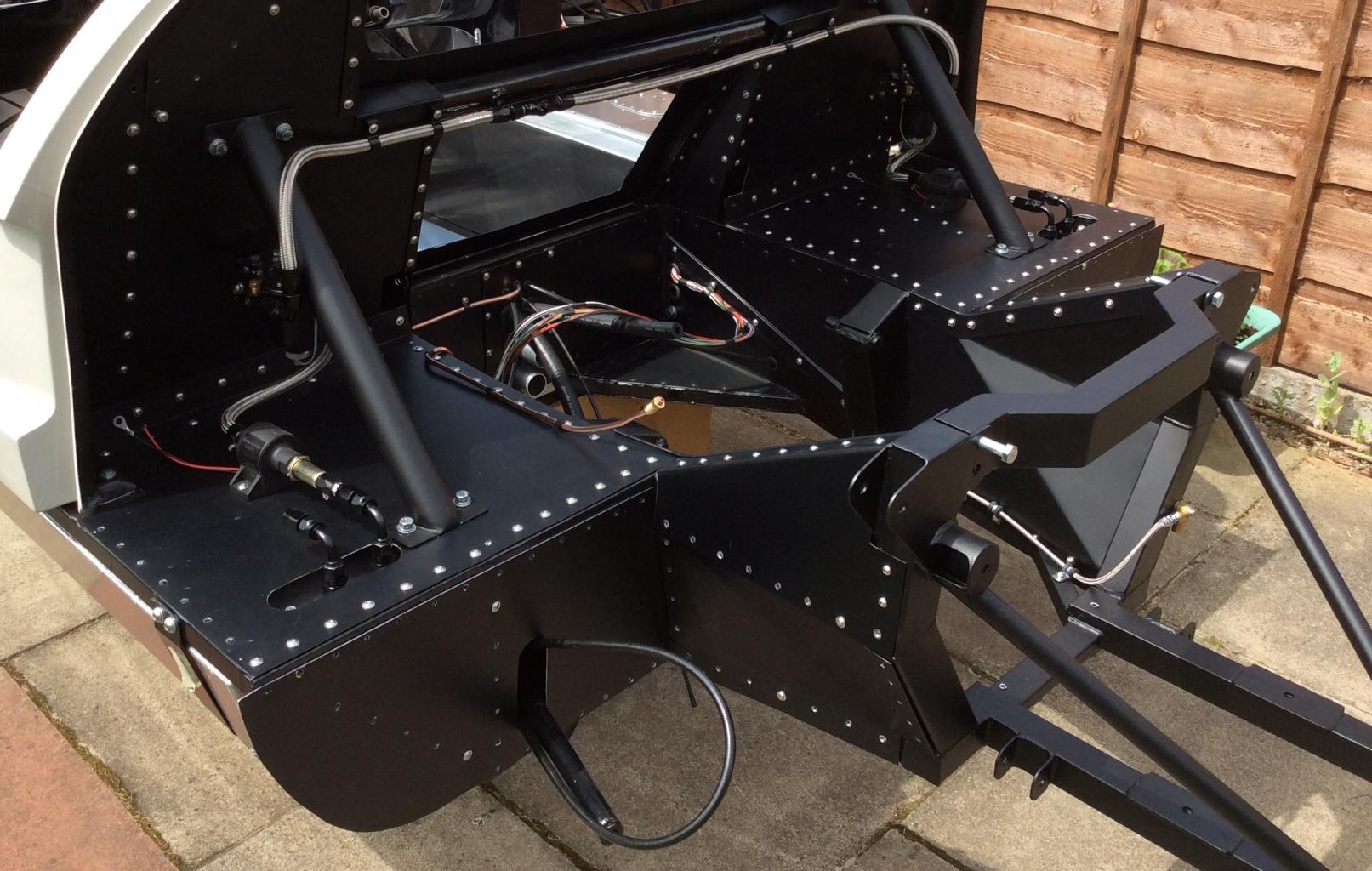

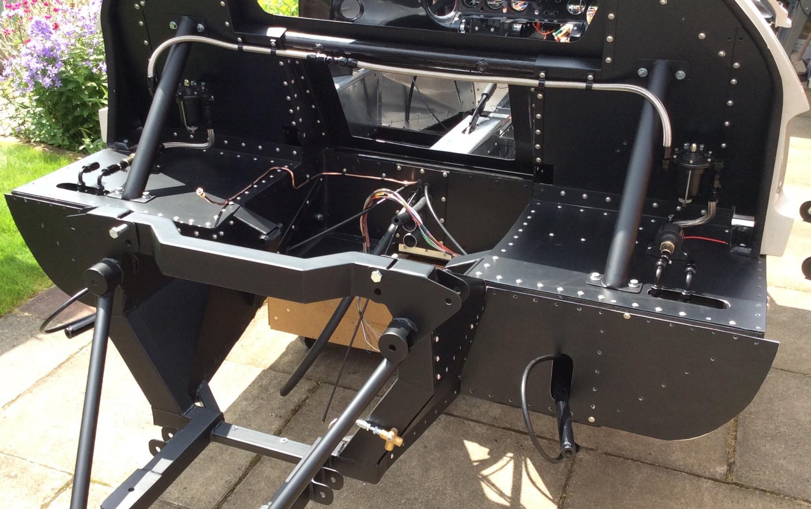

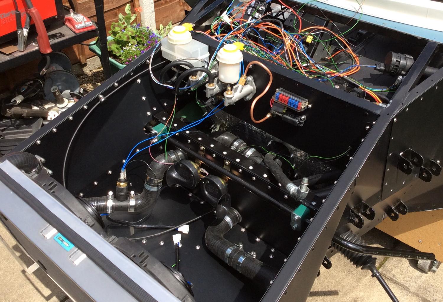

Fitted the fuel pumps and been doing a bit of wiring.

Looking good.
How thick a metal are the rear suspension mount points? Compared to my DAX they look thin.
Do doubt more knowledgeable people on here will confirm if they are beefy enough.
Bob
Looking good.
They are 3mm Ian. Your right compared to a lot of others they do look thin but then again, compared to some earlier cars, so is the chassis box section. I "think" they are the same as Tornado. I'm more concerned that I didn't allow for castor when I welded them on. Perhaps an area for some"development"!

Took the picture of the wiring like that because I knew I wouldn't be doing any more for a few days.
