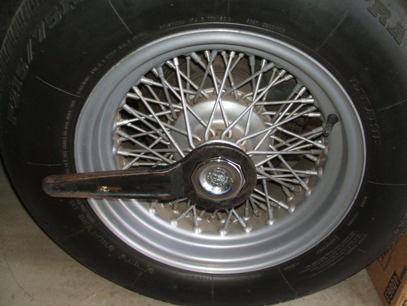

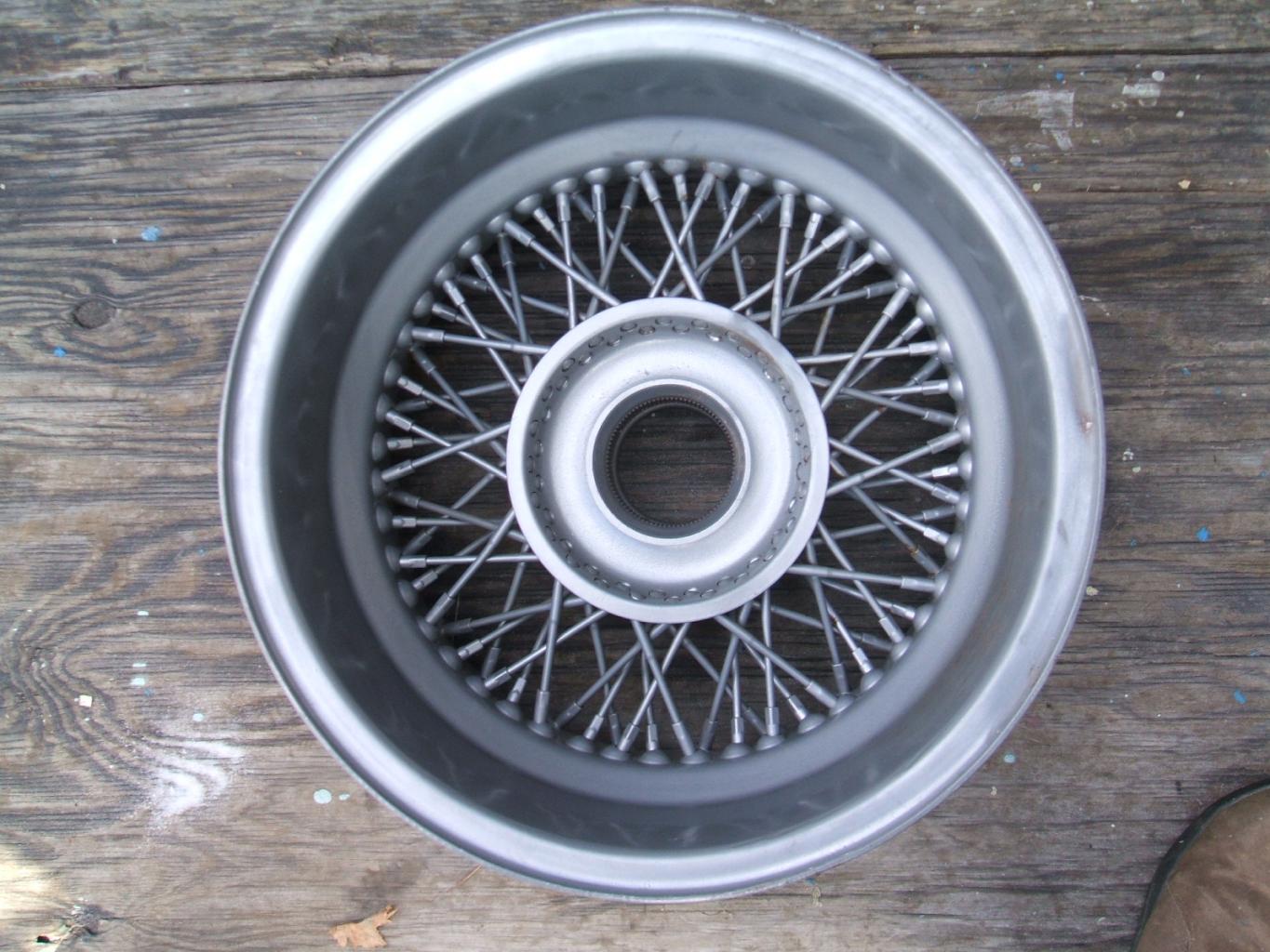

Alas, I don't have a GT40 (one of my dream cars) but I do have a 1963 Avanti R2 (supercharged) with a set of 5 Borrani wires that may be from the early GT40/ Cobra era. The fellow I got the car from said he thought they were from an AC Cobra, which is feasible as the 5 lug spline adapters are the same bolt pattern shared by Ford and Avanti.

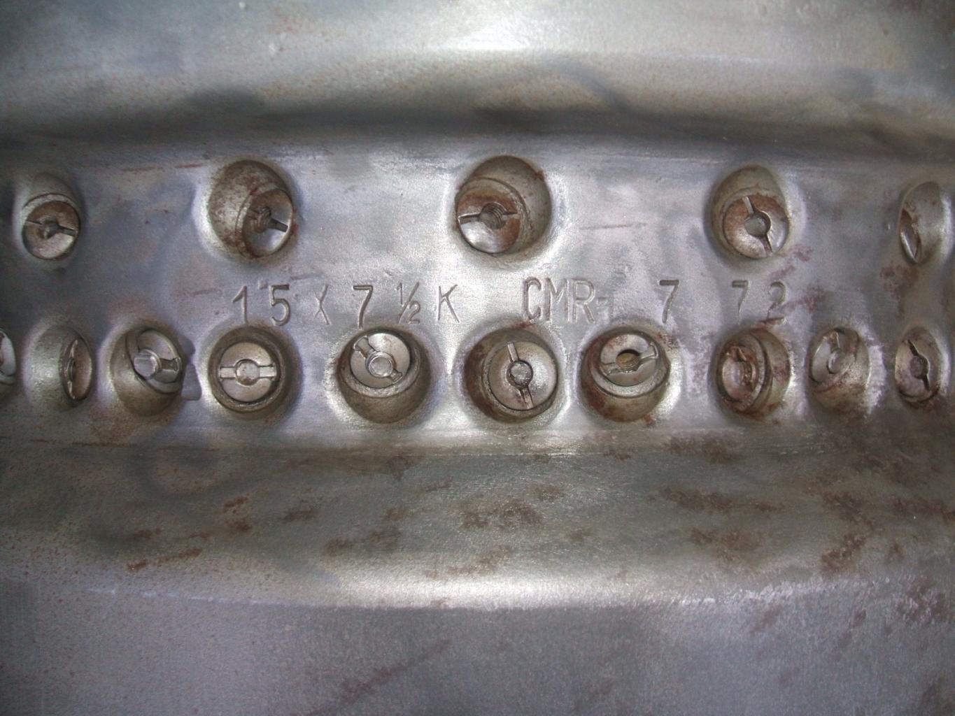

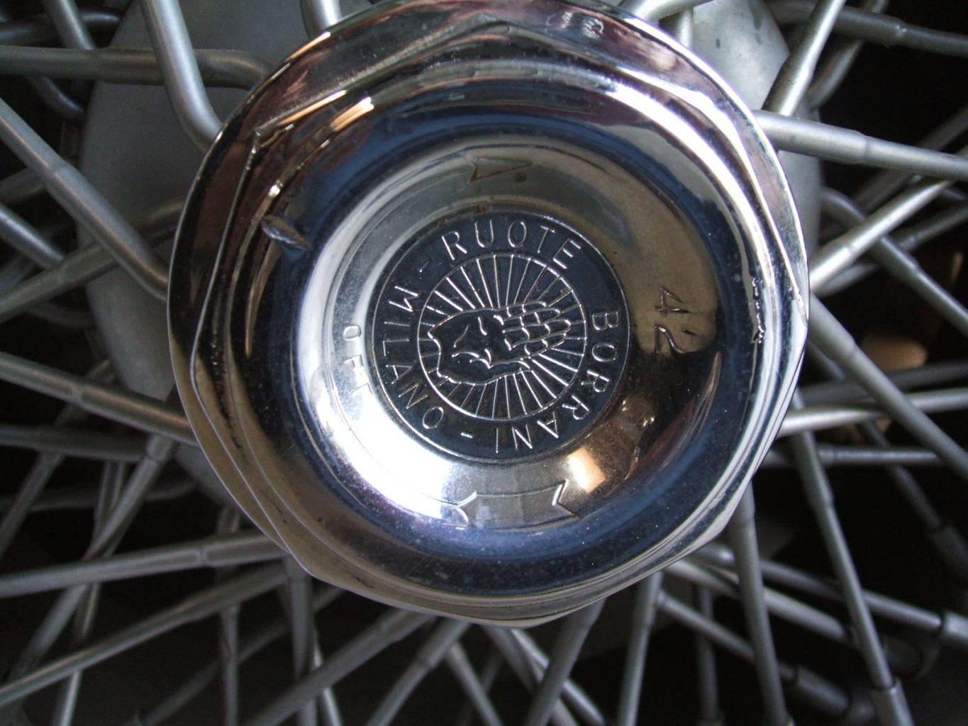

The markings on the eight-sided knock-offs read "Route Borrani Milano 42" and an "off arrow" indicating thread direction. The one unmounted spare is stamped inside “ 15 x 7½ K CMR 7 72”. They were steel (not stainless or chrome) painted silver when I got the car, I have since powder coated the 4 on the car.
Any help identifying the age or original application would be appreciated.

GT40s and Cobras use 15 x 6.5 and 15 x 8 and are all 6 pin knock offs not 5 pin and these were made in July of 1972
Thanks for the information. I thought perhaps the "72" referred to 72 spokes. I'm not familiar with the term "pin"..is that the same as the wheel mounting studs?

No. Knock-off wheels are attached to the car with a single nut (normally a two- or three-eared spinner), but the spinner's function is just to hold the wheel onto the hub. The actual transmission of torque between the wheel and hub (either for acceleration or braking) is handled in either one of two ways--splines, or pins.
Wire-wheel cars (including Cobras and GT40s, no?) have splined hubs, which engage splines in the center of the wheel.
Mag-wheel cars have five or six large-diameter pins which engage holes machined in the back face of the wheel.
Quite a few GT40s (and Cobras) which originally carried Borranis were later fitted with Halibrand or BRM magnesium wheels. It's my belief that originally they had only spline-drive hubs, but that later they were retrofitted with pin-drive to accommodate the wheels. I don't believe that they had pins from the start--true, or no? Does anybody know?

I contacted Borrani America and learned that Borrani did indeed manufacture wire wheels for the Avanti (though I suspect one of the later models of the Avanti II and not Studebaker) as well as the Excalibur, which was originally based on Studebaker chassis and driveline components. Also learned that CMR is the parent company of Borrani. Here is an interesting link to Borrani history:

John, those look like borranis that you might find on a mid/late 60's ferrari or maserati. Something like a maserati mexico or a ferrari 275. I think the early daytonas had wire wheels so perhaps that's a possibility with the 1972 date stamp. They don't look like the borranis you might find on a jag or aston to me. Not sure if this is of any help.
Thanks for the input Cliff. They do look more like something from an Italian car and @ 7.5" the rim is too wide for a Jag or Aston. I have an E Jag that has 5.5" wires that are not triple laced like the Borranis. Some E Jag owners go with the Aston wheels (6 or 6.5 with a wider offset I think) for a wider stance. The series I Jags actually had the same front track width as the old Mini Coopers!
