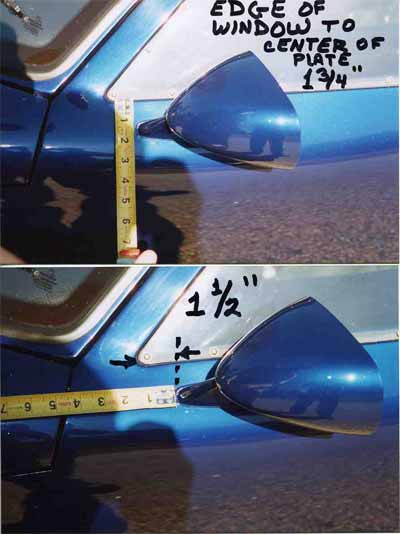

A lot of us are using '85 to '87 Mazda RX-7 electric mirrors. They look great and are period correct and work very well. In this picture they look like they are drooping, but they really are not. You need to sand the plate that goes against the door to make the top of the mirrors be paralell to the pavement. This is the position I installed them. They are available in most braker yards. I also used the control switch from the Mazda. /ubbthreads/images/graemlins/smile.gif

Control switch at 8 o'clock just outside of the steering wheel.

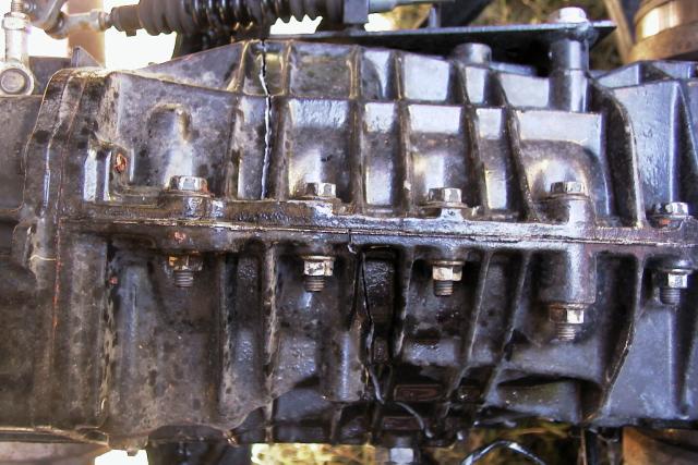

If you have broken a 'DB/Quaife' set please let us know more - When Daves R42 had a standard diff failure (Pre ATB) at Wiscombe a couple of years ago (2001) - a pin supporting one of the planet gears broke, exited the diff centre and tried to pass between the main crown and pinion. This all happened at about 70Mph+ whilst hard on the gas, travelling up through 'The Esses' and with wide slicks on, the resulting BANG burst the gearbox casing dumping a slick for about 50yards up the hill (very popular as I was next up!). On inspection, all DB parts remained undamaged despite shock load. See pic below.

Just to add to Paul's post above, the DB shaft is a one peice shaft whereas the standard Renault item is two shafts joined by a sleeve. Only on one occaision that I am aware of has anyone tried to weld the two renault shafts together and that ended in failure!
