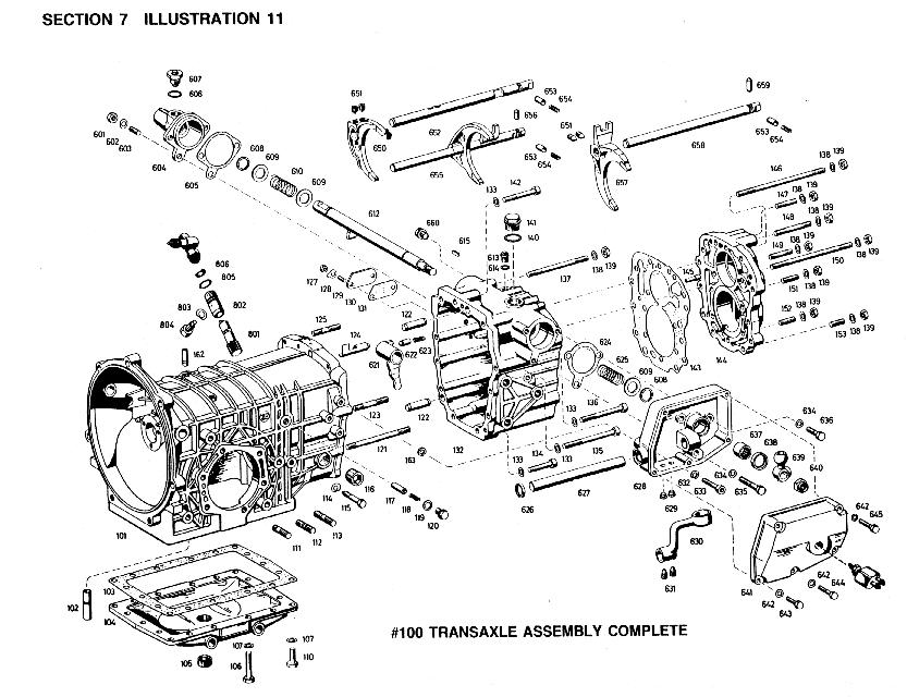

I'm sure I can come up with something through trial and error...but, as far as I know, there isnt a provision for a switch somewhere built-in the the ZF, correct?
Has anyone fabbed up a mechanical bracket that worked? (preferably mounted on the trany)

There should be a connection for the reverse light on your ZF on the shift translator box on the side.
It goes to ground in reverse.
Good luck
Phil
Phil,
I hope you're right. I'm going to go out and look as soon as the Giants get done laying the wood to the Marlins.
