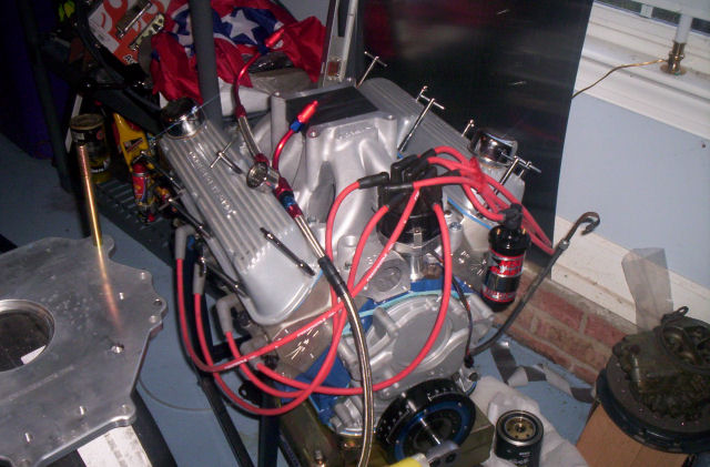

Got my camera back and here are a few pictures of garage happenings. I'm buttoning up the motor with a new front over that I got from John B of all people in a nice transaction. Going mechanical pump so the new style cover, reverse rotation pump, and damper are all for sale. Funnelweb intake installed, billet MSD, expoy coil, etc - engine specs elsewhere.
The RCR adapter is a cool piece that is more than a transaxle/engine adapter, it also functions as a motor plate. Those long bolt tie into the chassis, and, there are two holes up top of that plate that tie into the chassis. Definitely will prevent pitch movement of the combination, as well as rotation around the crank axis. Made of aluminum for lightness and is still strong.

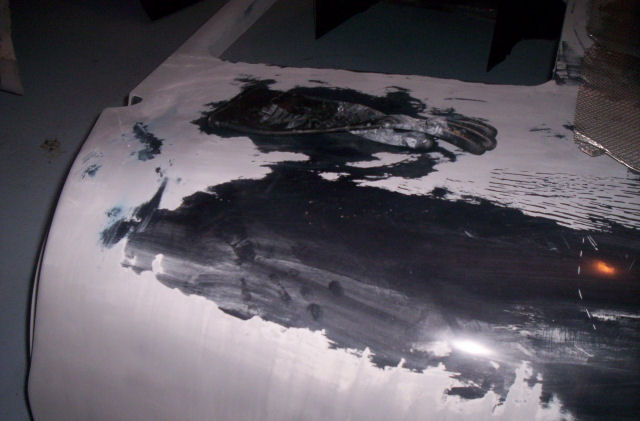

Tranny is located in my under house storage and is awaiting the dang Kennedy flywheel to finish all that up. Some more pictures too - the last remaining primer to remove - don't EVER spray your body with spray bomb primer! All the other parts are cleaned and cut for holes - brake ducts, lights, rear cut outs, etc. Still need to do sanding and shaping, but that is coming along.

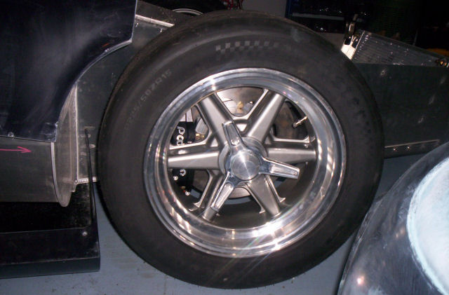

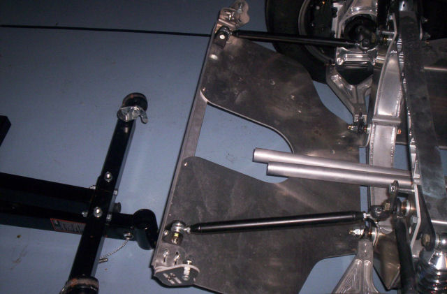

Fran managed to fit the car with a rear tray which is cool, that was not planned but worked out. The rear tray holds the clip and is adjustable with those drag bars and heim joints. I imagine we can make some sort of under tray diffuser out of it if we've a mind too. Front 15" BRM from RCR shod with Hoosier DOT race tire and 6 pot caliper there too.

It's looking good Ron, sorry to say this but I laughed when I saw the primer pic, an old saying came to mind "look before you leap" that must have been a crap job removing the primer, it goes on nice and easy but a bugger to remove.
Steve
No joke on looking before you leap - that was a crappy job. About 3 hours to put it all on well, and, about 12 to get it off. The adapter plate/motor plate idea used is a good one and is one of the best I've seen for engine/transaxle location and mounting, as well as the rear tray. Those silly valve cover tees have to go though!

Ron Earp said:
...Those silly valve cover tees have to go though!
I have a draw full of them, at the time I thought they were a good idea but after bumping them and getting tangled up in everything and always loosening up they are now scrap. Mine were nice Ford Blue :D :D

The tires are 275-50-15s rear, and 255-50-15s front. I'd use 225s on the front next time around, 255s are not needed. They are Hoosier DOT road race tires and are completely unsuitable for any rain at all - even a drop. But, for track work you won't find a better tire short of a slick. I'll get the number out of them and post.

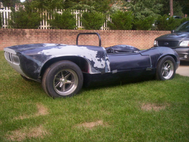

Here is a picture of the Lola re-assembled. I had to put it back together to fit the TR8 in the garage in preparation for the Daytona race next weekend.

That is the last and will go quickly, but it really was a PITA to do the entire car. Lola's are small, that is short, but they seem wide and long - every bit as big as my Jensen Healey and seems a tiny bit larger than a 40, but hard to say. I think the really flat and wide rear deck with no features give you the impression of size.
There is a little bit I left on the back too, but I still have those two holes to cut out and it is on the place being cut out - so not cleaning that off!
