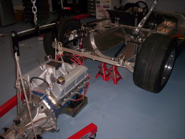

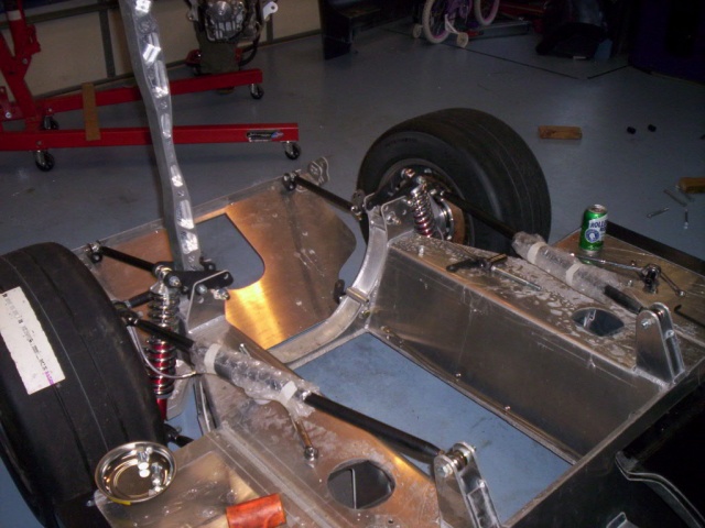

Engine Trial Fitment
Got a fair amount done today. Motor mounts on, engine trussed up, bearings tight, rear brakes bolted up for real, bolts replaced with grade 8 in engine/tranny, and some other things finished up. Big thing was the first trial fitment of the motor. Notice slaves working in background. ;)

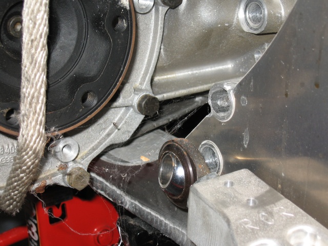

The motor didn't fit exactly as I'd planned though. Initial trials indicate that the rear pan/panel will have to be modified to fit the 016 into the frame. The 016 "hangs low" and will need a fairly large cutout in the rear panel. Another thing that is faily clear is that the 016 itself will have to be pruned down. The webbing underneth the gear box is going to foul on the bottom of the rear horseshoe. I thought we could pull the engine/transmission forward enough to avoid this, but, that is impossible.
The half-shafts from the transmission to the rear uprights pretty much defines where the engine and transmission have to be. If pretty much in line with each other the front webbing of the 016, right in front of the round section for the differential and LSD, will have to be cut out. How much I'm not sure but will mock up and measure accurated tomorrow, as well and take good photos. I would rather not cut out anything from the transaxle, but, I definitely don't want to cut anything from the frame.
One could try and space the engine and transmission up in the chassis, but, that isn't a good idea. Besides, the RCR adapter plate also acts as a motor plate and is bolted to the chassis via two huge bolts. So, they dictate how low the whole assembly has to be, I'll get some more info tomorrow, maybe it won't take much modification. We made only a trial fitment today and didn't have a lot of time to tweak and think about it.
Other than that it appears that it will slide in nicely and has enough room. It'll be close on the firewall area but looks like it'll fit well. So, we're making some progress!

Looking Good Ron,
we were taking a flyer on the undertray for the Lola.....at your request...winkwink
The RCR chassis was designed around the G50 or ZF package and the 016 was always the redheaded stepchild......
Keep the pics coming ......

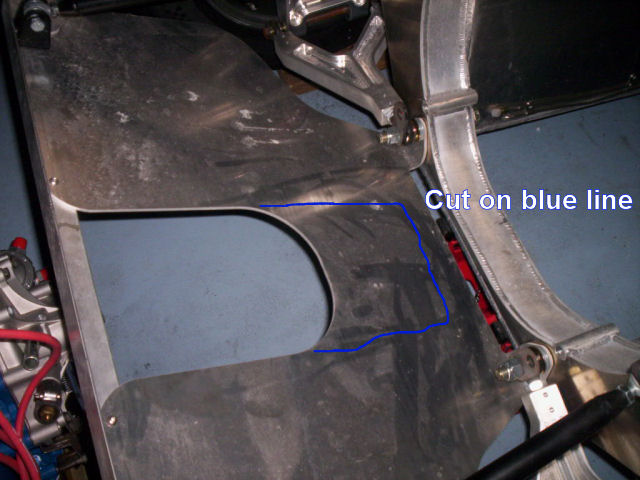

Hey, no worries on the fittment of pieces - that rear tray idea was last minute thing on my side and I appreciate you and RCR taking a guess at it. We are extremely pleased with the car and chassis and don't feel there is anything out there better for our purposes - track car with some street duty as we're building it.
All it needs for modification is about, I think, a 7" deeper cut and then for me to lay a 3/16" piece of ally across to strengthen where I cut. I'll get some pictures up. I'm pretty happy with it and think it'll be in tomorrow.
Once that is in place I think it'll fit with little drama. The engine/transmission sits much lower in relationship to the chassis than say an RF car that I fitted up before. As such, my oil pan *might* be 1/2-3/4" lower than the chassis bottom, but I'm not sure yet. I don't mind though, I'm quite pleased that it won't be high and won't have the engine tilted forward as the RF SB Ford/016 installation did. A new pan can fix it if it needs fixing.
The 016 is pretty small and compact, but where it is not compact is input shaft centerline to bottom of transaxle. This transaxle was clearly designed with an engine that had a crank up high in a block, or an engine that was going to sit high in a chassis. It's okay though, and she'll get in there before long.
Other things are coming along too. We're plotted out pedal positions, reservoir locations, and I've got the wiring harness all over the play room cutting out wires I don't need. Power Antenna. No. AC. No. Heater. No. Oil sender. No. Temp sender. No. Alternator field. No. No. No. No. The beauty of mechanical gauges and a race car setup.
These pictures will probably describe what I'm talking about so folks don't think I'm opening a chop shop here, really not a huge deal. Much thanks to both Jeffs for helping out today!

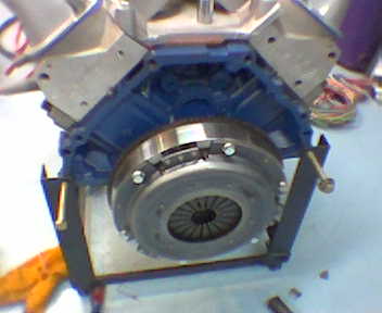

And, here is a shameful picture of how NOT to bolt up your flywheel and pressure plate. What is missing in this picture?

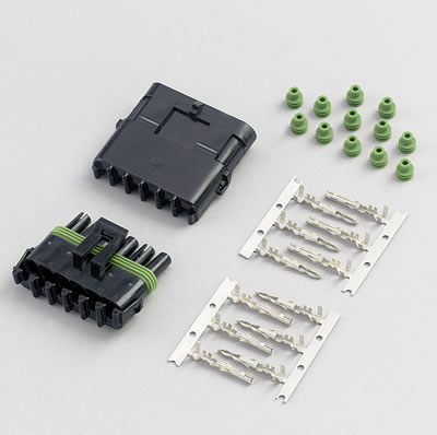

That looks like what I wanted to do with Mike's RCR 40. I still haven't been able to find the connectors you mentioned. If you find the connectors, would you post them?
Summitt has these in 6 pin, might have to use two of them to get done. Look under weather proof connectors. I have some nine pin in the garage just like these that are arranged in a square so I know they exist. Thought I got them from Summitt, but I can't remember.

Those are Packard Weather Pak Connectors. They are a very good connector. You can get them and some other that are good for automotive from Waytek Wire, you might have some minimums on some items, but it is usually enough to have some spares. Pretty good prices as well as other good stuff for doing automotive wiring jobs.
http://www.waytekwire.com/
If you do a lot of wiring it's worth it to get the specialized crimp that does both the seal and the wire in one shot. Otherwise care and a small pliers or crimp work ok.
Also I think Jegs has kits with a variety packs with a few different styles, terminals and seals.

Hi Ron, I used exactly the same connectors for front & rear clips - 2 x 4-way jobs for each clip. Bullet-proof, water-proof, & not too hard to separate & re-connect. (These connectors are also used extensively on post-84 Corvettes).
I went with 2 x 4-ways instead of a single big connector after seeing how hard the big ones under the dash are to separate - murder on the fingers !
To avoid confusion, I wired each end up with 1 x 4-way M=>F & the other one F=>M - now, even I can't stuff that up !
Re the terminations - I just crimped them on with long-nose pliers, then added a dab of solder on the bare-wire crimp area.

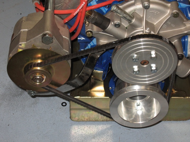

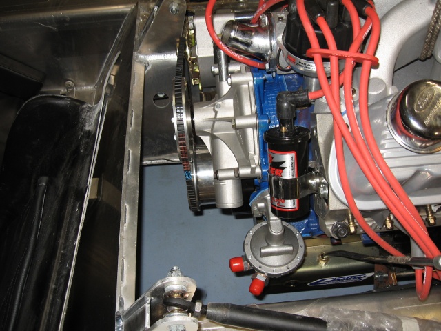

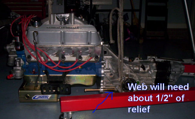

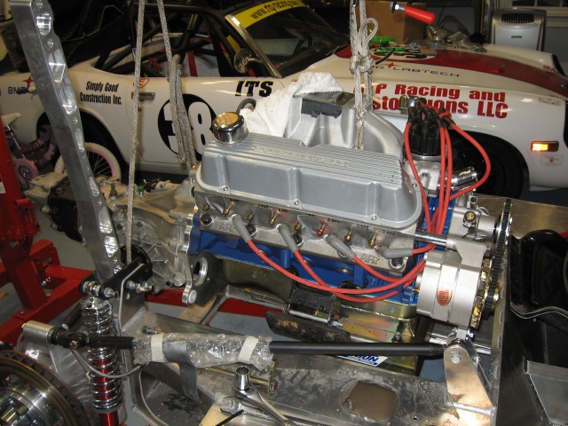

Well, it has been about two months since I've done anything on the Lola due to race car prep. But, the enduro is over and now I have time to focus on the Lola.

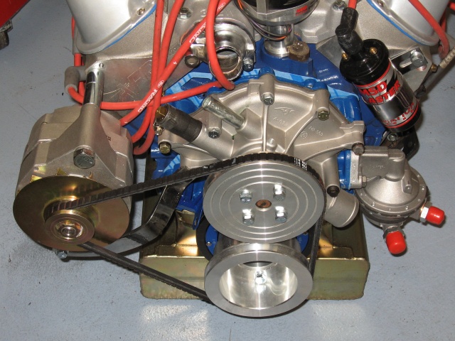

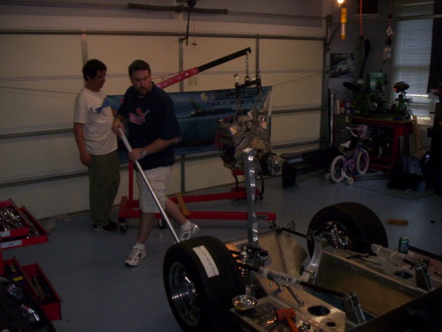

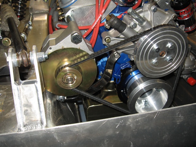

I've managed to clean the garage up, fabricate some brackets, mount up all the bits on the motor, and do a test fit of the engine. I'm pretty pleased!
The Ford engine and Audi transaxle sits a few inches lower in this chassis than it did in the Roaring Forties chassis and I like that aspect of it. My alternator is stuck too far out to the side of the motor so I'll need to fabricate another support bracket for it that brings it in closer. The alternator could be smaller for what we're doing here, but, I want to be safe if we run this in an enduro and we need to power an array of lights for nightime use.

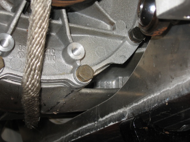

And, as you can see, I'll need to trim a bit of webbing off the bottom of the Audi transaxle to clear the chassis. Firewall clearance seems to be just fine from the front pictures with the exception of the alternator hung out there on the side.
I'm going to do some more careful measuring, some grinding on the box, and then get the holes drilled for mounting of the motor. I'll need to re-index the fuel pump so it doesn't point at the torque box wall there, but all in all it looks to be on track. Here are a few pictures.

Ron,
While you are remounting the alternator take the time to find a water pump pulley that shifts the belt back towards the motor so that the loads will be over the pump bearing. Your alt looks like it can go rearwards by approx 1.25" and you appear to have a spacer between damper & crank pulley that could be removed to facilitate this. While your at it fabricate a triangle bracket for the main top pivot bolt of the alt that picks up on two of the water pump bolts. A larger alt pulley or smaller(4" dia ) crank pulley would help as well. Do all of those things and it may last the 13 hr distance.
Jac Mac
Ron
Can you remove the right side thermostat housing bolt?
I had a problem...mine was too long and that water pump casting tab at 12:00 high would not allow it come out enough. Make sure you can get a wrench on it, and make sure you can get it all the way out. Otherwise cut off that tab.
