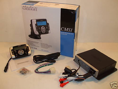

I have found this unit Clarion CMS1 source commander Marine stereo it will let you plug in any usb device, you can mount the head unit anywhere in the car and the controls panel is small enough to mount on the dash or console you can hook a rear view camera through it and it will hook up to a tablet or I phone for viewing. MP3 sirus etc...
and has a few differant choice's for control panel a square or Round.
